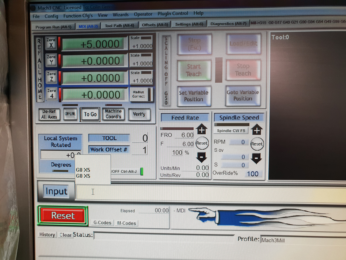

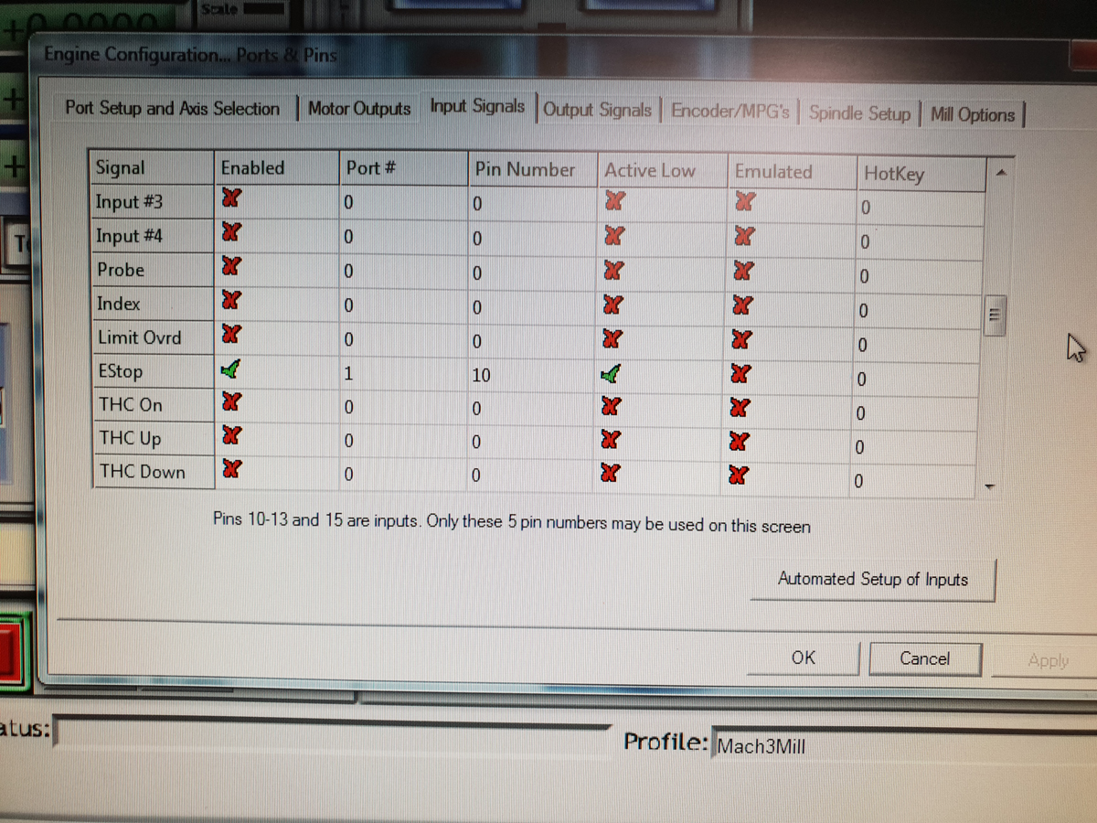

    Added 15v power to the relay side of the board as suggested. That's put the green LED in the corner diagonally opposite the relay ON.
    RESET switch is flashing and on the diagnostic screen the M1++ and M1-- reds are illuminated. Impossible to RESET so limit wire link removed, RESET stops flashing but still no output to the stepper motor.
    Should have pointed out I'm not using the 5v USB supply from the PC this is wired up to a separate regulated 5v PSU.
