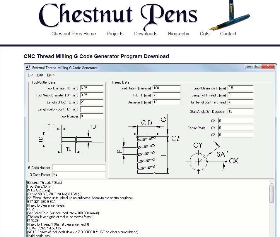

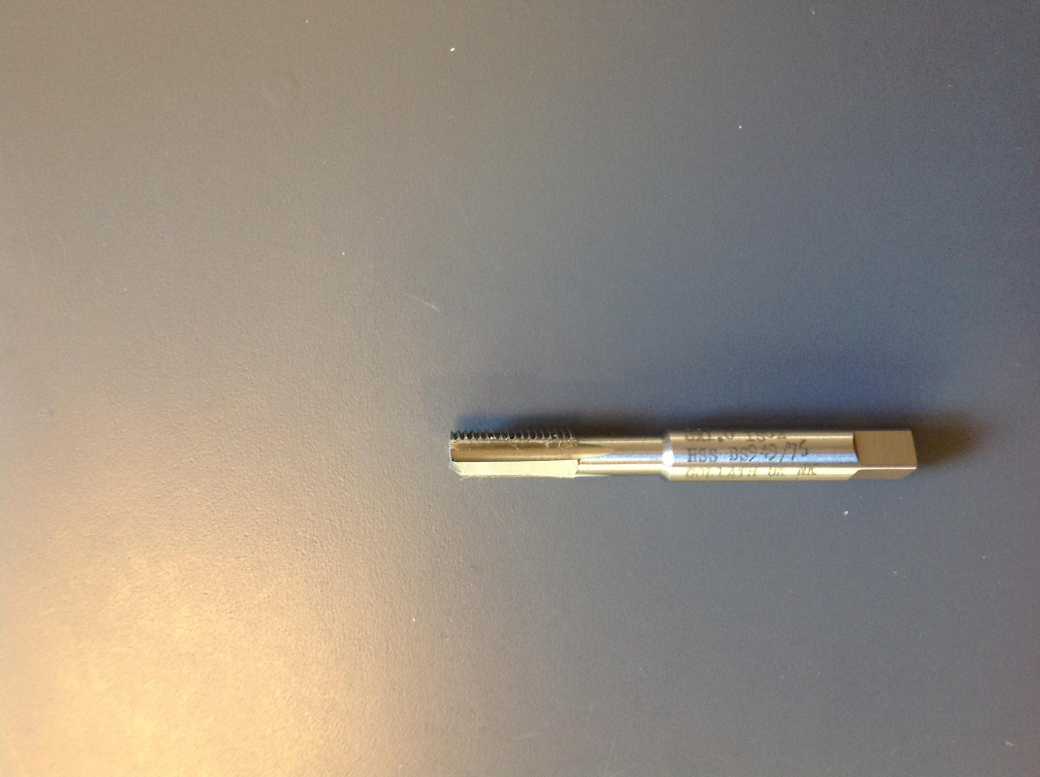

    Hi, I recently got into this and have used both a modified M8 bottom tap (all the teeth on 3 of 4 flutes ground off), and more recently a standard internal insert tip threading tool Experiences described over on the ME site at
    http://www.model-engineer.co.uk/foru...p?th=84198&p=6
    Look for the later postings in the thread for my contribution, though lots of useful info there. There's a poster there called richardandtracy who has posted a useful application on his website to generate the g-code which I used, works very well.

    Here's a photo of the tool with the number on the shank, hopefully you can get one from JB. If it would help I could post a photo of the modified tap but it's not very interesting, just an M8 tap with all the teeth ground off except one row. To find Richard's website to get the wizard look for Chestnut Pens.

    It would be interesting to see the tap. Here is the link :- http://www.chestnutpens.co.uk/misc/downloads.htmlClick image for larger version.

    I just started with a chunk of bms.
    Tap.
    If using a tap I think you have to mill down from the top. With a single point tool you can climb mill from the bottom of the hole.
