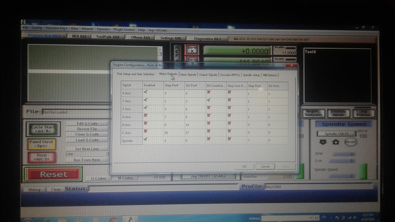

    I am putting together a 2*5 - meter Wood Cutting router using 750 w delta Servo Motors and ASDA B2 Drivers, The Controller is Mach3 (I am attaching the Picture of it). In this Controller the Y axis is called X therefore, my 2 motors for moving the Y axis is called X1, and X2 in this controller which is no problem so far, should mention that I do not need to slave X1 to X2 or Vice versa, because they actually rotate the Motors in Opposite direction, which is cool.

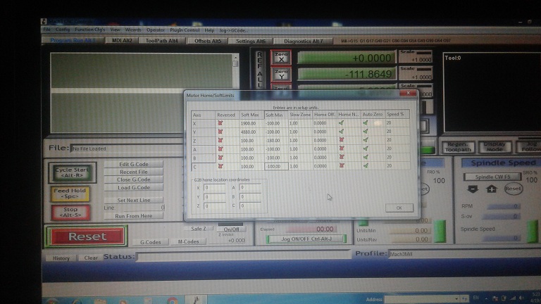

    Everything was working fine, and at my first trial I moved the Motors very smoothly and nicely. I started the referencing process, and everything referenced rather nicely, and I moved to calibration Process, and everything was going fine. But at the end of the day I noticed one of my long axis, Y (which is being powered or moved by two servo Motors X1, x2) motors is lagging slightly. I thought that I should Tight up My Gantry Screws and bolts, which I did the next day, but at a little later time when I tried to reference the Axis, I noticed that My Y axis is not referencing properly, and after moving a little it stops before it reaches my Inductive Home switch, and then it continues to reference my X axis.
    After Many Trial
    My Z axis Reference properly
    My Y Axis Stops before reaching my Home switch
    My X axis Reference Properly
    Should mention that My Y axis occasionally referenced properly, but at next trial It again stopped before reaching my Home switch, and at each Trial it traveled a different distance before stopping, and as I tried more it traveled less distance before stopping. And at some Trial one of my Y axis Motors Lagged rather drastically, and a little short circuit at X1 Motor connections happened, which caused me to turn off the Machine, and re wired that connection (My X1 Motor)

    Ok looks to be like your running 2 drives from one Motor Output.? This isn't good and could be the cause of your troubles. So I would sort this before looking further.

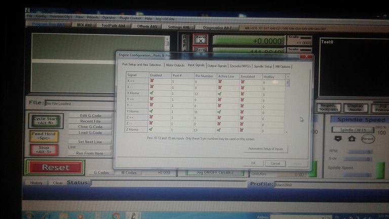

    Problem resolved, since I was using 2 different kind of Home Switch, apparently they created some kind of noise, that after adding some relay switches to my limit switch the problem is resolved and all is fine.

    I figured it out because you only have 3 Motor axis enabled. The fix is easy you need to connect one of the drives to another Motor Output and then use Slaved axis.
    I see your post about different Home switches but still the way you are running the machine from one Motor Output isn't correct and will cause you troubles at some point. The problem comes from pulse timing and over long jobs then any latency in timing will have an affect on position.
    The only exception to this is if the Servo drives provide a slaving option. In this case, you will have the slaved drive connected to the master drive via a cable so will be easy to tell.
    Also the way you have it setup now then your only homing to one Switch on one side. If there is any error between the motors/screws it will never be corrected and over time this will twist and rack your gantry.
    If you had it setup to use slaved axis then you could home each side to it's own switch and be sure the gantry is square. Also because your using servos you could use the Index pulse of the encoders to ensure accurate homing of each motor.
