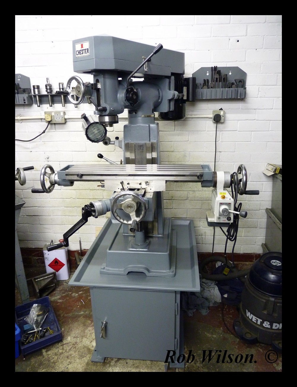

    Hi Lads, first post here goes!
    A few years ago I decided to convert a Chester 626 milling machine to CNC, actually about six years ago. The project was put on hold due to more pressing shop projects, so today I thought I may
    as well knock the dust off the machine and get back on and finish the project.
    The 626 mill.

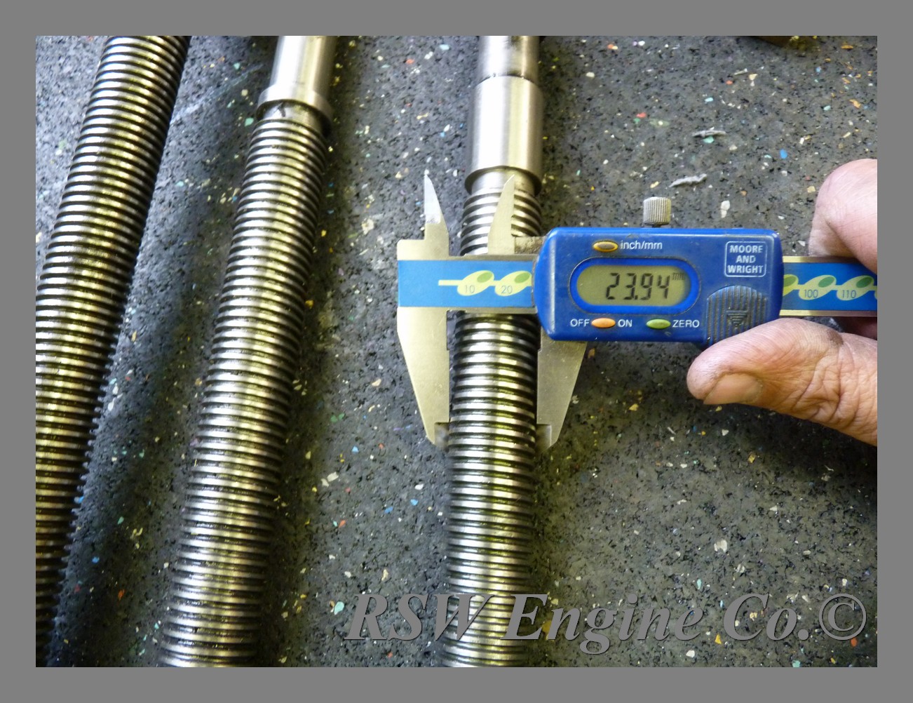

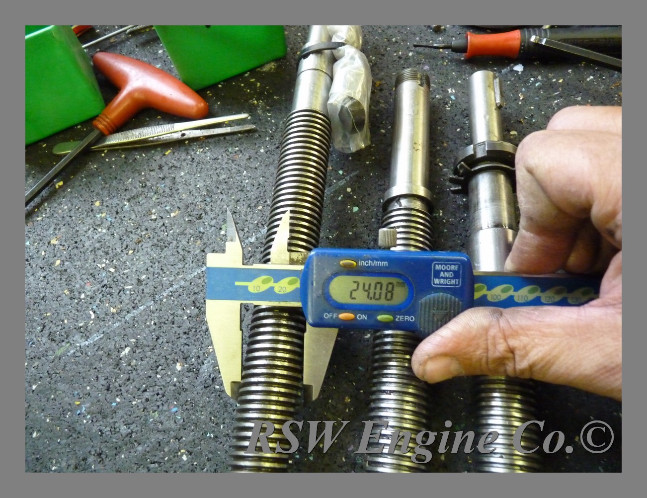

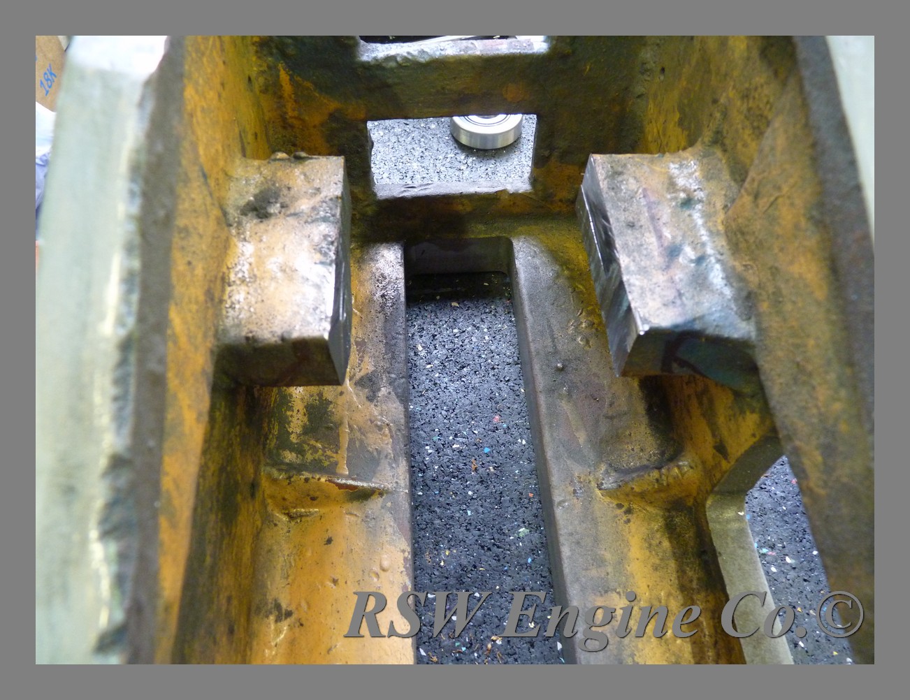

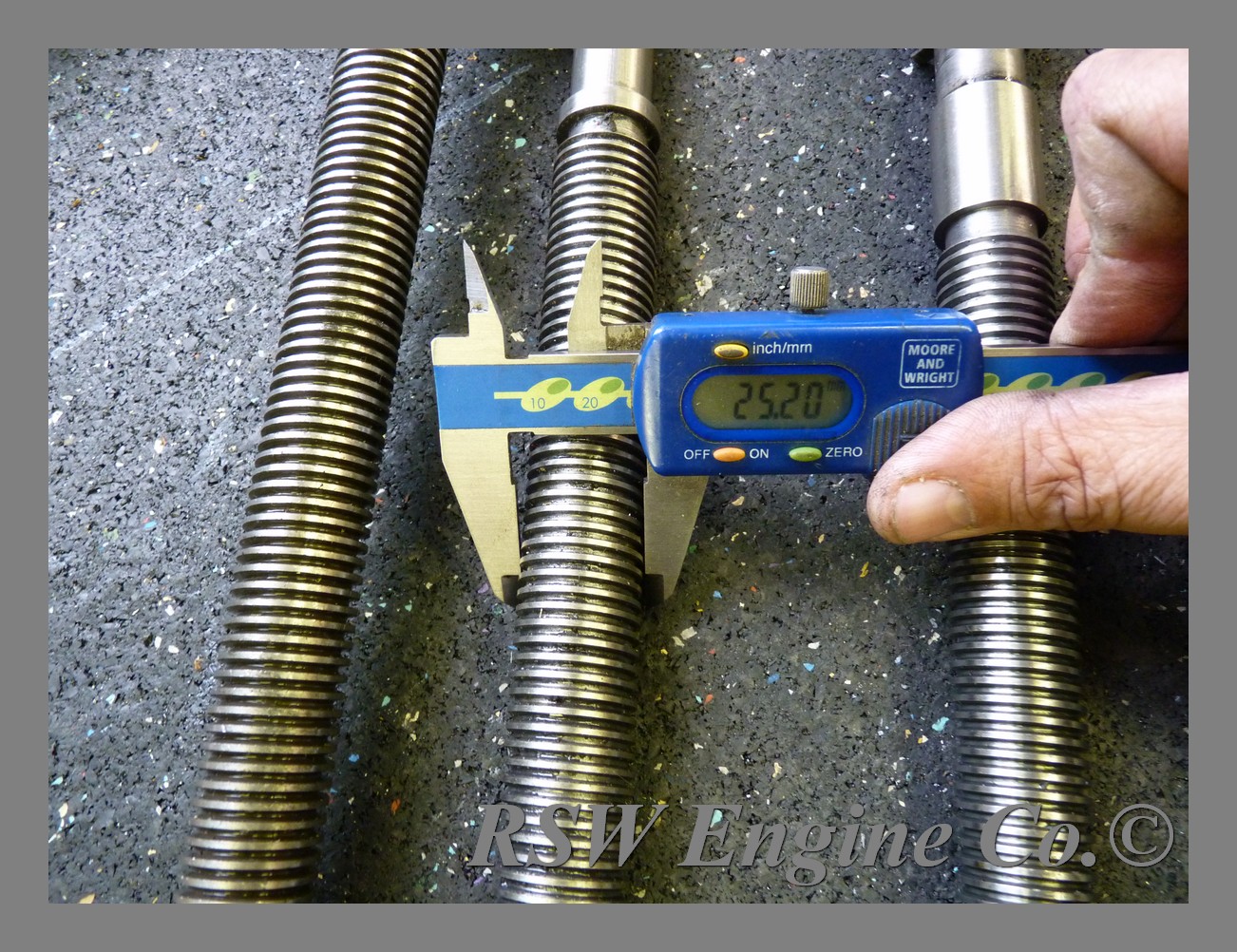

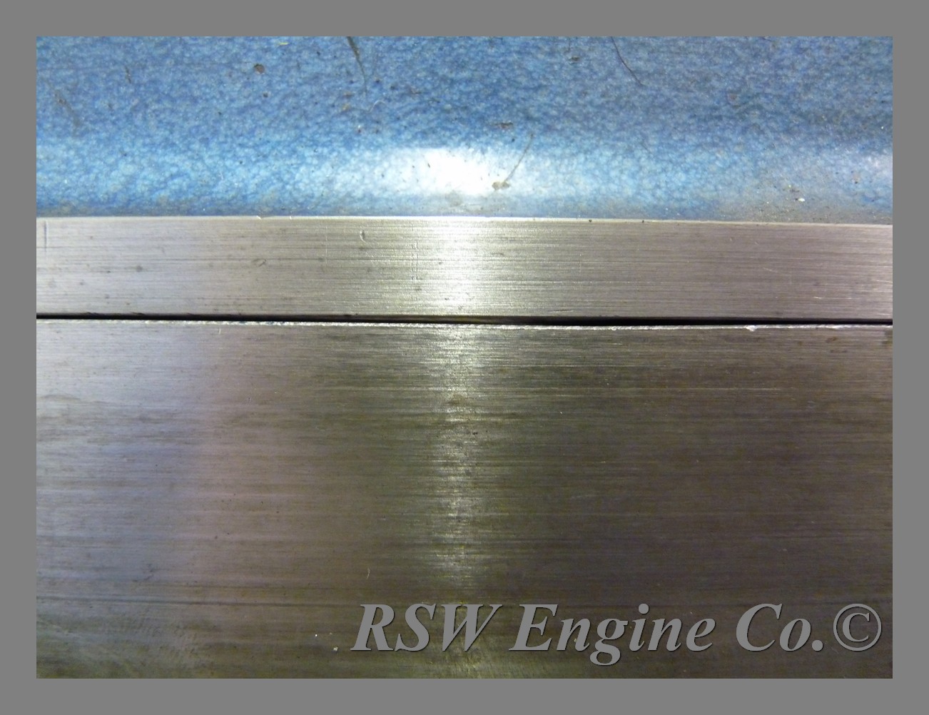

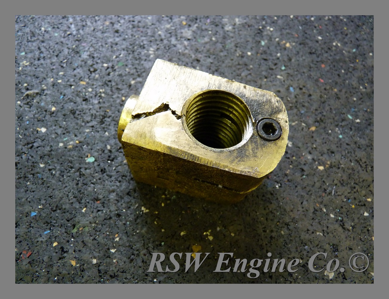

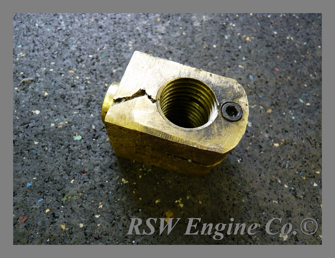

    The build quality of my 626 mill is shocking and converting it to CNC is the kindest thing for it lol.
    A few examples of the quality of this mill.

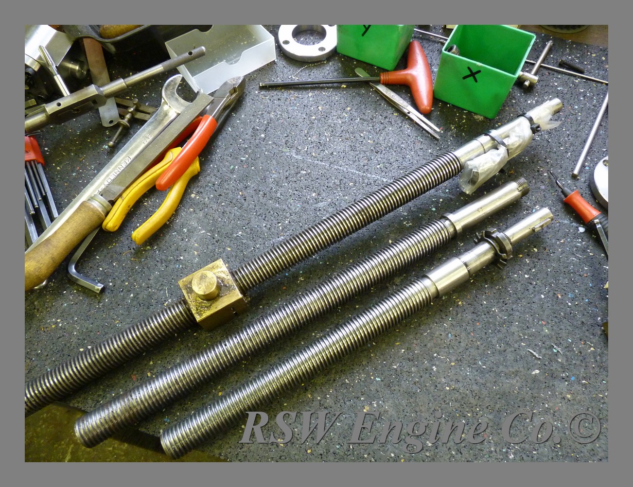

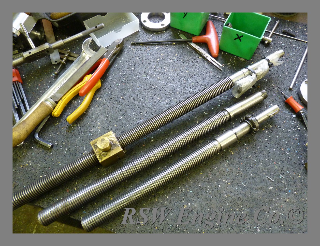

    Lead screws
ID:	24106Click image for larger version.
ID:	24107Click image for larger version.
ID:	24108Click image for larger version.

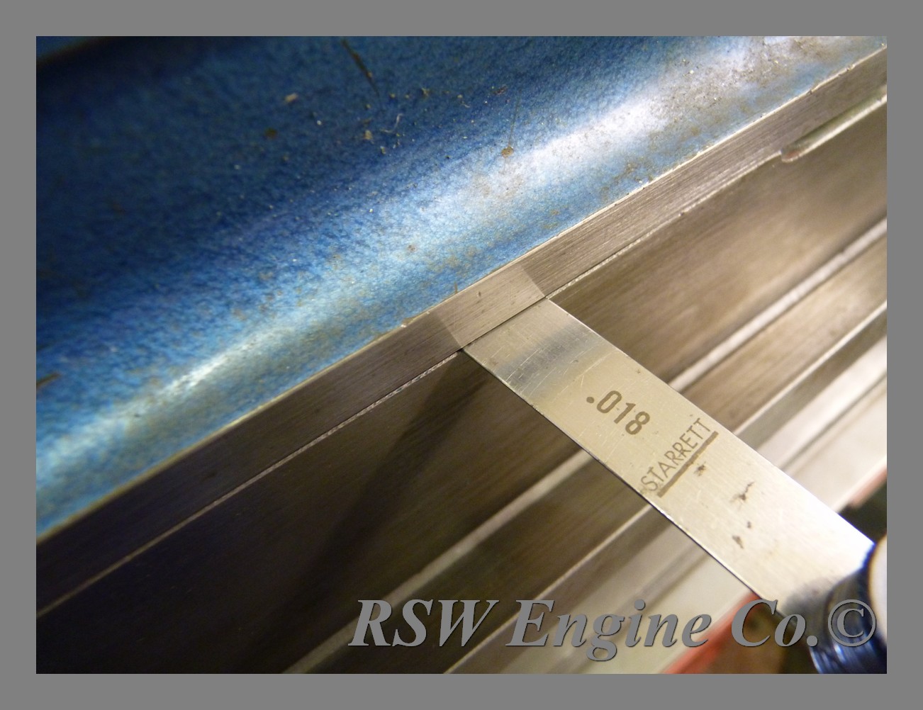

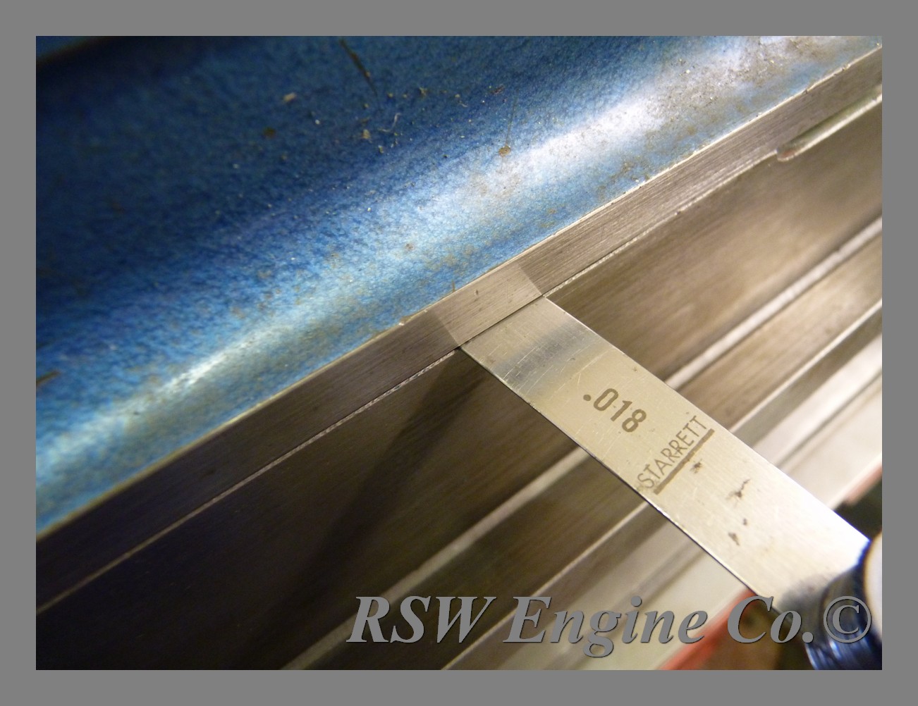

    Ways.
ID:	24110Click image for larger version.
ID:	24111Click image for larger version.
ID:	24112Click image for larger version.
    I could go on, but I will spare you. So this is my attempt to polish a turd so to speek
    Cheers Rob

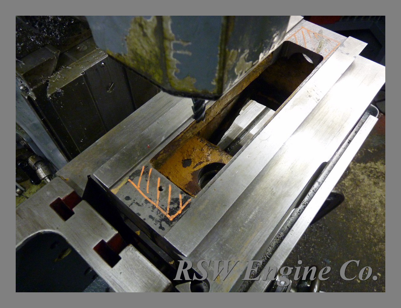

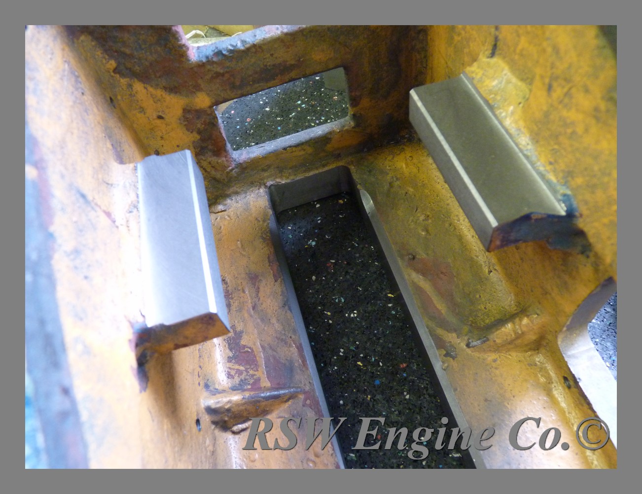

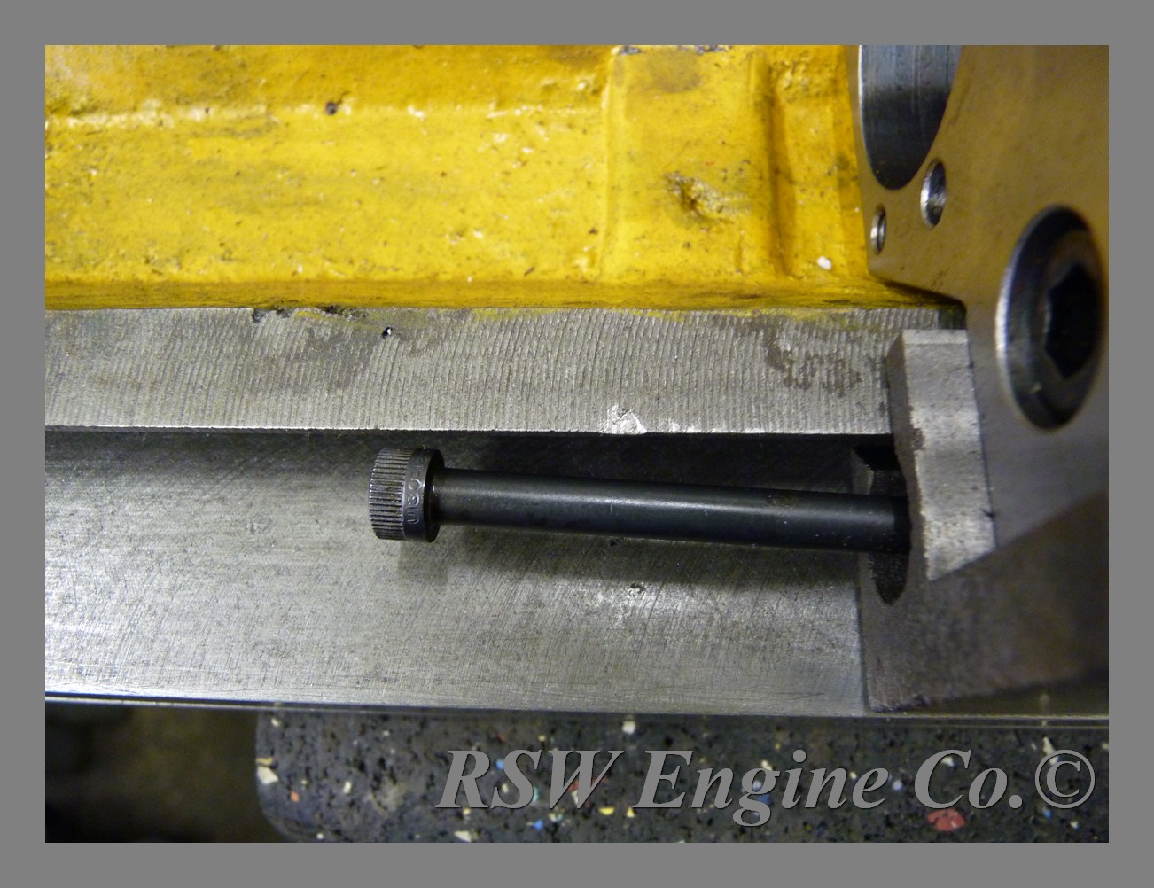

    Moving on,
ID:	24114   Click image for larger version.
ID:	24115   Click image for larger version.
ID:	24116   Click image for larger version.
ID:	24117   Click image for larger version.
ID:	24118   Click image for larger version.
ID:	24119   Click image for larger version.
ID:	24120   Click image for larger version.
ID:	24121   Click image for larger version.

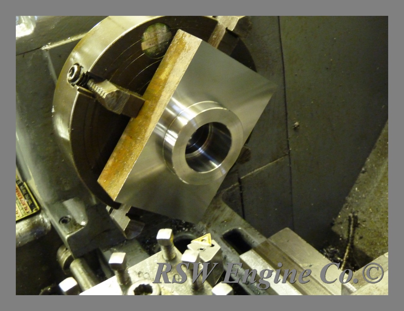

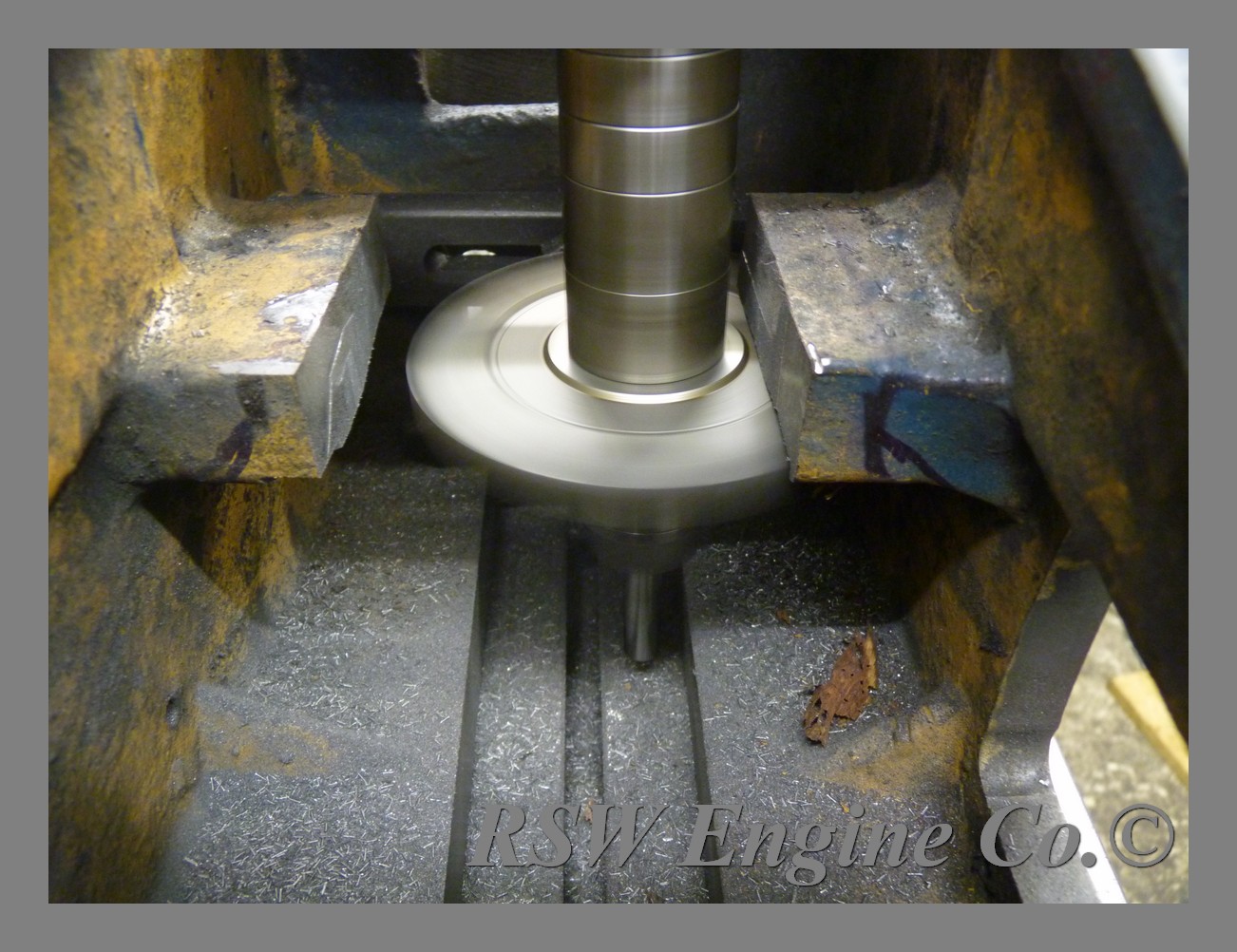

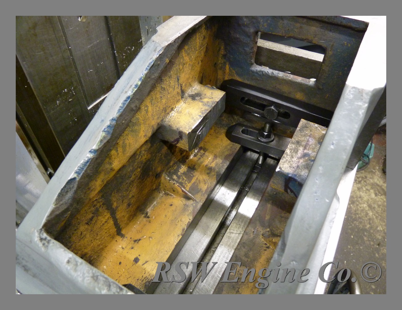

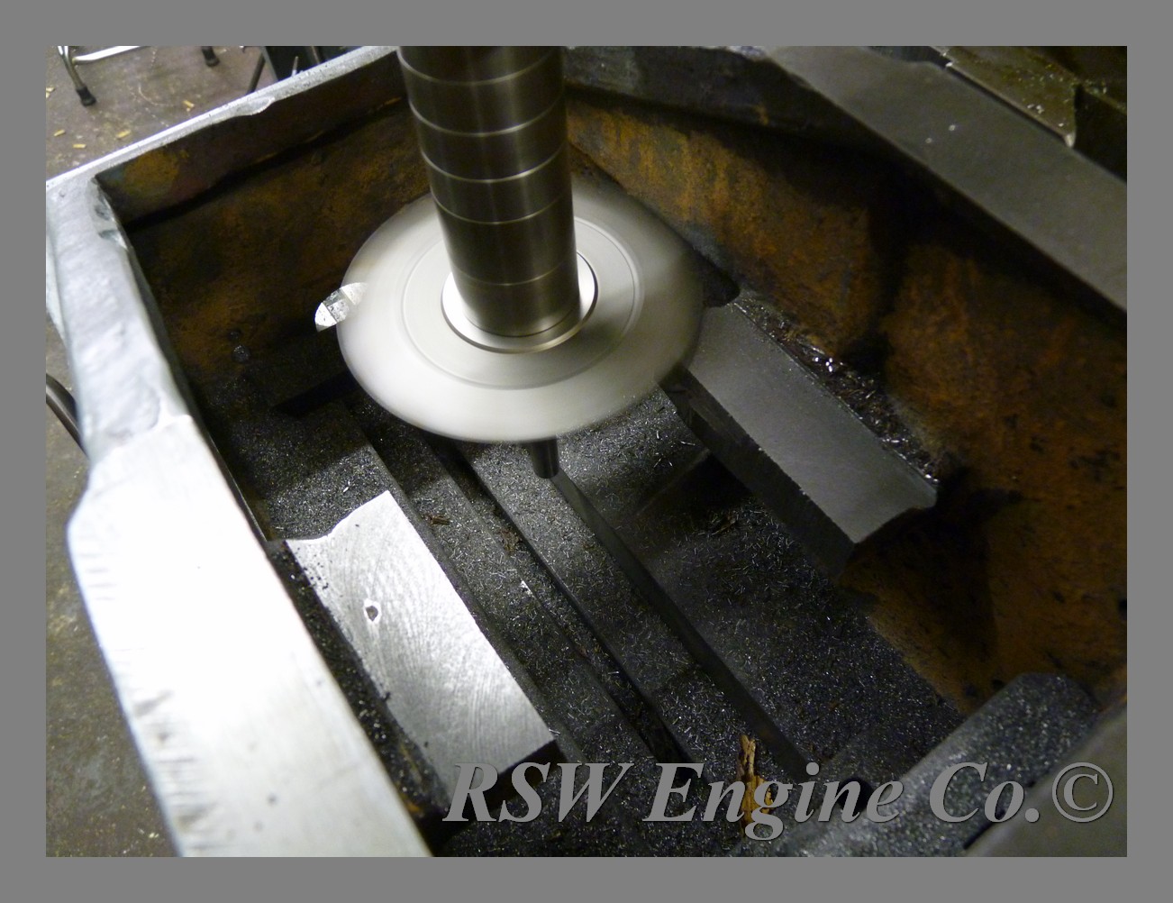

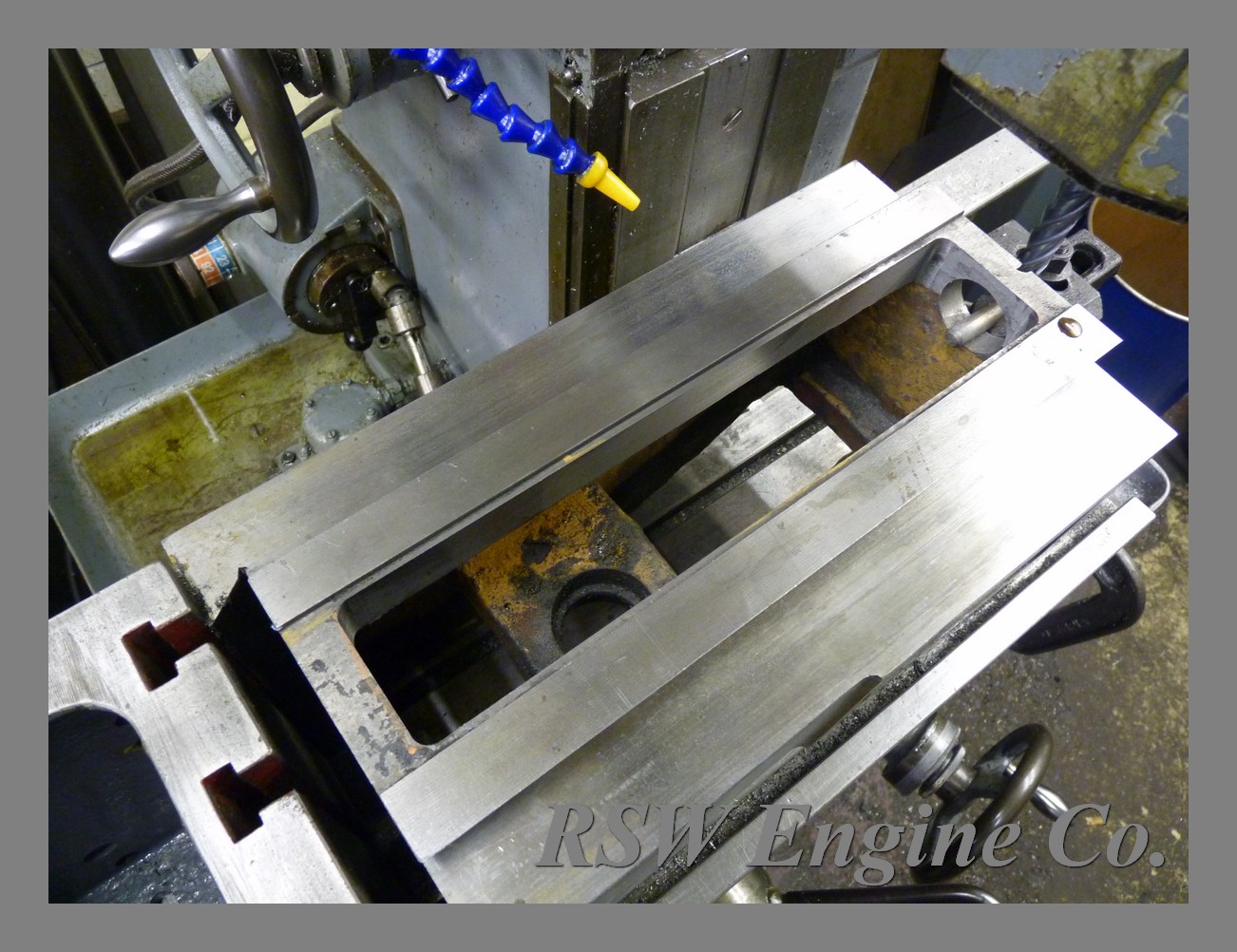

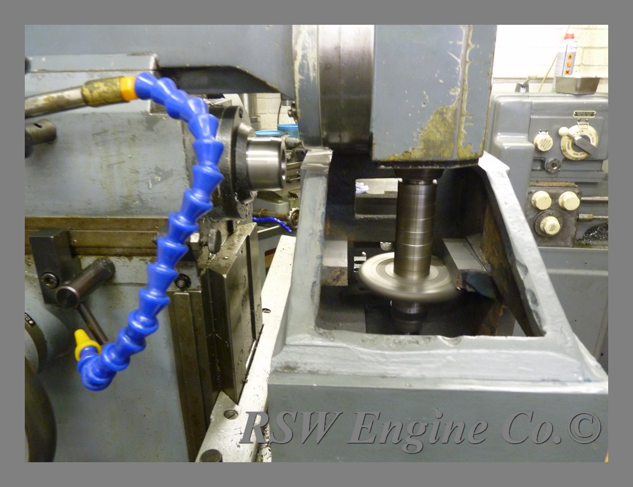

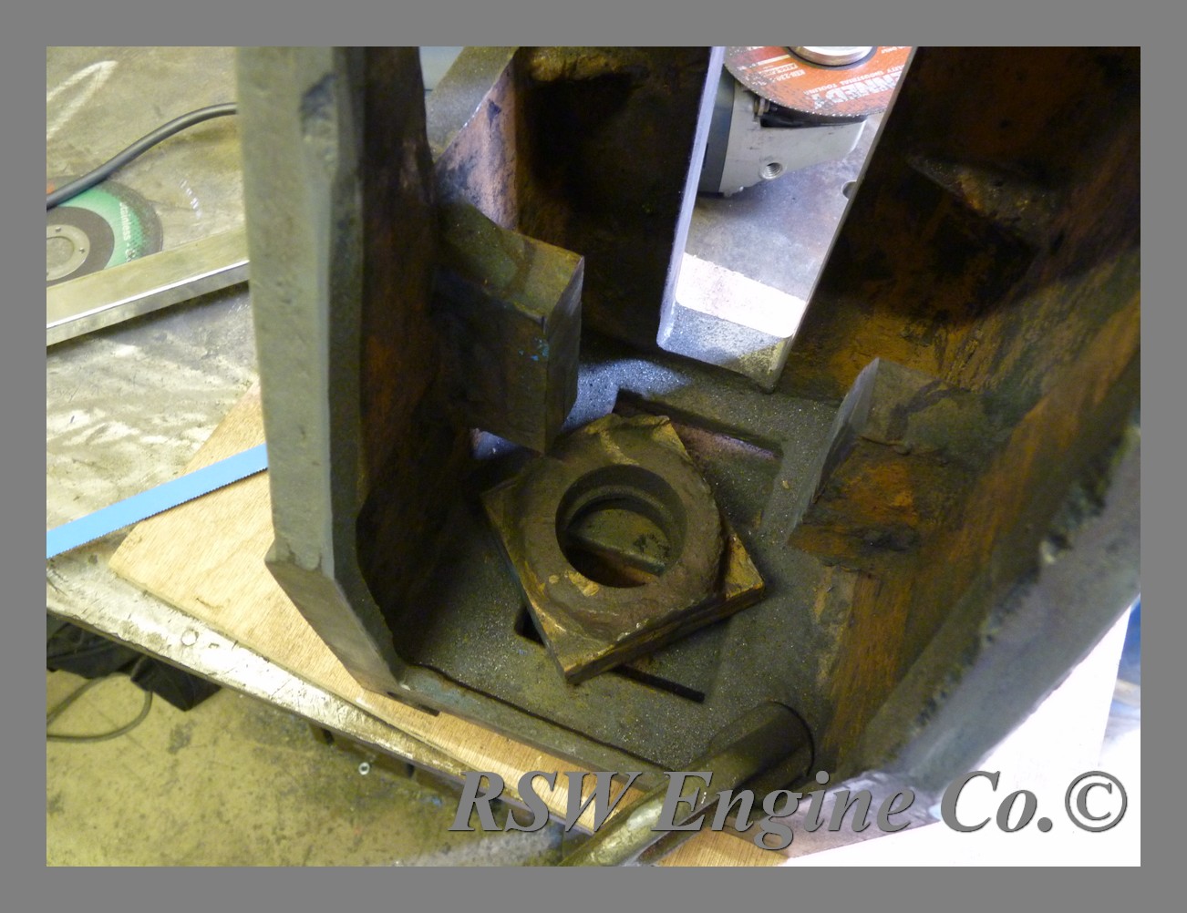

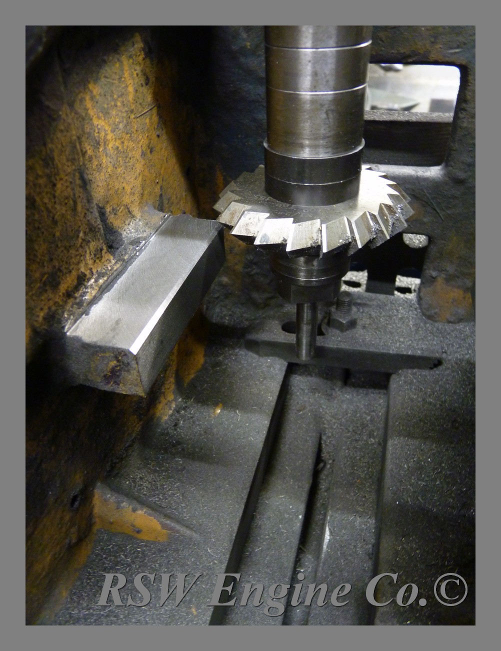

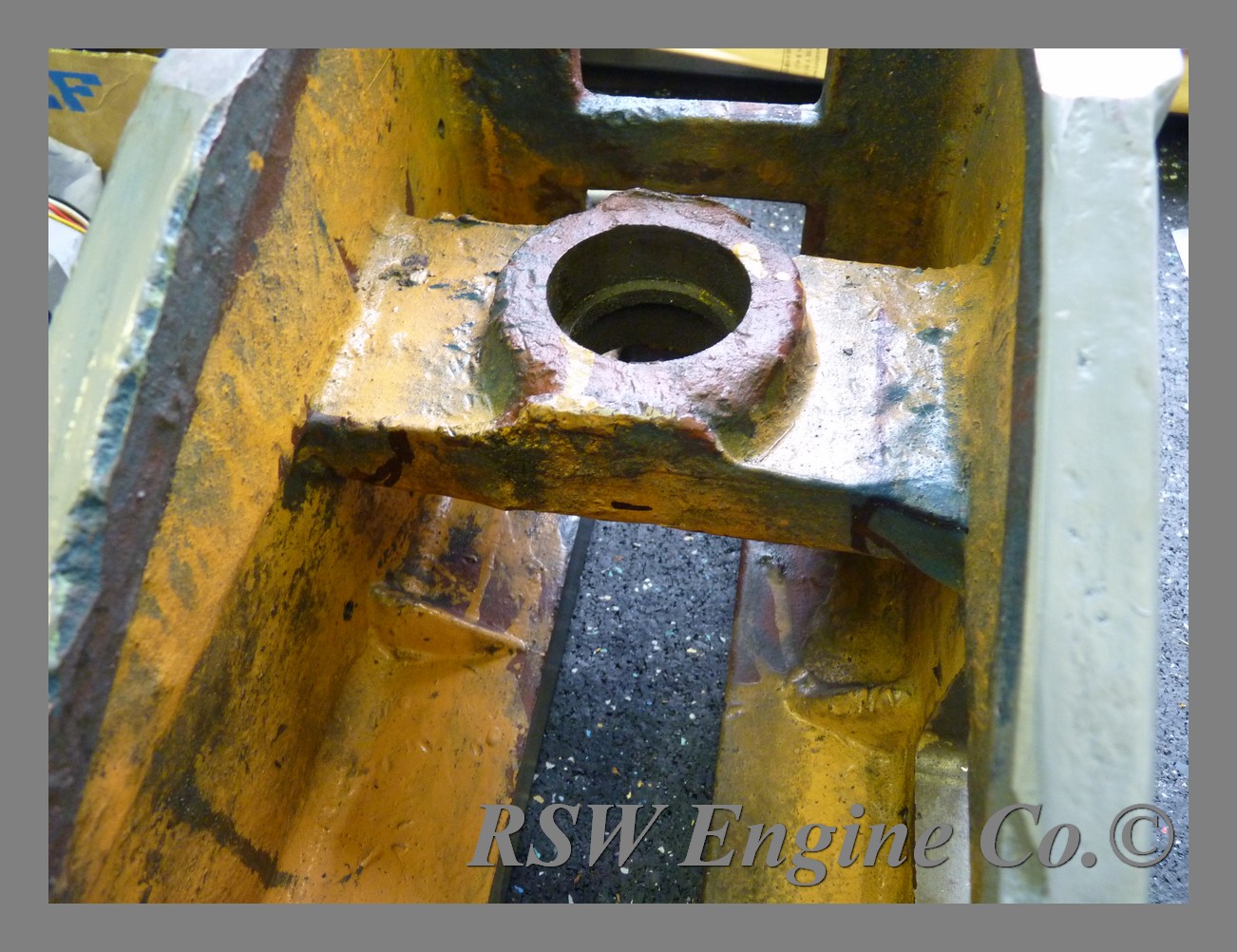

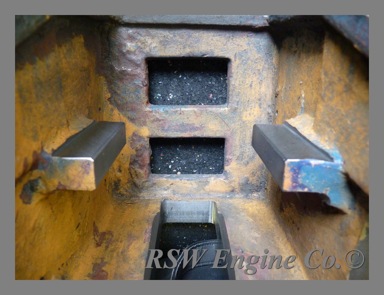

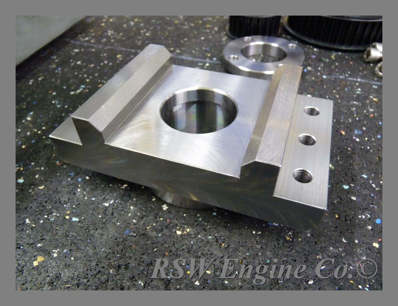

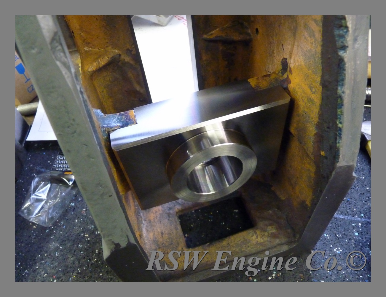

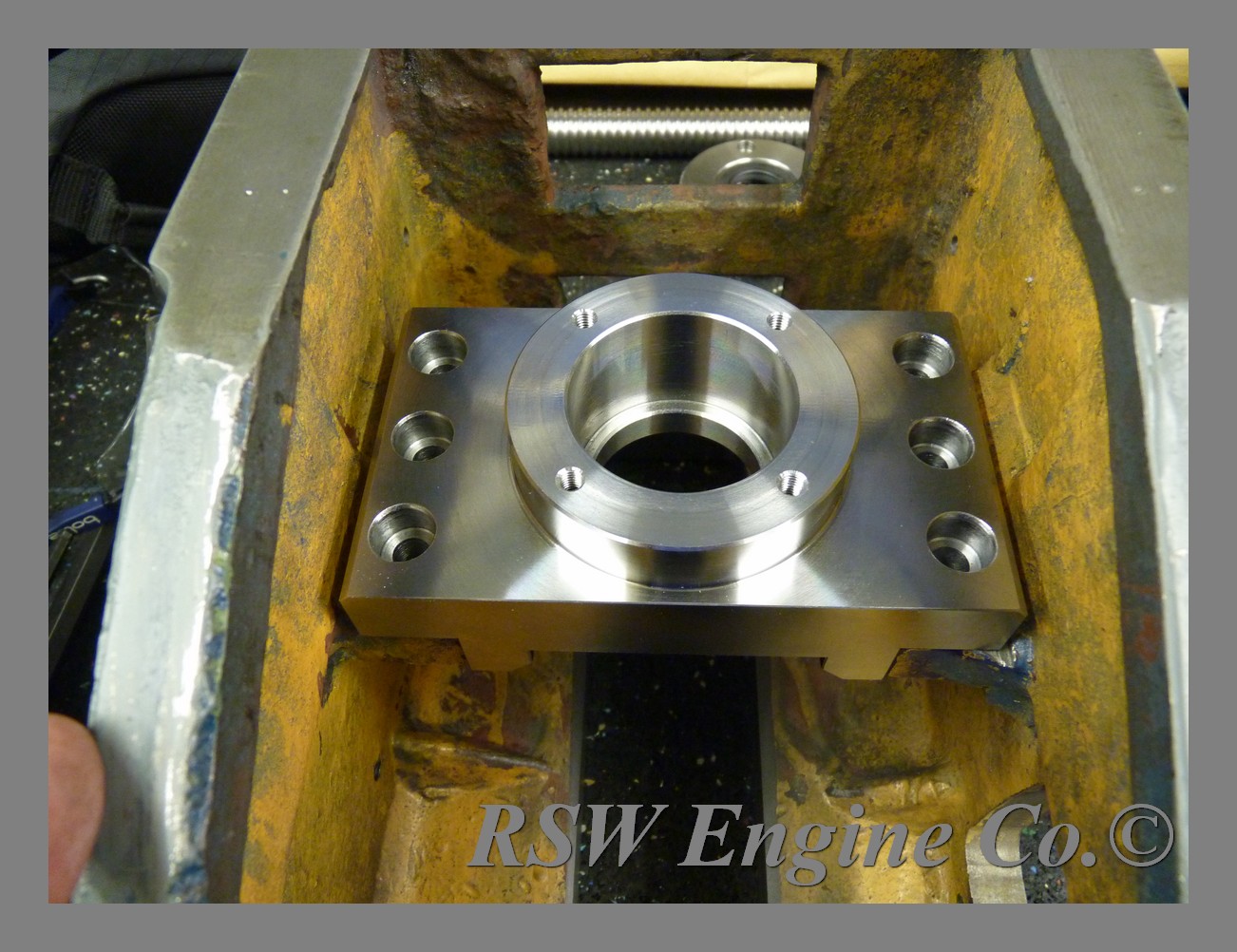

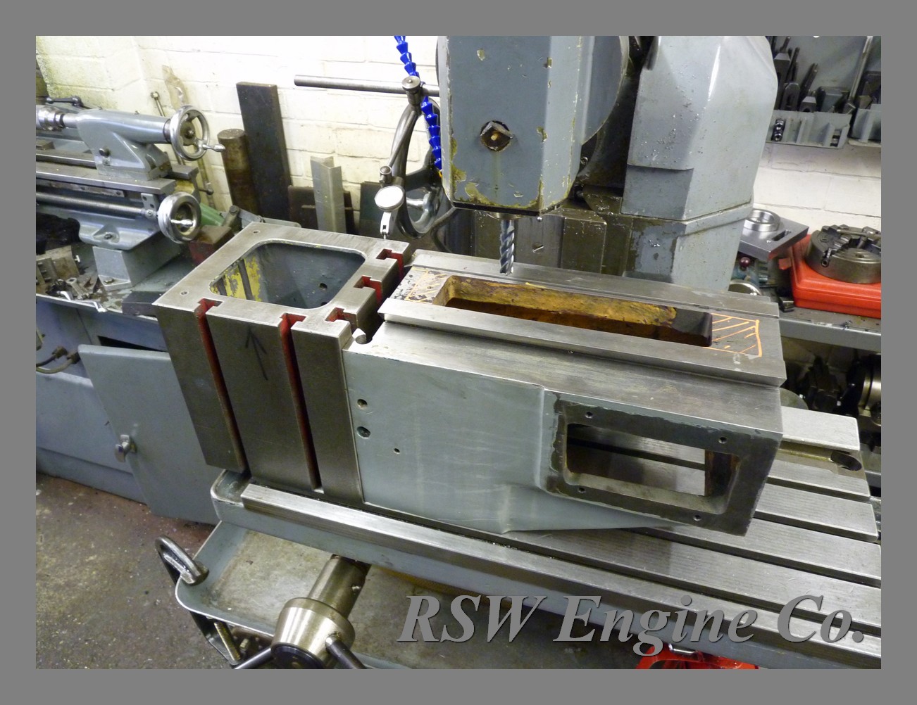

    Next up, the two spigots of casting were machined up into something more usable.
ID:	24123Click image for larger version.
ID:	24125Click image for larger version.
ID:	24127Click image for larger version.

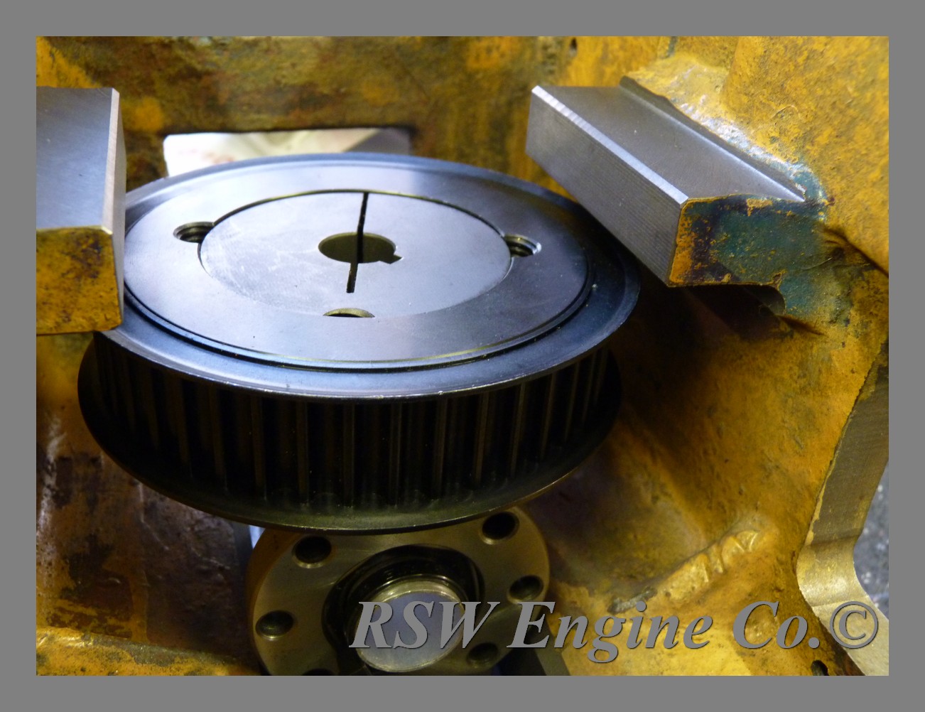

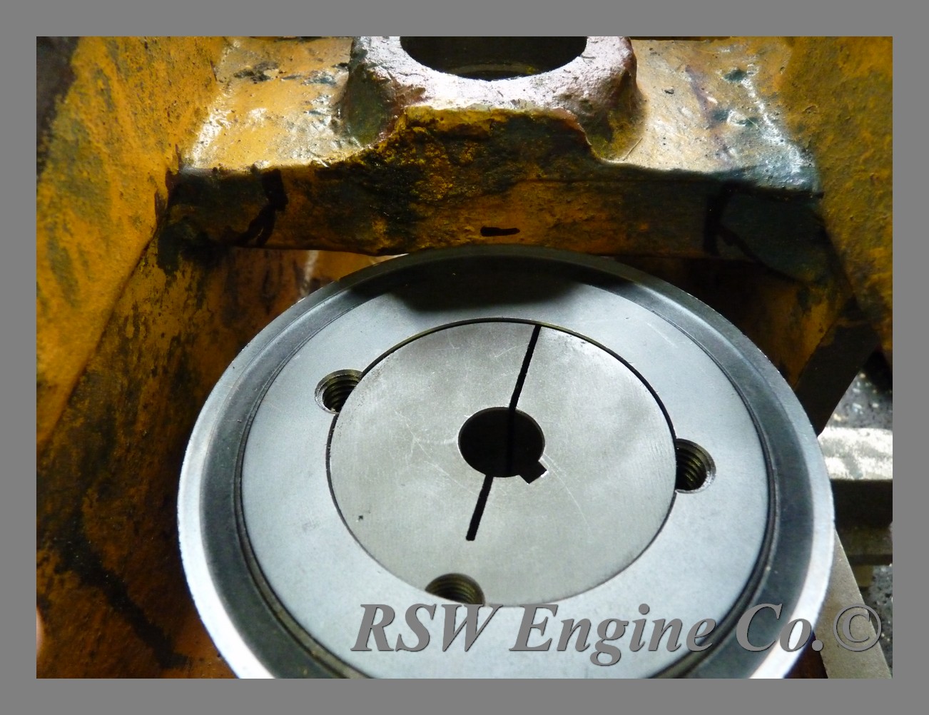

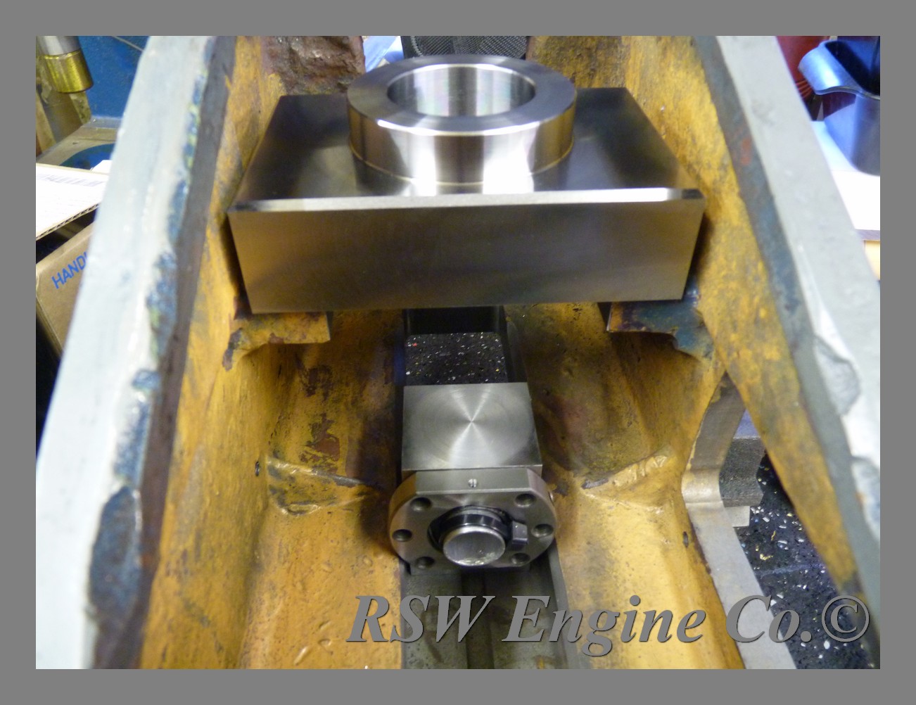

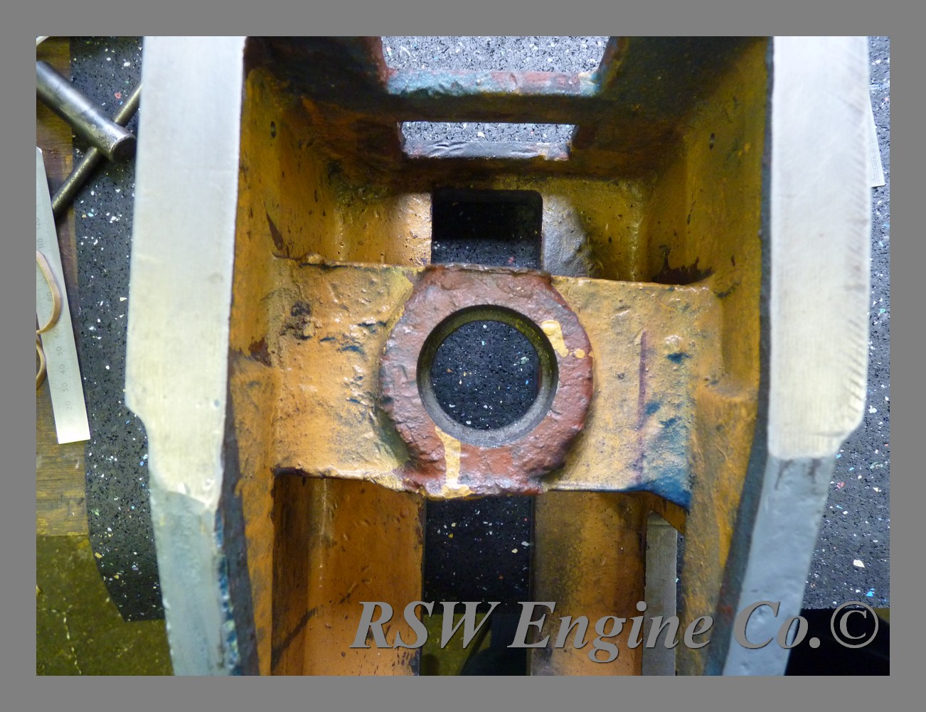

    Now I have something I can work with.
ID:	24129Click image for larger version.

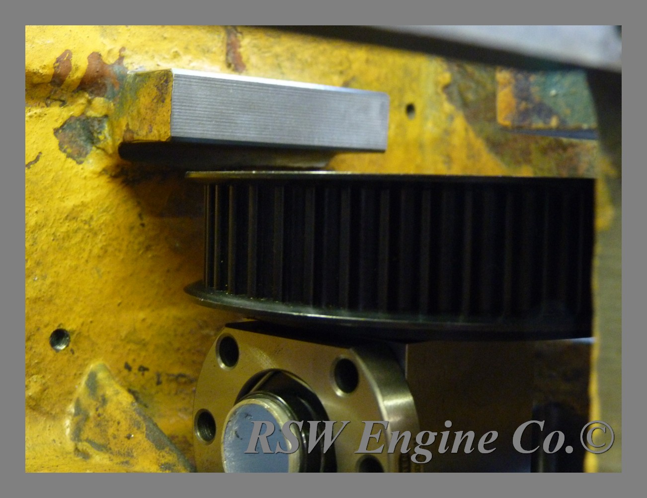

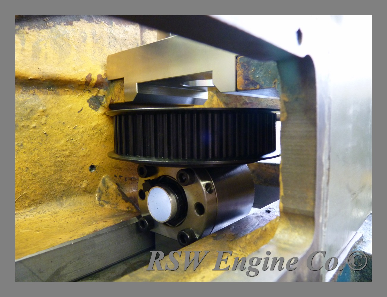

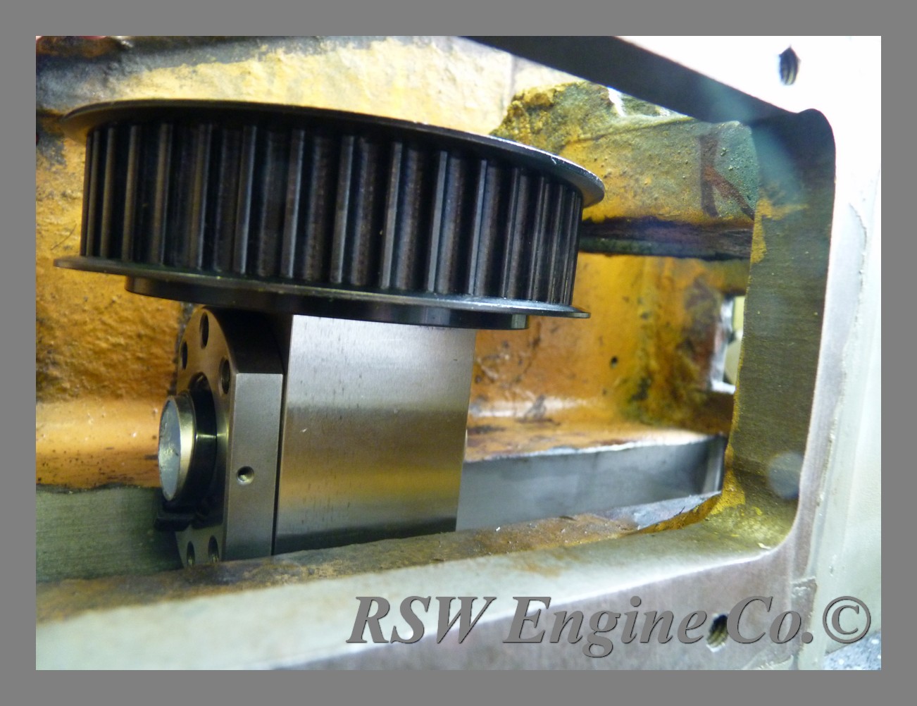

    Plenty of clearance for the Y nut and Z pully.
ID:	24131Click image for larger version.

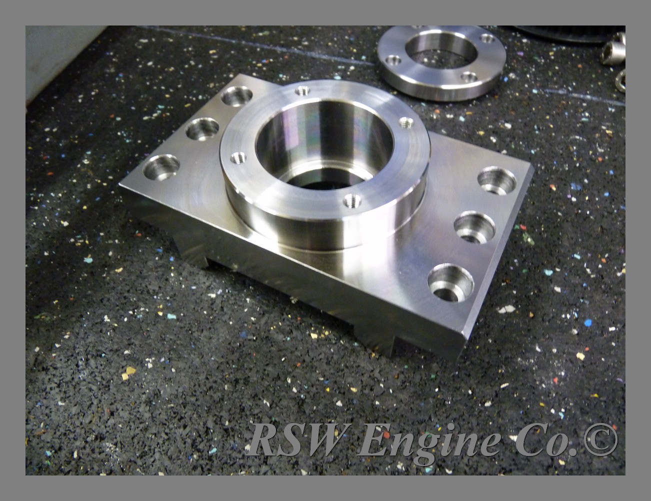

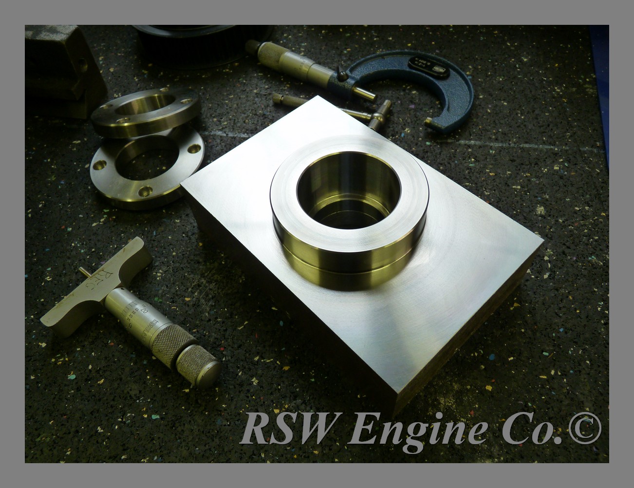

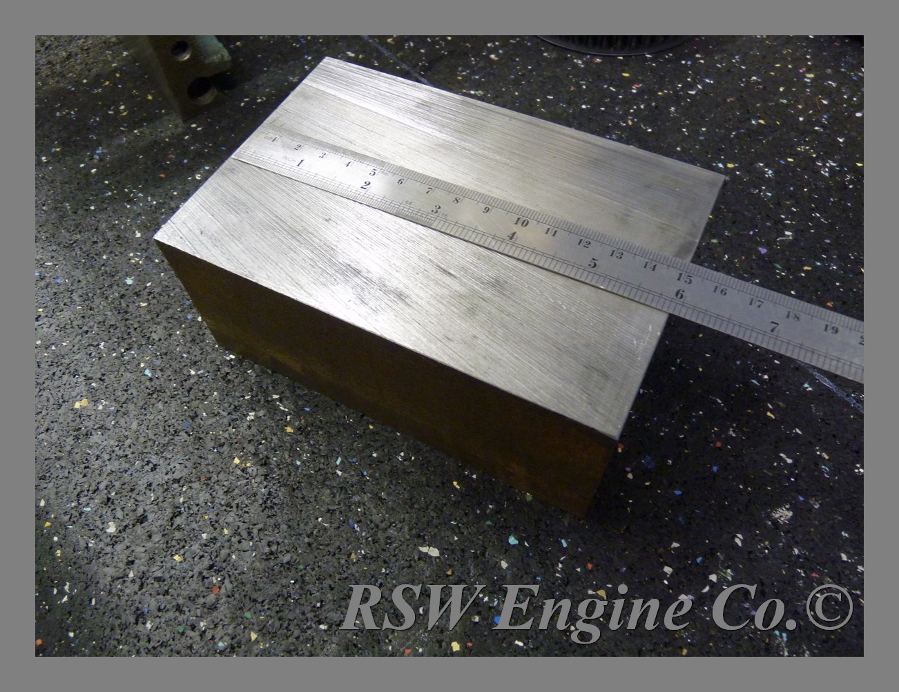

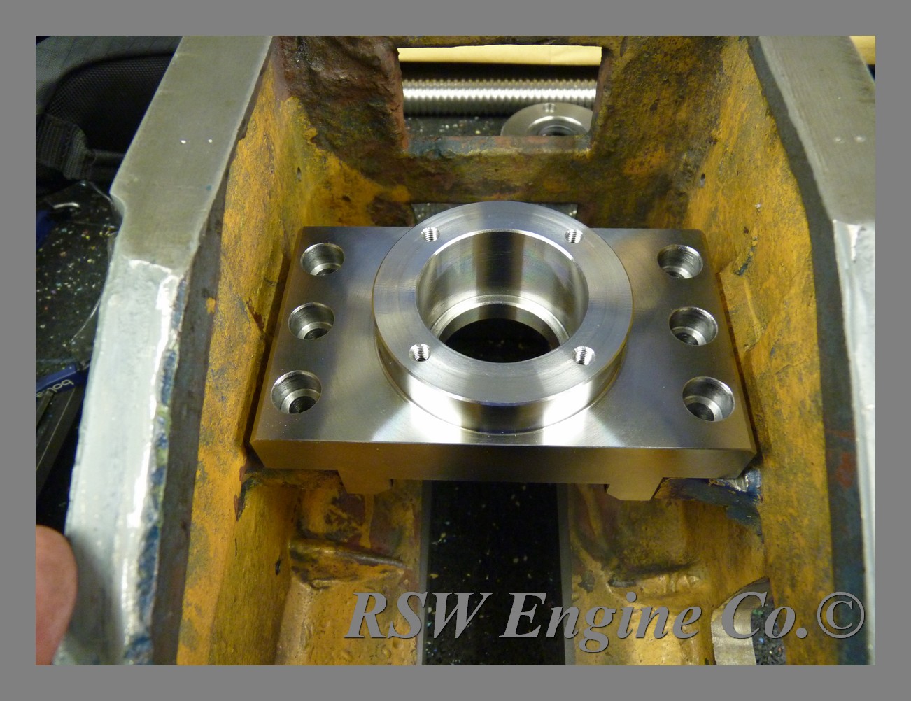

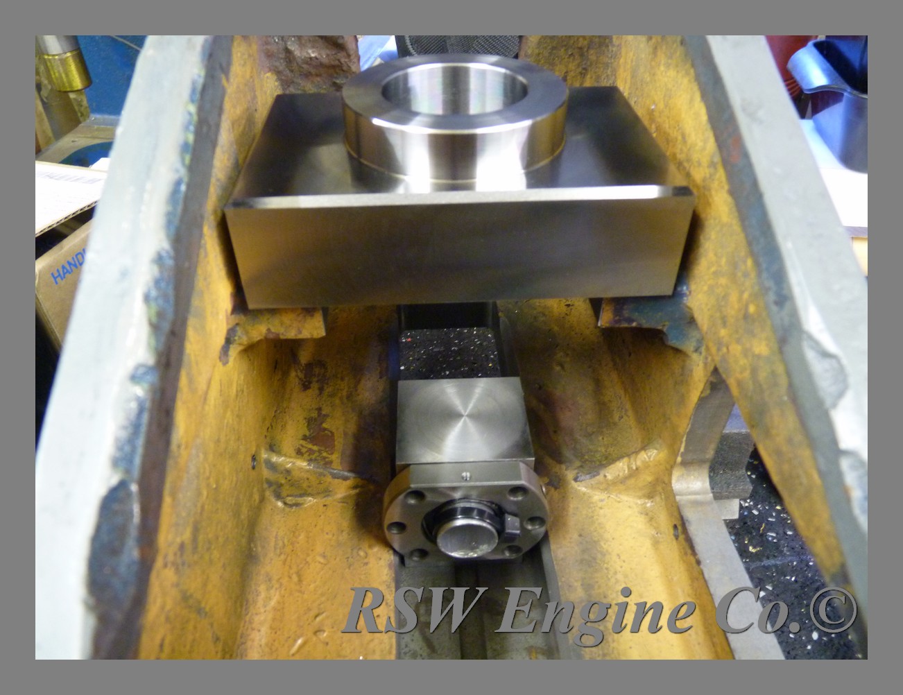

    So now I need something to carry the Z axis lead screw bearings,
    A suitable chunk of steel was chosen to make the carrier.

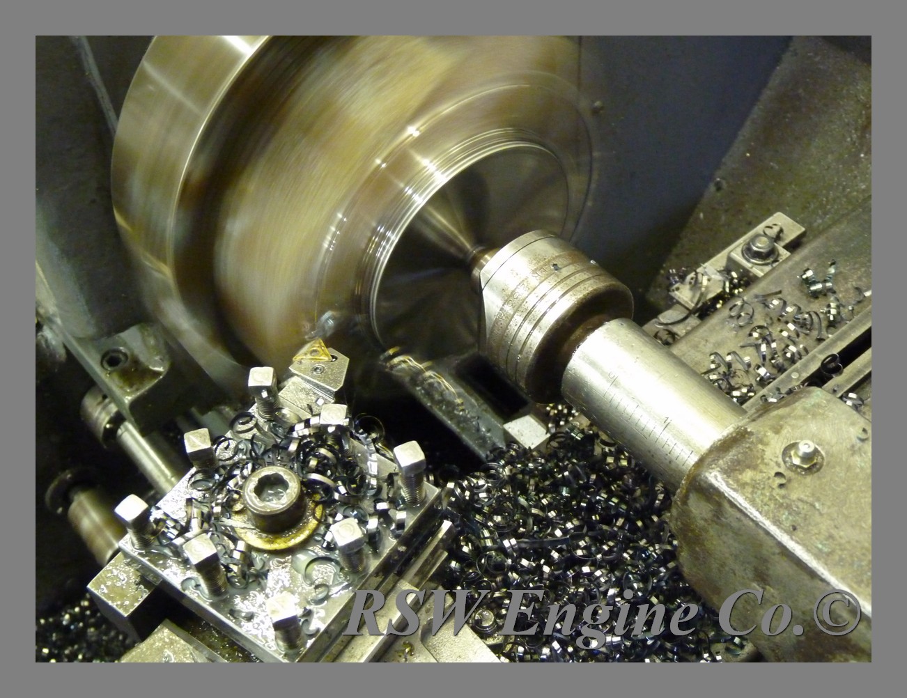

    A tad of machining on the lathe,
ID:	24134Click image for larger version.
ID:	24135Click image for larger version.

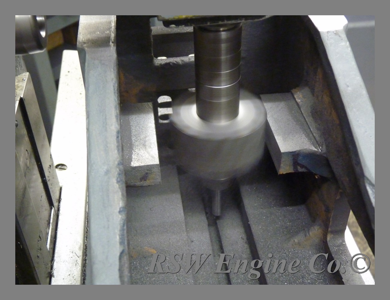

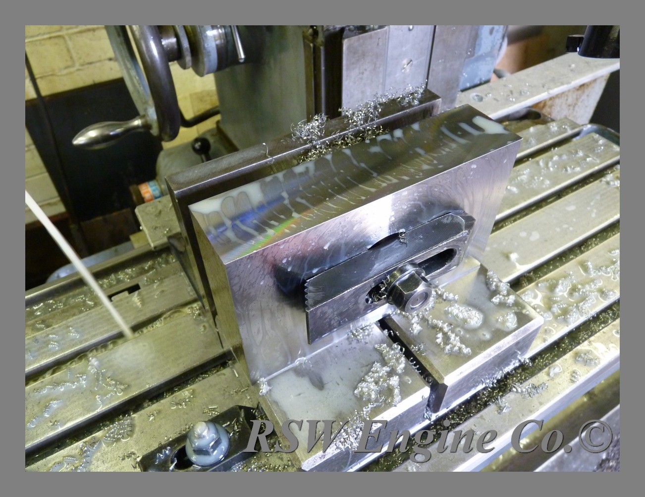

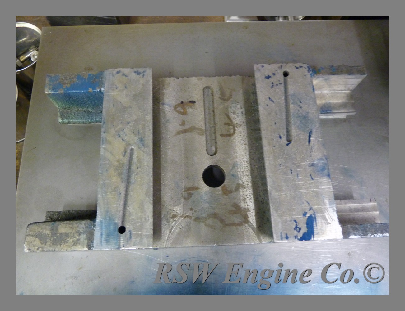

    And a bit mill work,
ID:	24137Click image for larger version.
ID:	24138Click image for larger version.
ID:	24139Click image for larger version.
ID:	24141Click image for larger version.
ID:	24142Click image for larger version.
