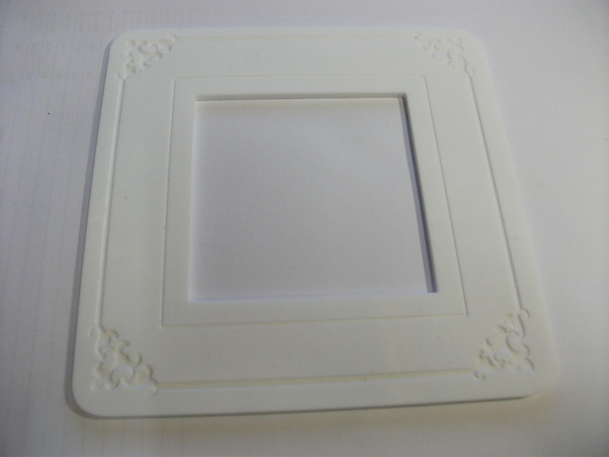

    I thought I would do a quick project, to cut a light switch surround plate out of white acrylic, with a design on it. However the thing is biting me on the bum.

    What I cant get is the inner design, which started out as a Scan2CAD dxf file, to appear on the dxf file I load into Estlcam. Help please !!

    Thanks Wal, The decorative scroll was too small, but at least it was addressable with my software. I corrected the size and have created the Gcode. The trial cut in a bit of scrap ply has finished and it looks GOOD !
    I will set up a piece of perspex sheet and cut it out now.
    All cut out, now I need some bronze enamel to do the infills.Click image for larger version.

    Thanks again Wal, but I could do with knowing what you did exactly as I have several other designs to do the same with in the near future. I think the software I have doesn't handle these files properly as I get errors when saving them as .dwg in AutoCAD. I have also tried Inkscape with similar results.
    The design is a bit off to two sides, so I may correct that if I re-cut, but my wife is OK with that imperfection.
    Job done !
    Humbrol enamel takes an age to dry. Then I cleaned up with 1500 wet and dry and finished with 2500 to give a matt look to it.
    Now I need to put it behind the switch !
