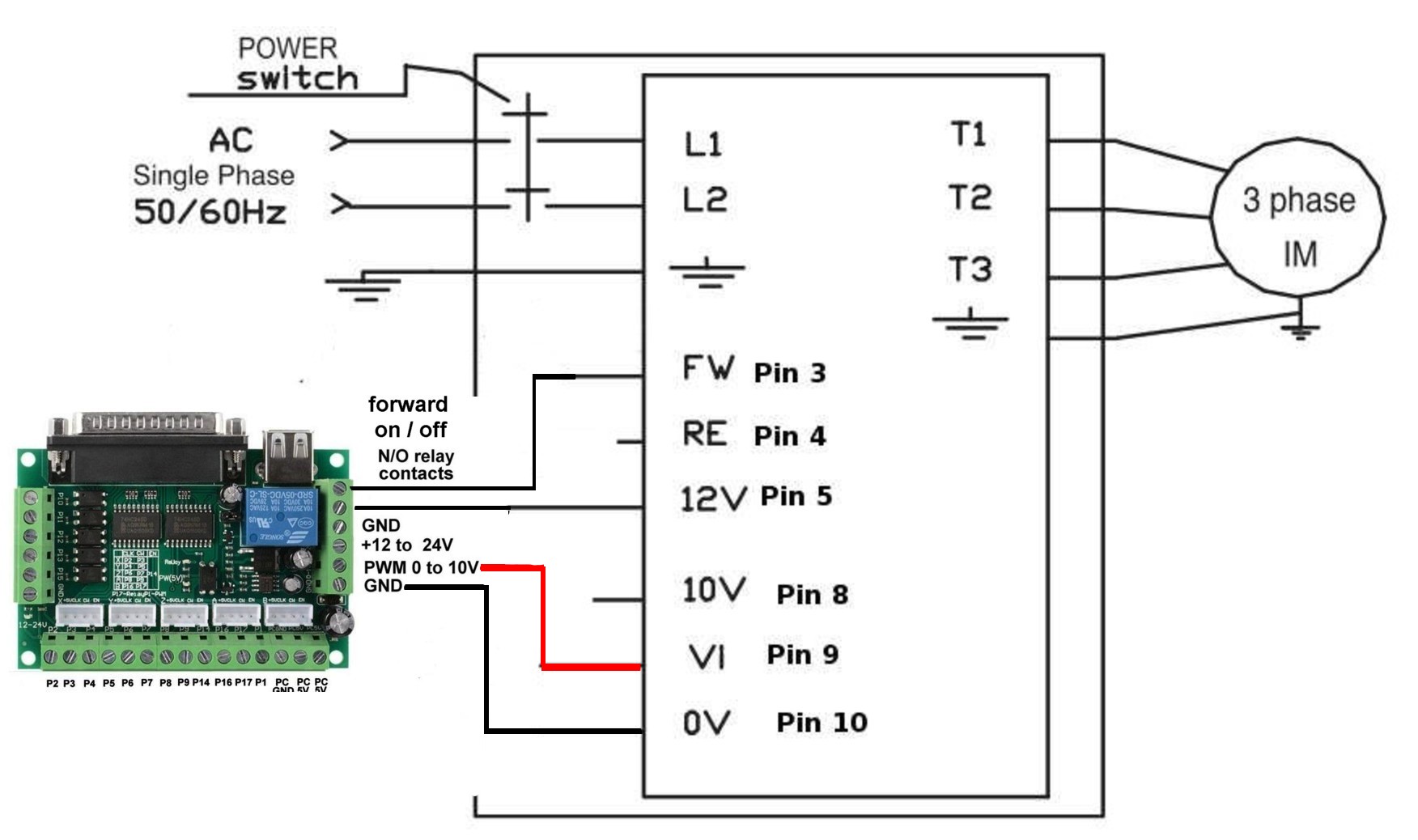

    if your VFD manual has a manual remote control some thing like this -
Name:	Remote Wiring Setup.jpg
    you could connect the BOB like this
Name:	Remote Wiring Setup to BOB.jpg
    John

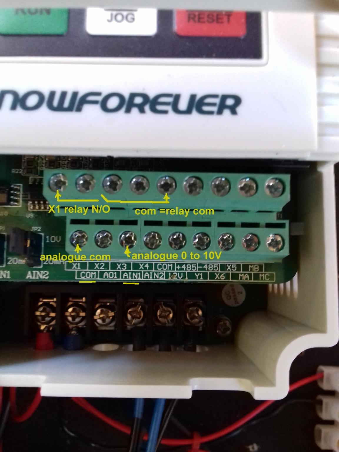

    What I've found on the Web so far is for the spindle control it is as follows:
    Com - GND
    AN1 - 0-10v
    X1 - pin 17
    However looking at your diagram X1 (FW) is used for on off relay.
    Here's what I have vfd end Click image for larger version.
    I'll try out your diagram, will getting the wires wrong do any damage to the vfd?
    looking at your photo of the terminals
    this is how I would connect to the VFD
    with the forward on/off control being BOB's the relay controlled by pin 17
Name:	nowforever vfd terminals.jpg
    yes
    the relay switches the VFD on in the forward direction
    and is the simplest control with one switch
    depending on the parameters set for input X1
    you could have 3 switches
    one for on / off
    a second for forward that works in conjunction with the on /off switch
    the 3rd being reverse that works in conjunction with the on /off switch
    John
