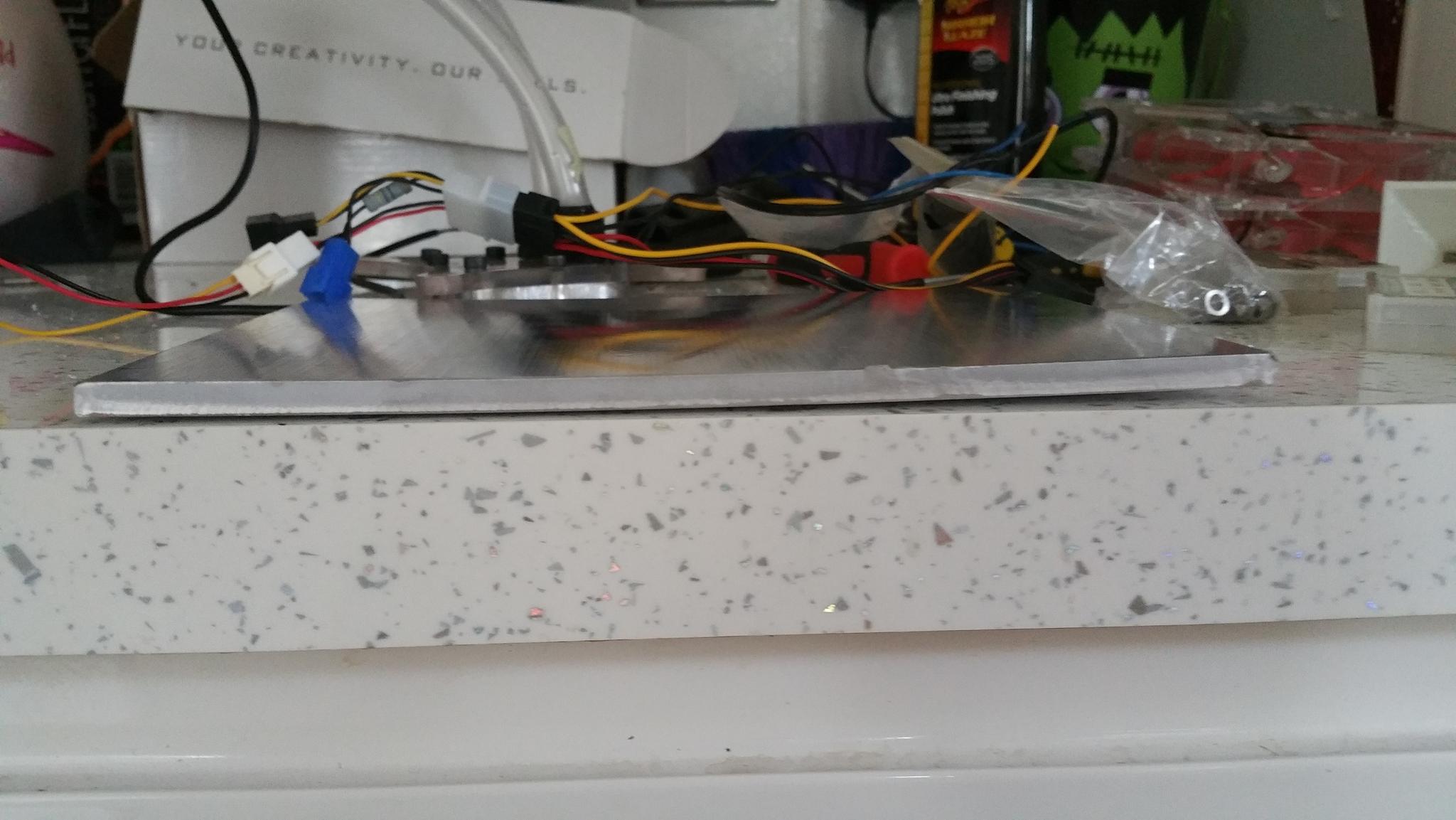

    i bought some flat plate off ebay and its warped and the seller said "Hi As previously stated there is no flatness tolerance on cut plate, this is industry standard. You also say on a different message that you order flat bar so expected it to be flat, no where in the title does it mention flat bar, do i'm not sure why you felt you would be getting flat bar rather than plate."
    Define 'warped' ....
    If you want reasonable flat (alu), you need to buy tooling plate or ecocast. Otherwise you need to expect a level of 'warped'.
    warped as in not flat. I would expect flat plate to be flat lol. no good to mount my spindle on.
    See photos

    True, that is nasty. My point is, what is flat? For some, flat enough is 0.05mm over a 300mm width, for others, 0.5mm might be fine ....
    Warped means nothing without some specification. Clearly the image shows its certainly nowhere near flat enough. It looks like its been bent in transit or something, dont think its been made that way.

    Looks like it's been cropped not sawn.

    It would be if it was being bolted down to an adequately rigid structure, if it is the rigid part of the structure you might want something thicker and/or heavier anyway

    Phill05 is correct. The plate you have has been supplied with has been guillotined. This is very clear to see from the images you supplied. This enduces tons of stress and 'latent stress' as we know it in the trade and makes plate totally useless other than for welding and plating or general doesn't matter shit kind of work.
    That effort of guillotining is particularly bad and i would not accept a plate guillotined to that standard and condition of deformation from a supplier. It would be returned immediately, you would expect some deformation but not as bad as that. Either the blade clearance is wrong or of the blade is blunt to induce deformation like that or his equipment is clapped out. That plate would have been flat enough from the mill and this is why people often buy plate because it is flat being produced from a rolling process. I would return that plate to the seller for a refund and tell him he needs to clearly state on the add that it is/ has been guillotined and this induces deformation he needs to clearly show that in an image.
    I get this kind of stuff regularly either plate cut or guillotined pending application. For your application using plate you need it plate cut.
    As already mentioned, Normally tooling plate which is 5083 is used for a lot of router builds because it is fly cut flat and is flat. (its not ground contrary to popular belief) It is also cast which means there is no induced or latent stress from the manufacturing process, because it is not produced by mechanical means. This is why tooling plate is often the first material of choice and it does not have to be machined on the faces to make it flat and it is good for size normally. You wont find a supplier guillotining tooling plate! Try smiths metal centres I use these guys a lot, they are not the cheapest but the reliability of quality is very good compared to other suppliers.

    Brilliant thank you. I have no experience when it comes to how the material should be and the seller convinced me this is normal. The piece in question cost me 10 pounds for 200mmx100mmx6mm. He told me tooled plate would cost £53 for the piece I want.

    The cost you have been quoted for Tooling plate does seem rather excessive. A piece like that would come under a minimum order charge of approximately £30 depending supplier plus delivery + vat. You could shop around and see what else you get offered.
    If you can find the time to look through the for sale section I had a load of 6 mm plate for sale which would cover the size you wanted. This is 6082 and what is known as strain hardened which is even flatter than standard plate. Saying that, you will always get some deformation of some kind but it won't be anything like you experienced. Any material which is produced by mechanical processes have some stressing in it of some kind. The only real exception to this is hot rolled materials, but aluminium is not one of those.
    If you want to go for Tooling plate and you don't have any success from a supplier. I do keep a small stock at my works. I will happily cut you a piece and send it to you for a donation to the tea fund the long as it covers costs.
