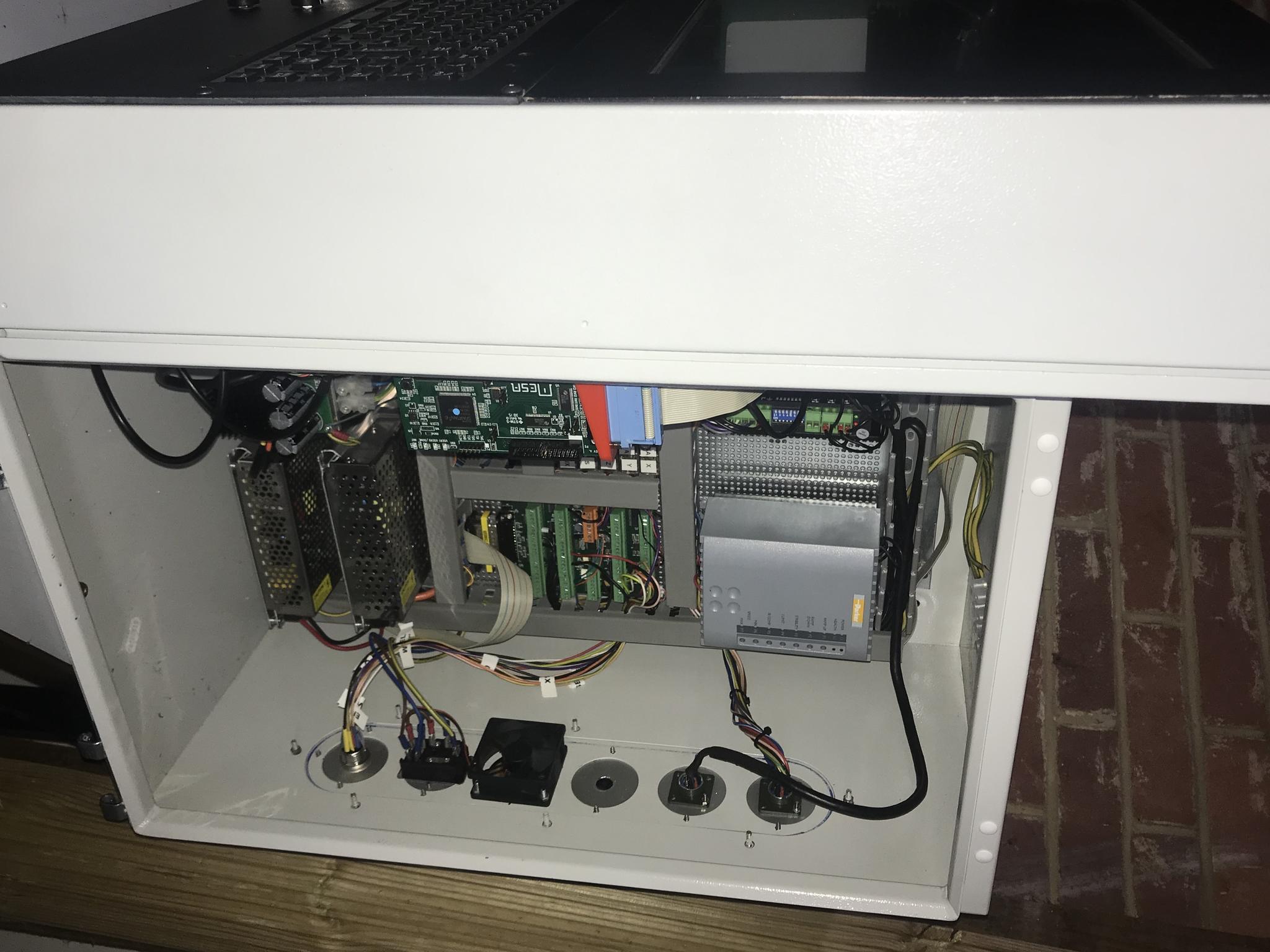

    I bought 2 sheet metal enclosures, one is 600x400x300 this will house all of the power and drive components. The other is 600x400x120 and this will be for the operator interface.

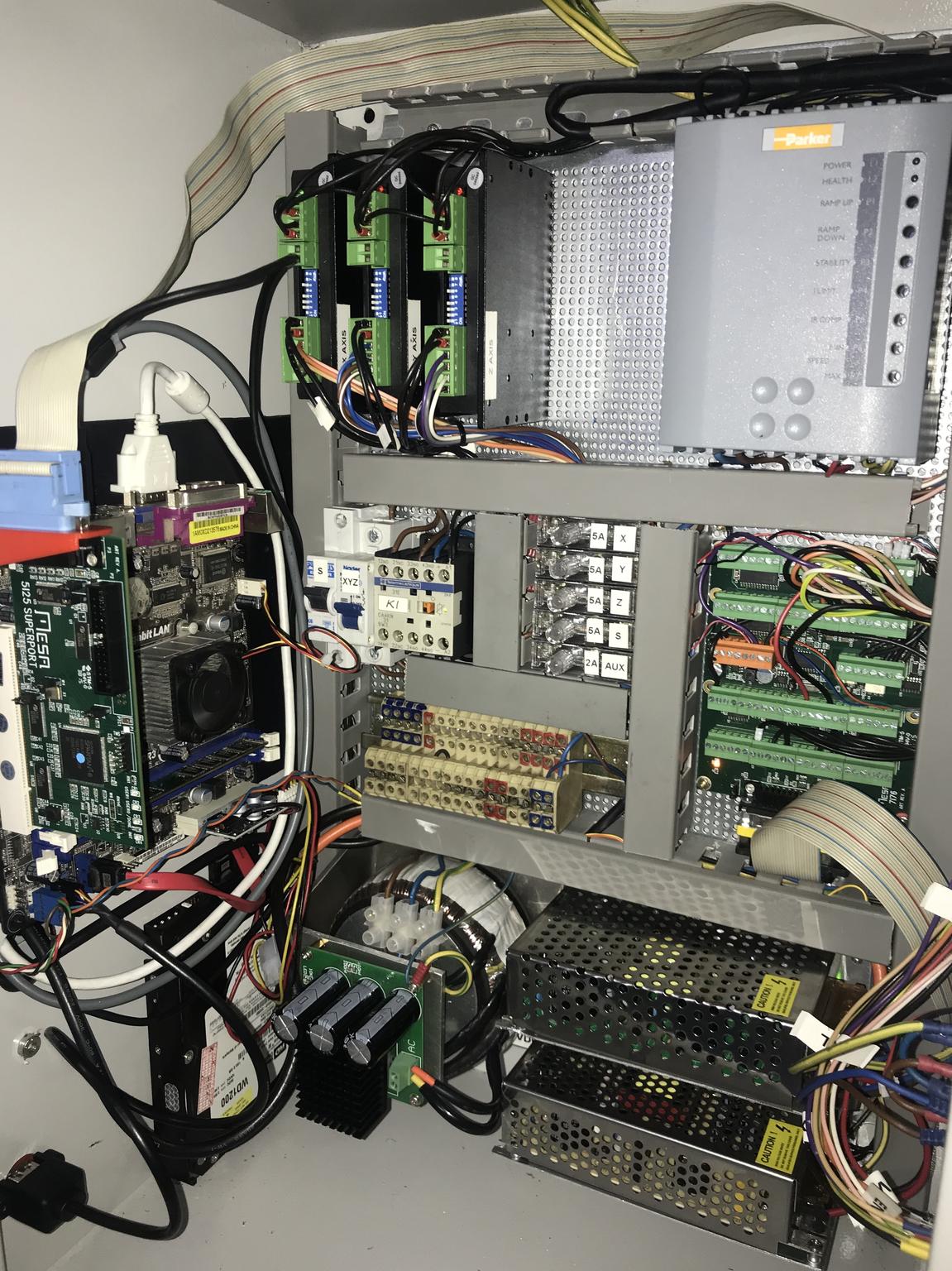

    For the spindle drive I got a Parker 508 dc drive, it will power the dc motor with the 180v dc 8A it requires.
    X y and z axis stepper motors will be powered by dm542 digital stepper drives.
    I designed my own safety circuit with fuses, contactor, and mcb’s.
    I made it all look tidy with some slotted trunking. I did by best to separate the control signal wires from the ac and dc power by routing them around the outside whilst routing the power trough the centre. Any crossovers are at 90 degrees and I utilised shielded cable where applicable.

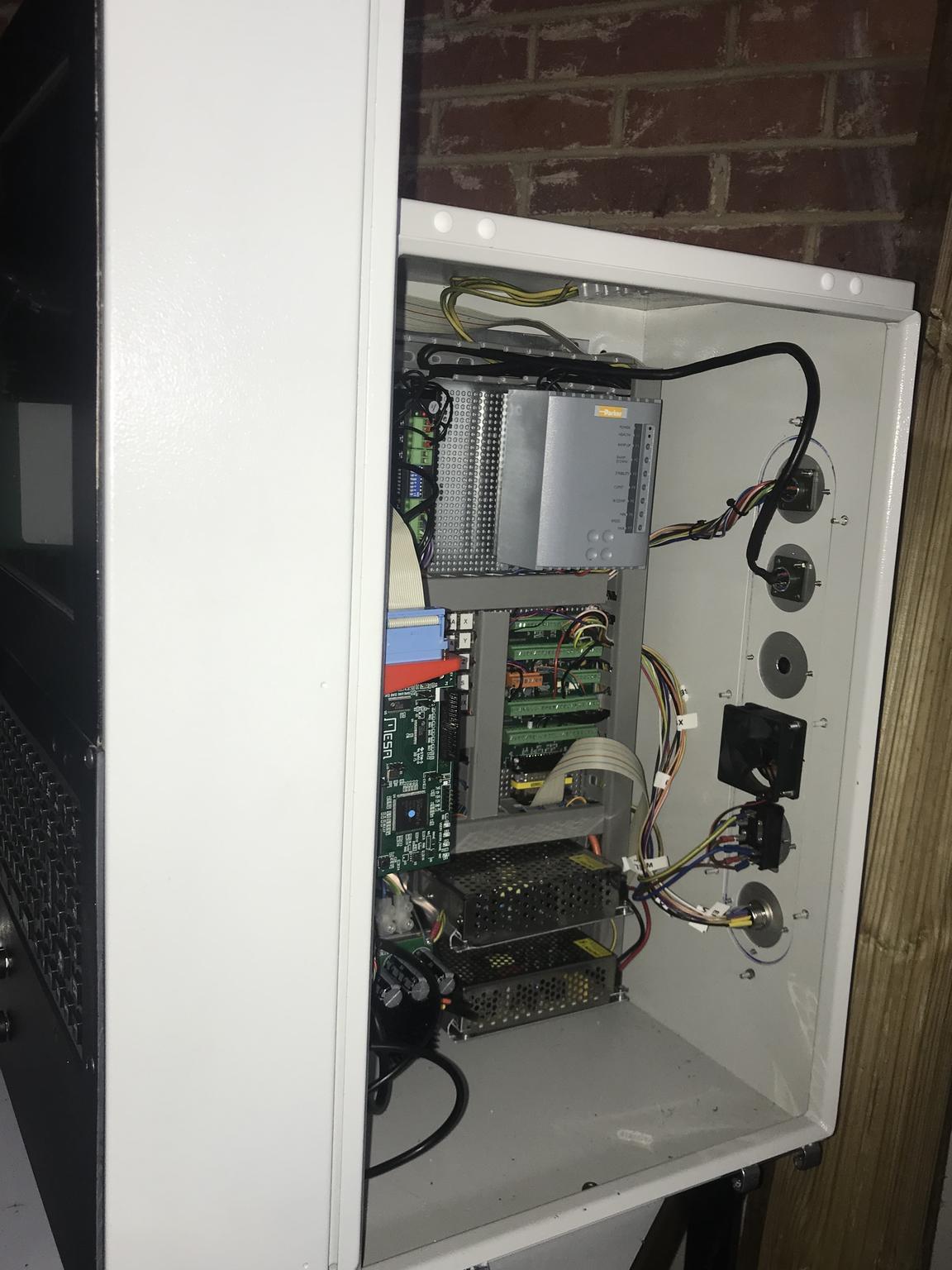

    For this build I will be using linuxcnc specifically the 5i25 fpga card and the 7i76 breakout board from Mesa electronics in California.
    The power supply for the stepper drives will be 40 volts or thereabouts, I got a toroidal transformer and a rectifier circuit and made my own power supply.

    The power supply for switching etc is a 24v 3a switching power supply.
    Here’s the control box almost complete:Click image for larger version.
    I’ve left a space so I can add another drive for a 4th axis later.
    That’s it for the control box for now as I have some decisions to make before I finalise the design, I’m not sure if I need a spindle reverse circuit and a spindle encoder I will decide that another day.

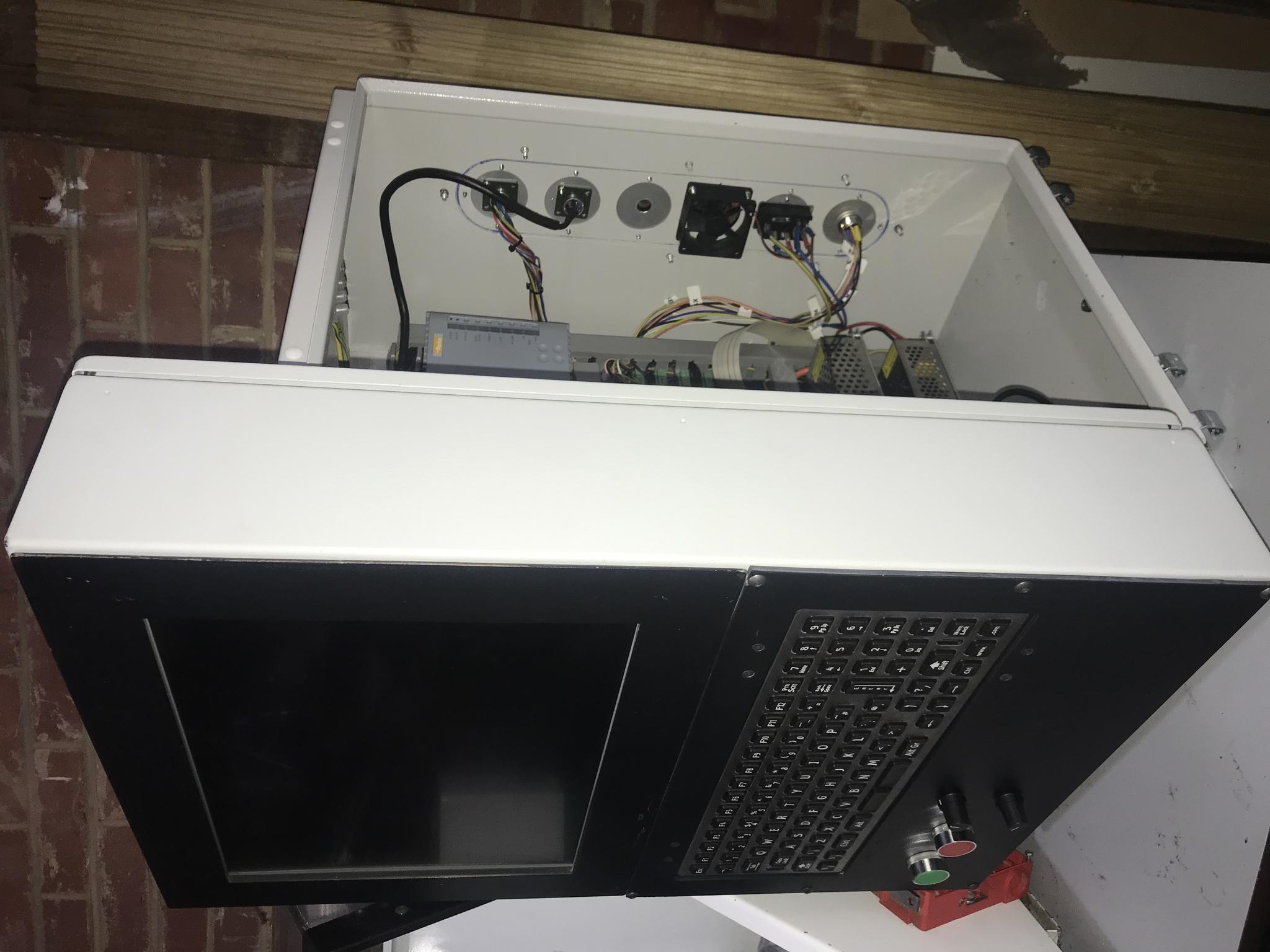

    I’ve made a start on the operator interface. For this I’ll be using a 17” touch screen monitor and a waterproof keyboard. The aperture at the bottom will house the start/feed hold buttons, a feed override pot, and a spindle load meter.
