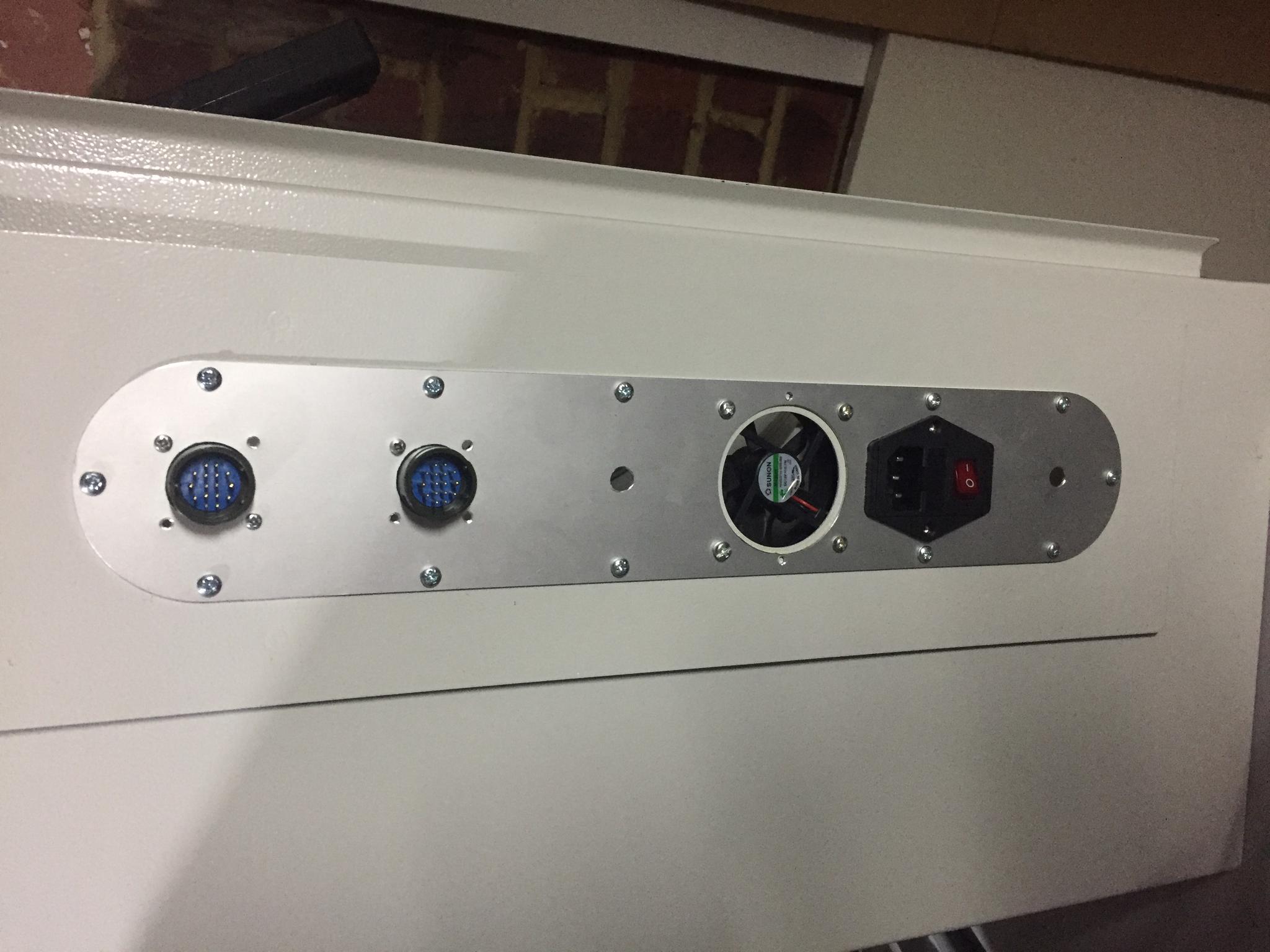

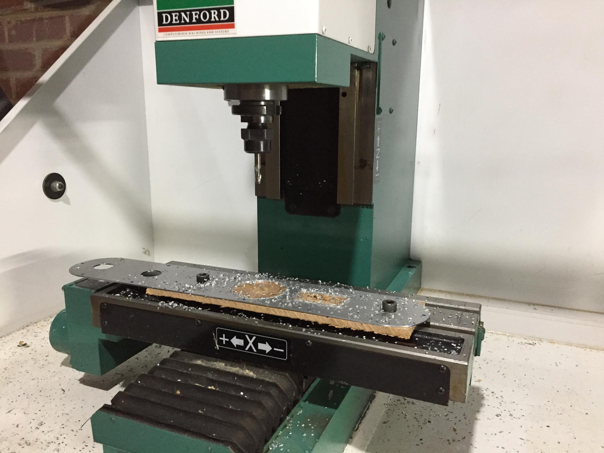

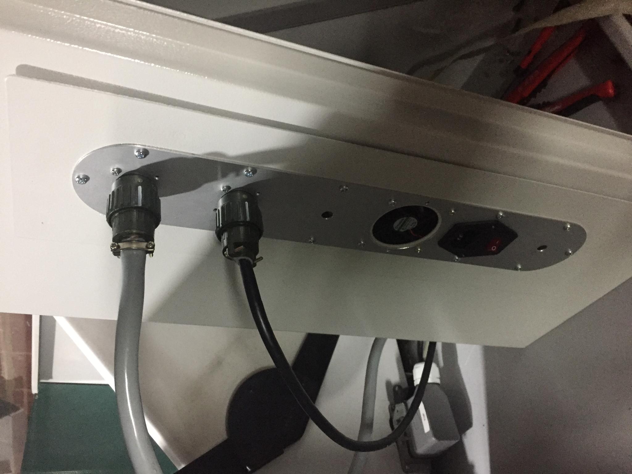

    Today I temporarily plugged in the machine and configured linuxcnc. I needed to cut an i/o plate for the cabinet. Specifically the holes for ac input, cooling fan and plugs for the machine. I had previously machined the outside profile on a machining centre as it was too big to machine on my denford mill.

    I’ve left a couple of locations empty, one will be for the mpg and the other for a 4th axis.

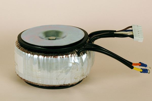

    Hi, Just on the off chance, do you have any details on the transformer you used for the steeper motors, the TXR-0736P05A toroidal power transformer 300VA.
    I have the spec, just not a wiring diagram.230V 50Hz input, 27.5v at 10Amps output

  10. #9
    Thank you, very interesting, but different transformer competely :-)
    video one is 625VA, made may 2017, one in this thread is 300VA and dated May 2018?
    I have looked at your other videos.
    230V 50Hz input, 27.5v at 10Amps output.
    Designed and manufactured to BS EN60950 and BS EN61558.
    Complete with integral 85ᵒC Thermal cutout NC, and thermistor 10kΩ for Temperature Measurement and protection.
    Dimensions 115mm OD x 60mm height. Weight 2.55kg
    Includes mounting hardware.
    Input Connections PVC flexible leads to 7 way JST in line connector
    Output Connections PVC flexible leads to 6-32UNC ring crimp
    Full specification and drawing available.
    http://www.toroid-tech.com/clearance...nsformer-300va
