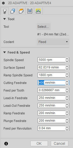

    First short video of machining aluminium. Still very new to this so any tips would be appreciated. I was playing with feeds and speeds during the test.
    Started off with feed rate:
    2mm DOC
    https://youtu.be/MAfQFzEzogA

    It is difficult to say anything regarding that video since I don't know how your machine looks like. To me it seems far too slow, but perhaps it is not possible to speed up more. Personally I'd prefer much faster speeds, like spindle speed 18krpm and feed rate 2700mm/min or maybe more. Here is a short video I made some time ago, milling at higher speed.
    Note that I am using 4 flute bits, to me they work better. I don't use any lubricants, only the vac with dust shoe. That is enough, nothing gets hot if I don't slow down the feed rate too much and rub the bit.
    Does seem like a very slow feed, but as above with no details on your machine it's hard to know... sounds like the tool is chattering a lot. Is it really only 5k rpm?
    You can reduce your tool stick out a lot there... ideally you only want enough of the tool sticking out to clear any fixings and get as deep as the bottom of your work piece. Obviously you don't want to insert it into the collet deeper than the shank but consider using shorter tools where appropriate as this will reduce tool flex, reduce chatter and minimise any runout issues.
    I use mist coolant and air blast when machining alu and that works great for me.
    You are also using adaptive there but you don't show your axial engagement (it's on the 4th tab). You can reduce this to suit the rigidity of your machine while also upping the Depth of cut to get more of the cutter length engaged.

    Thank you. My spindle isn't at 5000 sorry. It was at 18000 and I was adjusting it as the cut went on. I use air blasting but no mist as I'm machine on top of mdf.
    I've got a Chinese 3040 not great i know. I was using a 3 flute tian coated endmill.
    Sent from my SM-N910F using Tapatalk
    Feed is way too slow for that RPM imo.
    Try a feed of 1000mm/min with around 12,000 rpm and an axial engagement (again, found in the 4th tab) of 0.8mm... these chinese machines are a little ropey so play around with the rpm to find one that sounds better and doesn't cause resonance in the machine.
    Don't use TIAIN coated end mills in aluminium... the aluminium nitride causes the aluminium you are cutting to weld to the cutting edge. You can probably see where the coating has turned silvery already - that's your alu ending itself to the cutter.
    Much better just to use uncoated carbide and a good mist coolant.
