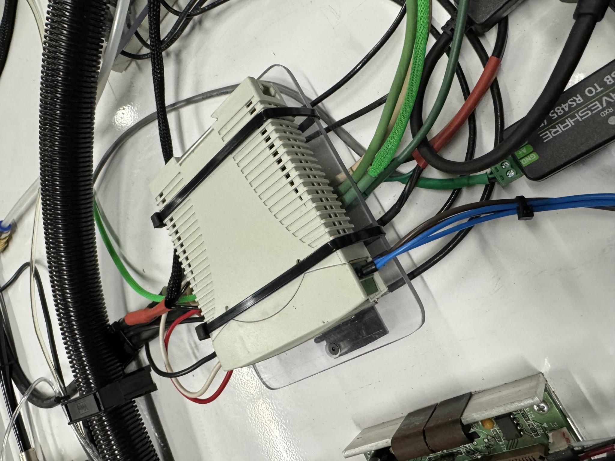

    I am currently away from my machine until monday afternoon but this is a poor picture of the aftermarket RS 485 adaptor I used and how I wired it. I'll take a better isolated picture when I get to the shop.
    Basically, the AXYZ machines use 4 wires feeding their Dsub9 connector but of these 4 we only need three. The red wire carries 5 volts and is the culprit in blowing up fuses etc. When I removed the four wires from the dsub9 connector, I just trimmed the red wire back and put some heat shrink around it ti isolate it. That leaves you with three wires, green, white and black. The black is ground and the green white are transmit and receive for the data packets. I hooked them up to the two pins on the adaptor and it didn't work so I reversed green and white and it worked perfectly.
    I had to setup a comm port in Windows 10 Pro and both times I've done this it turned out to be port 4. If you don't know how to designate ports within windows there is plenty of documentation on the world wide web that can easily guide you as it did me when I figured this out.

    I never have luck attaching pictures so lets see how this goes.
