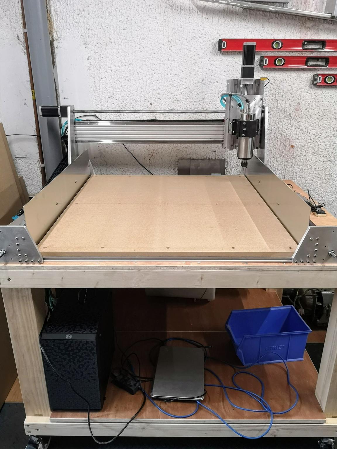

    I'm working on my first CNC build previously I have used and heavily modified a shapeoko. I'm in the final stages of my build (putting everything back in the garage and tweaking). Over the weekend I took my 2.2kw Chinese spindle and Huanyang off my shapeoko and fitted it. Thinking this would be a simple job I hooked it up the same way it had been connected.

    And here is a picture of my build :D it has a 80 x 80 x 15 cut ability. I designed and cut the entire frame on my shapeoko 3.

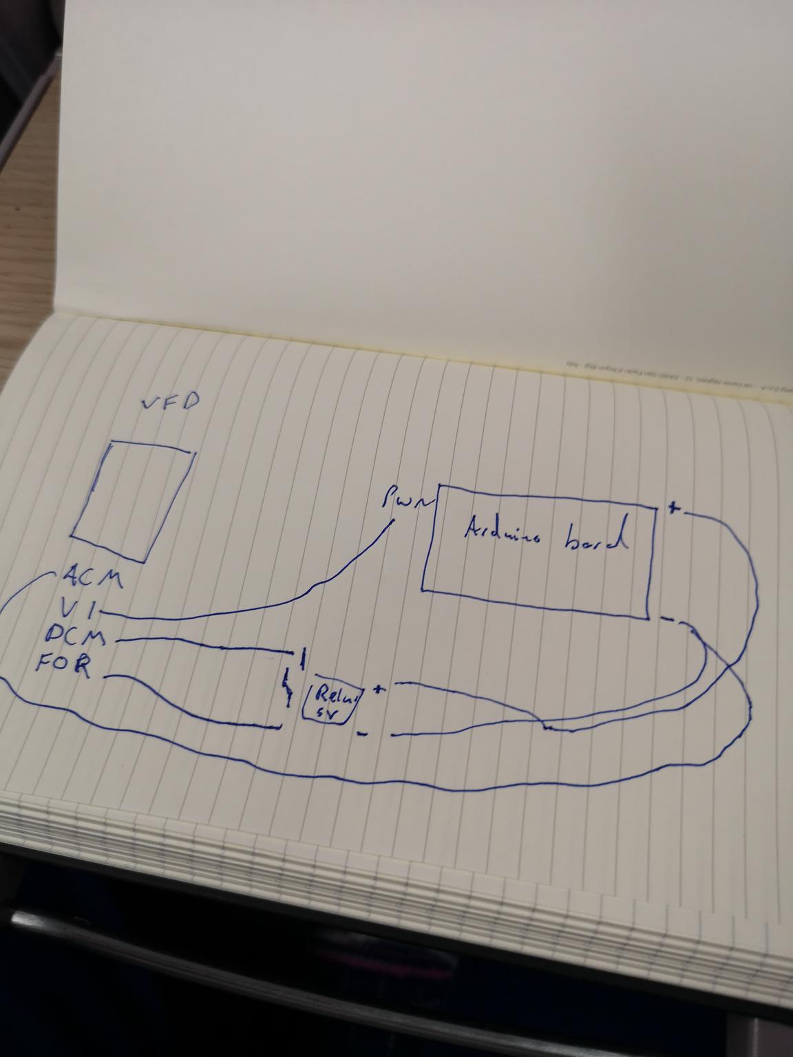

    I have to admit that I have no idea what VI, DCM, For and ACM are. Please make a drawing to show what you connected to what and more details about the resistor and the relay. Perhaps post relevant pictures and not the whole machine which does not give us a clue about the possible problem.

    Here is a wiring diagram it's a little poor as I'm on a bumpy train.

    There's a lot of ambiguity with the OP's description.
    Firstly, how have you connected an Arduino PWM output to the VFD? I'm guessing this is a run-of-the-mill HuanYang VFD - no-where in the manual describes setting this up for a PWM input (ref. configuration parameters PD002 and PD070). You mention some external drivers and electronics, is this providing the PWM to analogue conversion?, details please.
    Let's get back to basics. Isolate the Arduino. Just have two switches - connected between FOR and DCM (this is your On/Off), and between VR and VI (this is your 0/100% speed control), set PD002 to 1 (default = 0) and PD070 to 0 (default). Then test the behaviour using just these. If your problem goes away then it's nothing to do with "surge of power".

    Let's have a look at the wiring diagram for this.

    Firstly - has this behaviour started when you connected the arduino and configured the VFD for 0-5V operation? Or did it start when you move the machine into the garage? (or did you big-bang both changes together?)
    Particularly relevant to the problems being encountered during the move to the garage: I'd be inclined to examine your RCD and understand if it's a Type-A or a Type-B - the latter being recommended for frequency convertors (e.g. VFD). Google the two types to understand more if you want to pursue this.
    If the problem was introduced by the Arduino - then, first-off you know the Arduino analogue/PWM outputs are not analogue outputs, but a digitally switched 0/5V PWM output?, I've not seen anything that gives me confidence that this would work directly connected to the ACM/VI input to the VFD. If it does, then it's likely more by luck than by design. Normally you connect a PWM output through some form of integrator to generate the analogue output (many cheap BoBs provide this functionality - and that might be an option to explore). My thoughts are around what the VFD may be trying to do with an VI input that alternates 0/5V a thousand times a second. One thought - flash the arduino to set the PWM output to ONLY 0% or 100% (and no-where in between!) - or better still remove any of the PWM initialisation and drive it as a discrete output - again, only 0 or 1. If that cures your problem then it's the PWM behaviour that's the problem and is resolvable. If you don't fancy changing the code, then pull a 5V supply from the arduino and drive that into the VI input, instead of the PWM drive - you'll only have on/off control, but it'll help isolate the problem.
    If you try the above and the problem remains (with the VI connected only to 0V or 5V) then... try disconnecting whatever PSU you're using to drive the arduino - power it through the supply socket using a PP3 battery (it won't last long!) - if that cures the problem then I'd be inclined to dump the USB PSU that you're driving the ardy with (I'm thinking what can cause an earth-leakage the the RCD is picking up)

    Chinglish at it's best - Analogue Voltage Frequency Reference Input... to me at least... refers to the per-unit proportion of the VFD output frequency. So, for a 2.5V (of 5) input = 0.5, then the output frequency would be 0.5 x 400Hz (or 12000 RPM). Nothing to do with a PWM mark/space ratio. My guess is that there's a simple R/C filter on the VI input that is providing crude integration of the PWM signal.
    The problem is that without a well-designed input circuitry that the VFD is unlikely designed to suit the PWM output of the arduino (which is not particularly conventional) - the integration function required for the PWM conversion (assuming it's analogue - not unreasonable) requires a timing constant suited to the PWM source - and I think it's optimistic to assume that this will work well (you might find that you have good control over only a small portion of the PWM variable range - but not linearly across the full range).
    To use the AI/4-20mA current loop requires more circuitry - you need to generate a constant current, a value of 4mA representing 0 RPM and 20mA representing 24000 RPM, and all the steps between. This is an industrial signalling system that helps avoid errors due to voltage drops in the system. You won't do this easily with an Arduino PWM output. I'd give up on this until you get your tripping bug ironed out.

    I had a look though the Huanyang inverter manual and the only reference I can find to PWM is SPWM, which is used within the inverter to control output switching. If your arduino is putting out 5v PWM signal and you have connected it to VI it will be switching on and off like it is stupid. What software are you using on the arduino. If you are using GRBL v0.9 then D11 should put out a 0-5v analogue signal
    https://github.com/grbl/grbl/wiki/Connecting-Grbl. I have the feeling that describing D11 output as PWM is in error.
