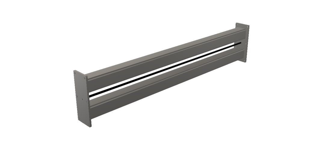

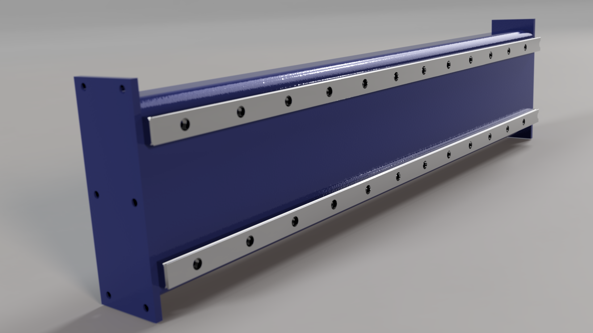

  9. So, after much deliberation, I've decided to go with a 2" x 6" x 3/16" x ~750mm long piece of mild steel for the X beam. I found a local machine shop willing to flatten the face where the linear rails will go and make the bottom perpendicular along with plates that I'll weld onto the ends for mounting. I found a good source on eBay for the steel. The reason I opted for 2" x 6" x 3/16" was both budgetary and design based. I couldn't source the size tube I wanted locally so shipping was prohibitively expensive after a certain wight/size point, massive jump in price. Literally from around $36 shipping to well over $100! And, since I'm doing this upgrade in increments, I'll eventually switch over to a fixed gantry with Y table movement, I want to keep the weight somewhat reasonable. This beam is 9.42lbs per foot making the total weight around 23.5lbs. That's a goodly chunk of steel to be throwing around along with the whole X/Z assemblies and router! Ooftah. Let's see what these poly carb wheels can take (on the gantry plates). The total upgrade is going to be close to $500, not including all the swearing I will do. I'm teaching myself to weld with a pitiful little DC arc welder I picked up, and off to the races! Wish me luck! Video to come.

    So, here is my current plan for the X beam, 2" x 6" x 3/16" steel beam with linear rails. I'll weld at least .25" thick plate onto the ends for mounting to the gantries. Maybe thicker? Not sure if it's necessary, will just add more weight.
    Over on the Openbuilds forum, M90Ranger suggested I split up the rails and use a design like this: Click image for larger version.
ID:	24452 Certainly two .25" wall 2" or 3" square tubing would be cheaper than the single 2" x 6" I purchased. Somehow I like the overall feel of the single rectangular tube. Which do you think would be more rigid?
    Check out my DIY CNC trials and tribulation videos on YouTube: https://youtu.be/SwHb75_GWwM
  11. #10
    Two tubes could be almost but not quite as good if the end plates were of infinite stiffness, the guy who suggested that obviously isn't aware of the concept of Triangulation in structural design or the properties of different cross sections in torsional load.
