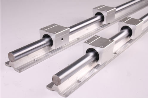

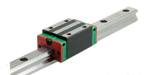

  8. OK, so I'm solid on using the 2" x 6" steel tube for the X beam! I have a few more questions for you good folks.
    - 1/4" inch steel plates for the end caps on the beam? Or should I go thicker? 1/2"?
    - 20mm round supported rails and bearings ~$80, or spend the extra dough and get linear rails and bearings ~$240!
    The other factor on the square rails is that I'll have to have the steel beam milled, which will probably cost $200 or more, whereas the supported round rail is far more forgiving when it comes to alignment. The rectangular steel tube has a round crest to it, but it is fairly consistent along the length of the beam. I'm thinking that I can screw the supported round rails right to the beam, maybe a little shim stock if necessary, easy peasy.

    I'd love to hear your thoughts on these two issues.

    Linear rail, and epoxy?

    Yes what Doddy said

    Supported rail will be better than the wheels you have now and my previous machine ran on those for a few years. But there can be some maintenance such as sometimes the bearing coming loose in the housing plus there was some wear on my set that I noticed when I took them apart and was the likely cause of it getting worse for chatter.
    So if you stay in this hobby you will get linear profile rails in the end.

    Linear rails are far superior to round supported rails.
    Gerry
