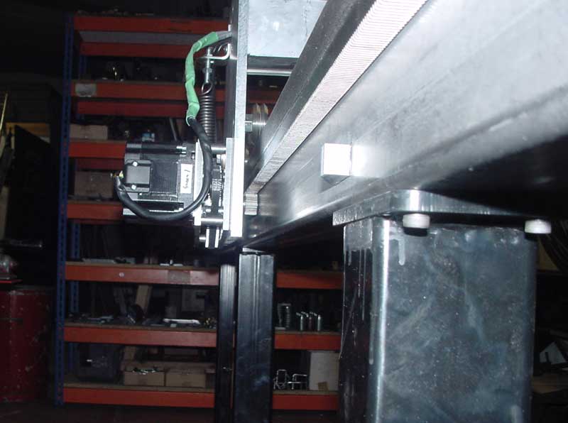

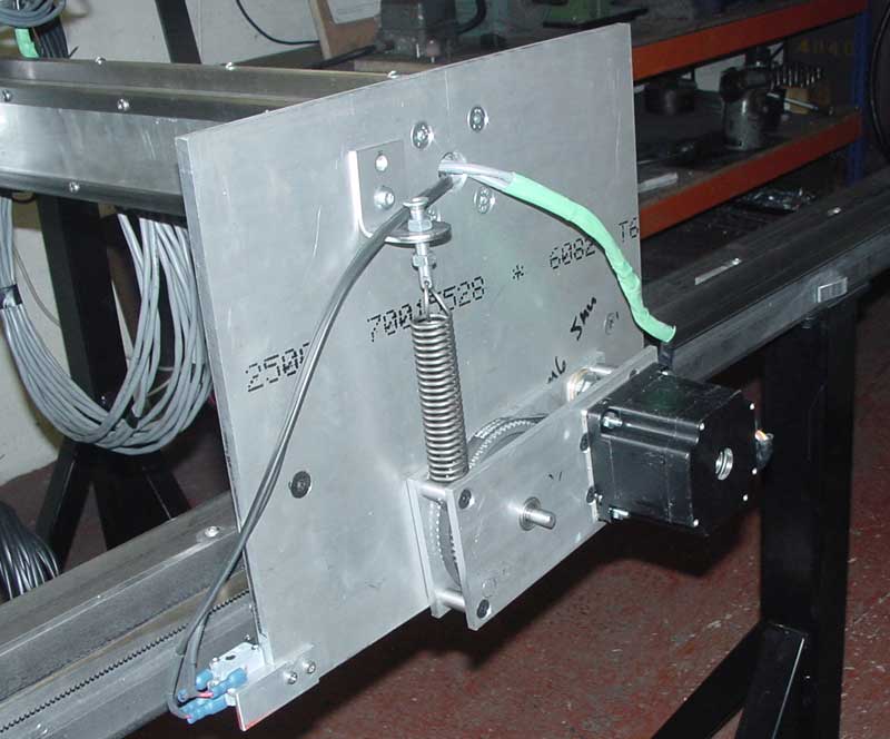

    Hi
    Looks fun, are the Y (long travel) motors going to be sprung into mesh or fixed?
    If sprung Im not too sure if some bearings running on the bottom face would be a good idea to stop the machine tipping under hard accel / decel.
    Keep up the good work
    cheers
    Mike
    www.techservcnc.com
    Sprung into rack. I wandered wether bearings running underneath might be needed. Would they "confuse" the sprung tension on the pinion ? if you know what i mean. Mechmate routers do not have the bearings underneath but then their gantry looks pretty heavy.

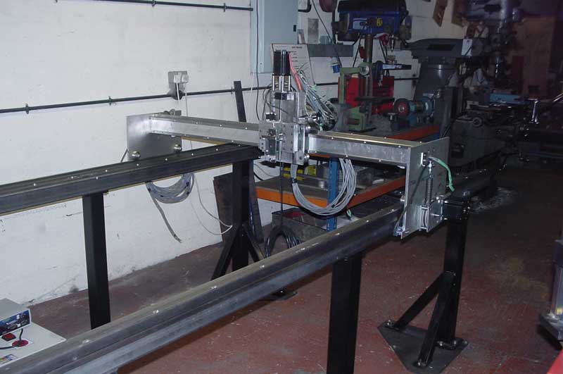

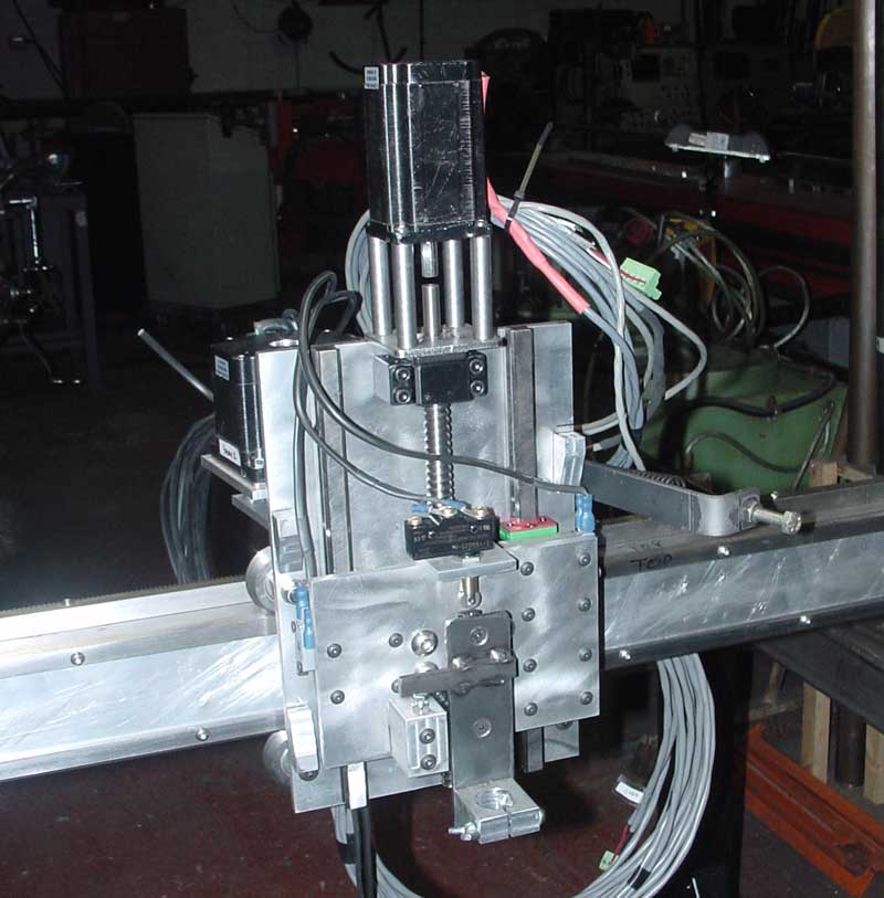

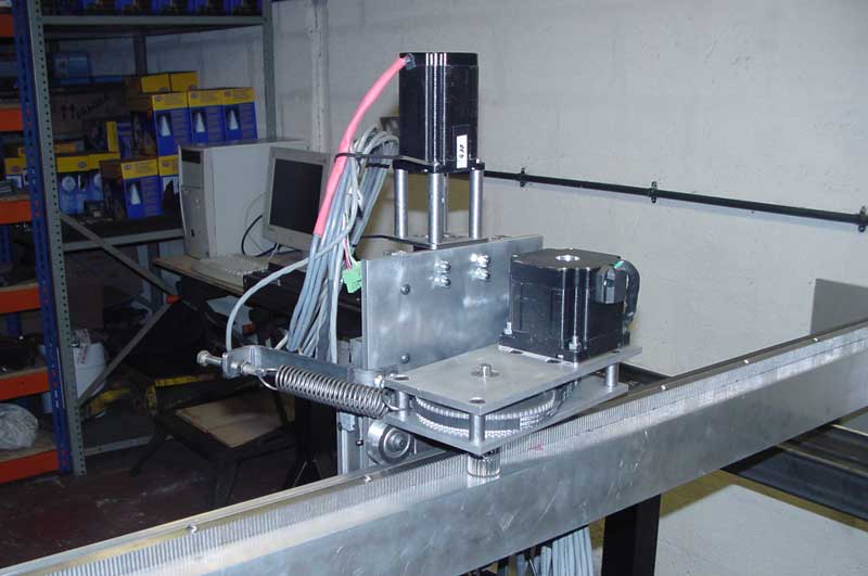

    Well here it is..
    Spent 3 months building this, now ready to plug in.
    Will be building a water table to fit under underneath.
    Using a plaspak 1a system from candcnc which i managed to pick up on ebay as an uncompleted project.
    Now I have the big Mach 3 learning curve to conquer.
    Sure hope it all works!

    Looks good mate, well done on getting this far!
    I'm liking the sprung tension on the pinion, never seen that before.
    Tom's Avatar
    That's looking a good 3 month work ads...! When you've got it all tuned up it'll be a nice robust machine.
    Just a Q: What are the Vbearings running on on X and Y? It is the proper machined rail, or have you found some alternative (angle iron, or something)? And did you use eccentric bushes to pull the bearings onto the rails, or some other method? Just curious because my next machine will probably be using v bearings.
    Anyway, looking good!
    X is running on home ground rail (an angle grinder on a skate) check out Mechmate forum they build some fantastic routers.
    Y is running proper ground rail.
    yep, used v bearings on eccentric bushes from superior bearings in USA.
    Had motors running today, 80% satisfied. Running out of time now as I wont be allow to play with over Christmas!

    Cutting metal now. Big learning curve here!
    Have already sold some cut plates off the machine.
    The x axis rails are ground angle iron, have a look at the mechmate for info on this. Don't dismiss the idea as mad and bound to be inaccurate! Have a look at what the lads build on the mechmate.com. The Y rails are no2 ground v rail from Eurobearings. The V rails from superior bearing in USA. The geared racks from WMH bearings Tamworth.
    Al
