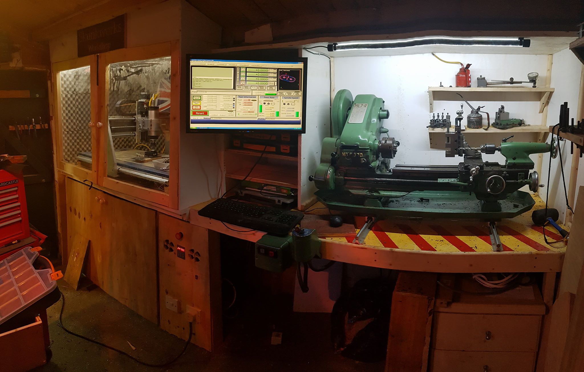

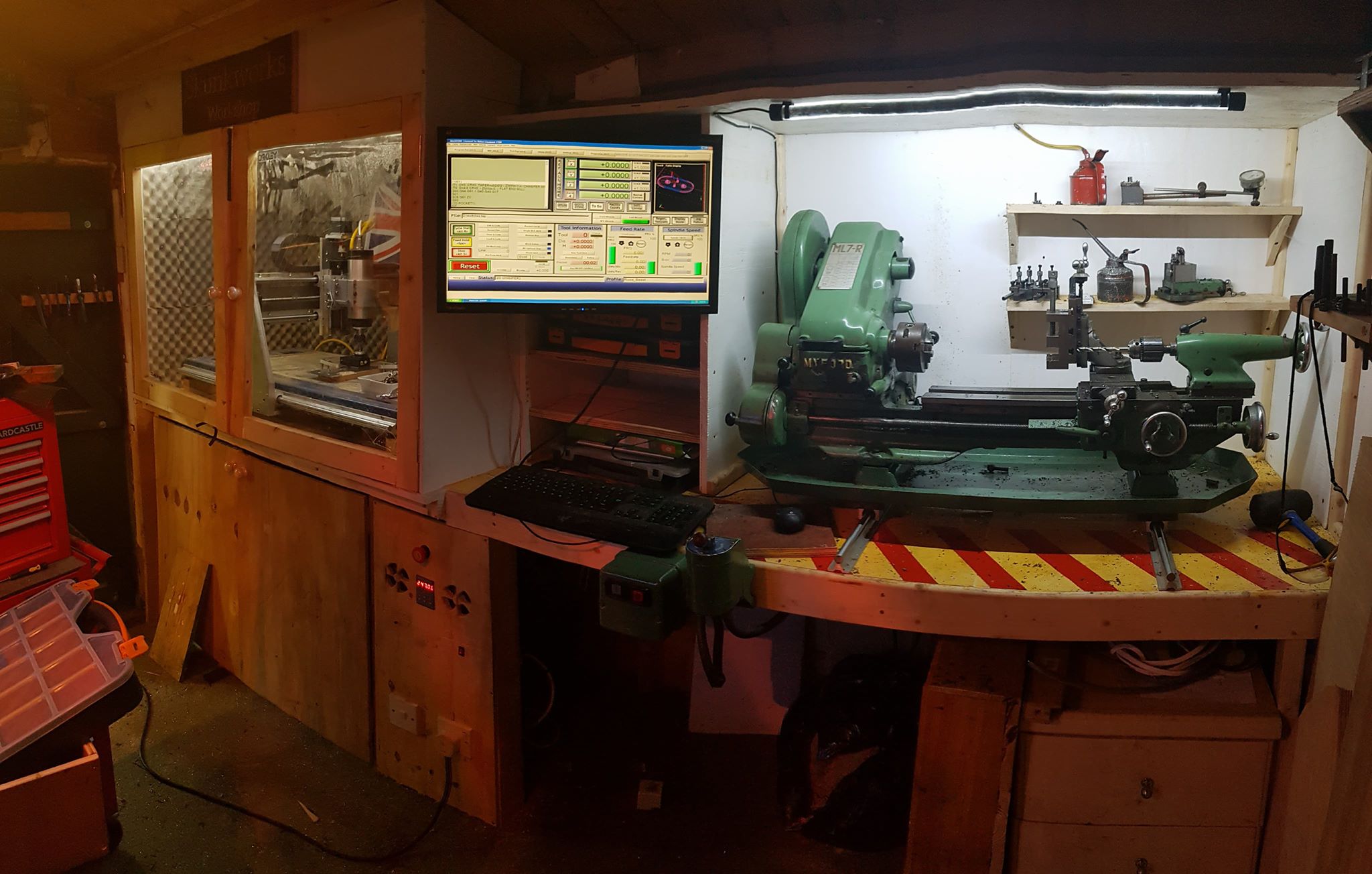

    And here is an image of my current setup, I've had such bad luck and became depressed with the issues and never went further with my great plans of wiring in all the sensors, such as temperatures and max/min travel with lovely steampunk style gauges to let me know the values on a machined panel. I will have to move the lathe, again
