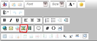

    PS
    if you have a JPEG photo on your desktop to add to a post
    when adding a reply or editing a reply
    click the symbol marked in red
Name:	add photos.jpg
    on the next page click basic uploader
    to add files from you computer
    next page click browse
    then type the JPEG file name in the box
