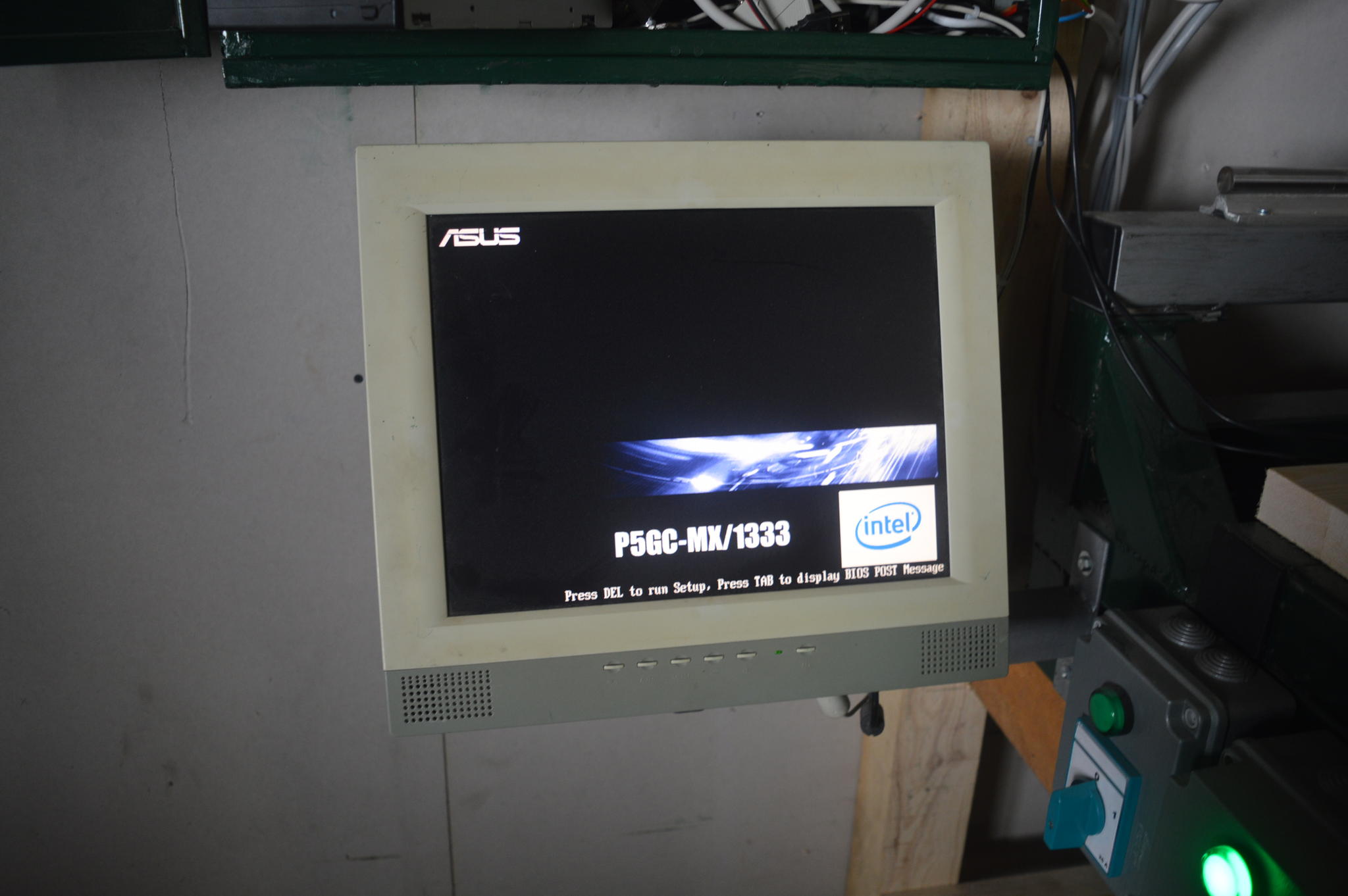

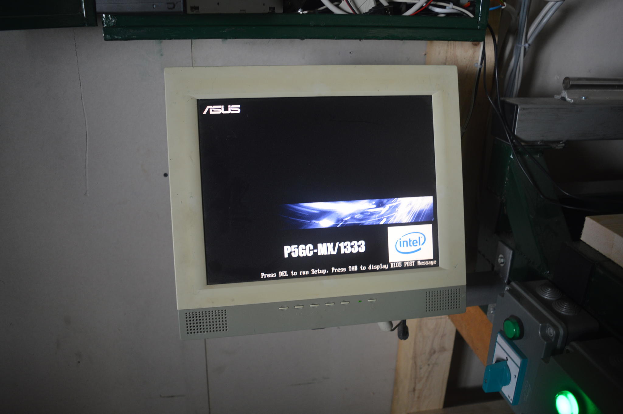

    I think I just ˇˇresolvedˇˇ the desktop pc, as I did try installing windows xp sp3 x86 on a separate partition, and it failed at first attempt, and then it seemed to go through, and now the pc would not load anymore. I can.t even get into Bios. It loads the first screen, and it stays like this forever. I can press Del for setup and it says it is entering setup but nothing happens, and with Tab the same thing, and f8 for Bbs popup which does nothing as well.
    I installed really hard windows 7 as well a while ago. It just failed so many times, but I could repeat the process. Now I can.t. Only dvds seems to work, no usb or sd.

    which is the boot drive ?
    try booting the PC with no drives connected
    and see if you can get into the bios
    If you can
    try connecting the DVD drive and see if it will boot from the windows installation disk
    if that works
    next try adding the IDE drive
    and then the crucial solid state drive
    if all 3 drives are connected to the IDE ribbon cables
    you can only connect one master and one slave to each cable
    it looks like all three drives are set to master !
    if you have two master devices on one IDE ribbon cable
    that could stop the motherboard from booting and take a very long time to respond to attempts to boot in to the bios
    do you have 3 IDE ports ?
    John

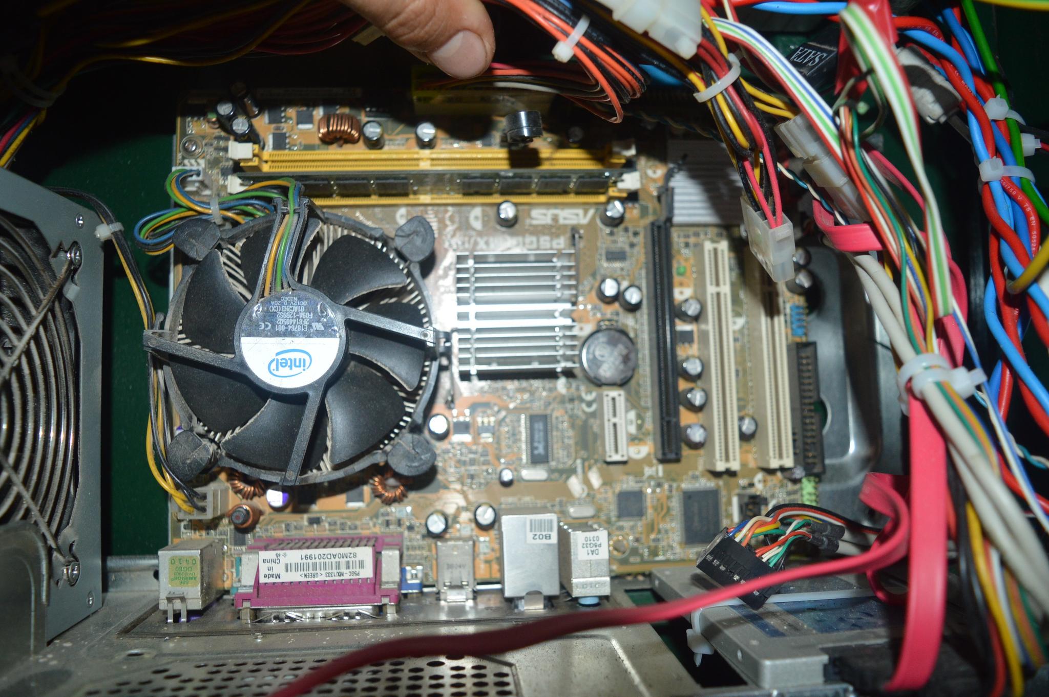

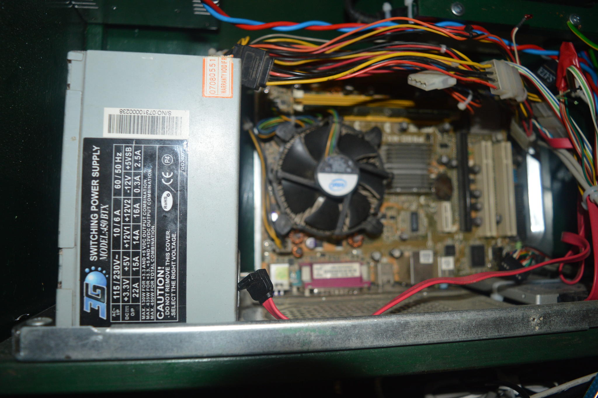

    Here.s a photo with the motherboard.
  8. #118
    That Mobo has 4 SATA and 1 IDE port. The IDE port will support two devices and I would recommend you use Cable Select on the IDE drives look at this ---- https://support.hp.com/gb-en/document/bph03792 With Cable select the master is the first drive i.e. on the end cable connector and the slave is on the middle connector
    SATA does not have that option and I see that the small drive cable tied to the box is SATA.
    If you can set up XP on a separate drive, I would recommend it and don't mess about with dual booting. It looks as though you have a corrupt MBR (Master Boot Record).
    The Mobo manual is here if you need it https://www.dropbox.com/s/vmr7ucg4kw..._1333.pdf?dl=0

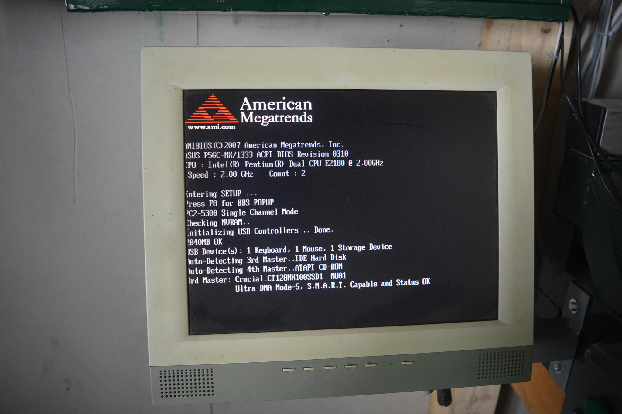

  9. #119
    this photo lead me to think your PC had IDE drives
    connected by a 40 way ribbon cable
Name:	photo of screen   showing IDE hard drive found.jpg
    your later photo of the motherboard shows the newer (red) SATA cable connected to the solid state drive
Name:	photo showing MB and SATA cable !.jpg
    as your mother board is the E3363_P5GC-MX_1333
    it only has SATA ports
    so you can ignore my comment about only having
    a master & a slave device connected to a 40 way ribbon cable
    just test the motherboard with no drives
    then add one drive at a time to see if you have a faulty drive
    stopping the board from booting
    John

  10. #120
    Quote Originally Posted by john swift View Post
    Although the photo does not make it clear, that Motherboard has an Ultra DMA IDE port and from the BIOS start-up screen, it looks as though Andrei has an 80way cable with a HDD and a CD-Rom connected, both plugged up on the jumpers as Masters. As I said CS (cable select) is a safer way to go. If XP has been installed on the SSD, then I would unplug the IDE HDD and see if it boots up. Although you may have to alter boot priority in the BIOS settings.
