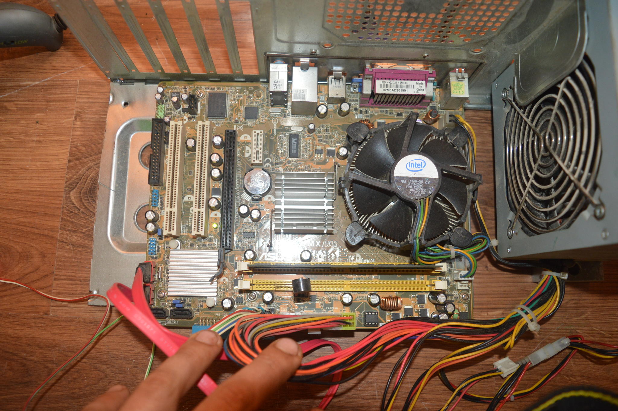

    Hi.
    Here.s another photo with the Mobo. Maybe it clarifies some things.

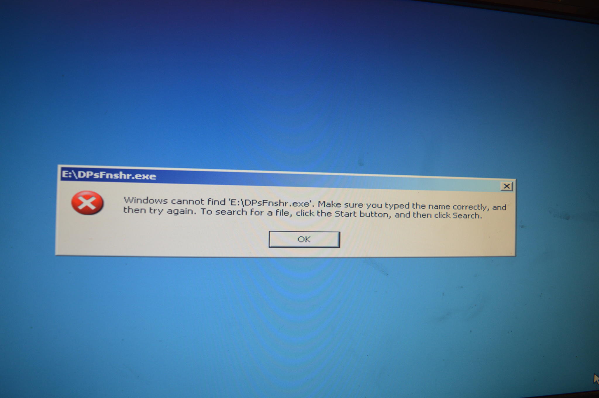

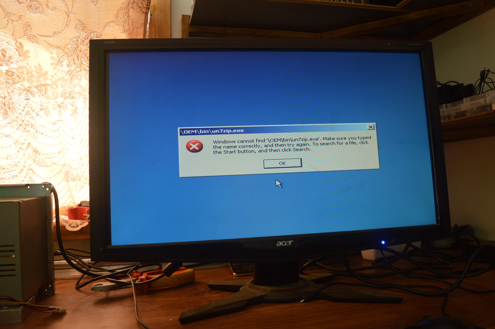

    It failed the first time, but went ok. ish the second time. After installing everything, I just got a black screen with Error loading operating system.

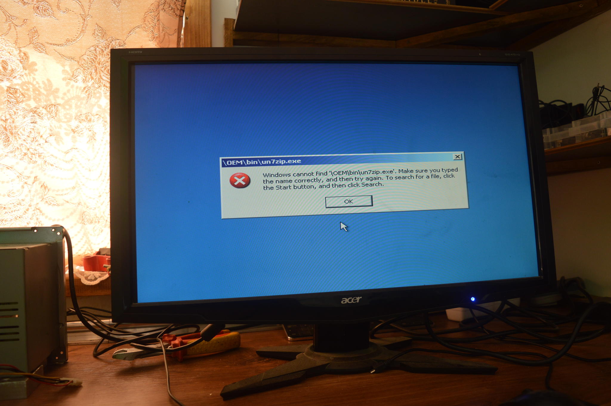

    So I.ve burned anothed dvd with Recovery Essentials Windows XP and ran that, and applied an automated fix and I could start the PC.

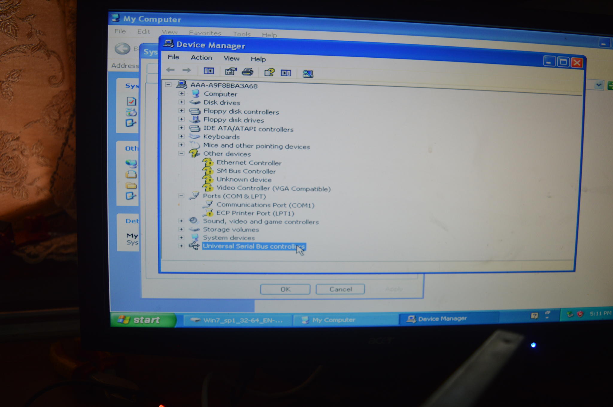

    I.ve got this two errors in the process and I have no ideea what they mean.

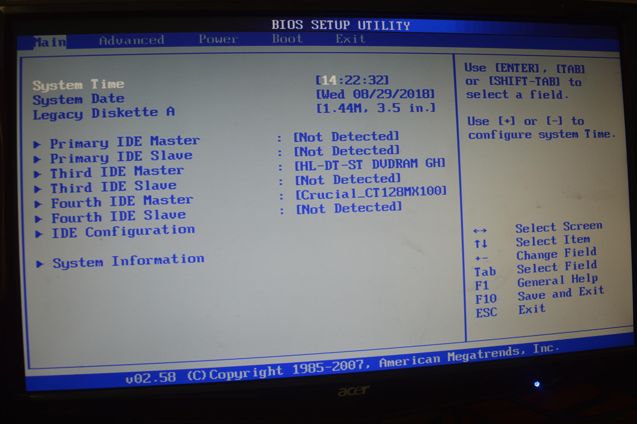

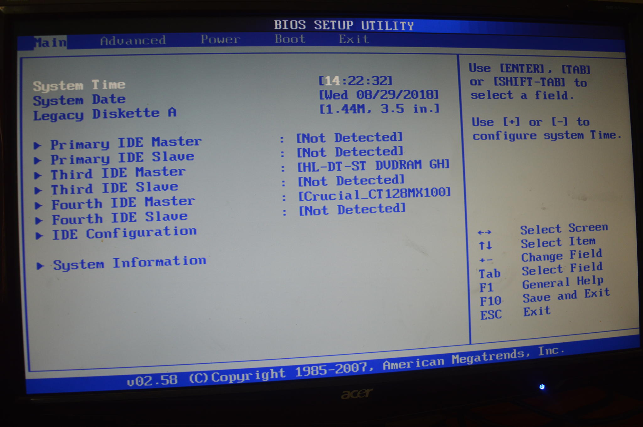

    Regarding the IDe settings, here.s a photo with the Bios

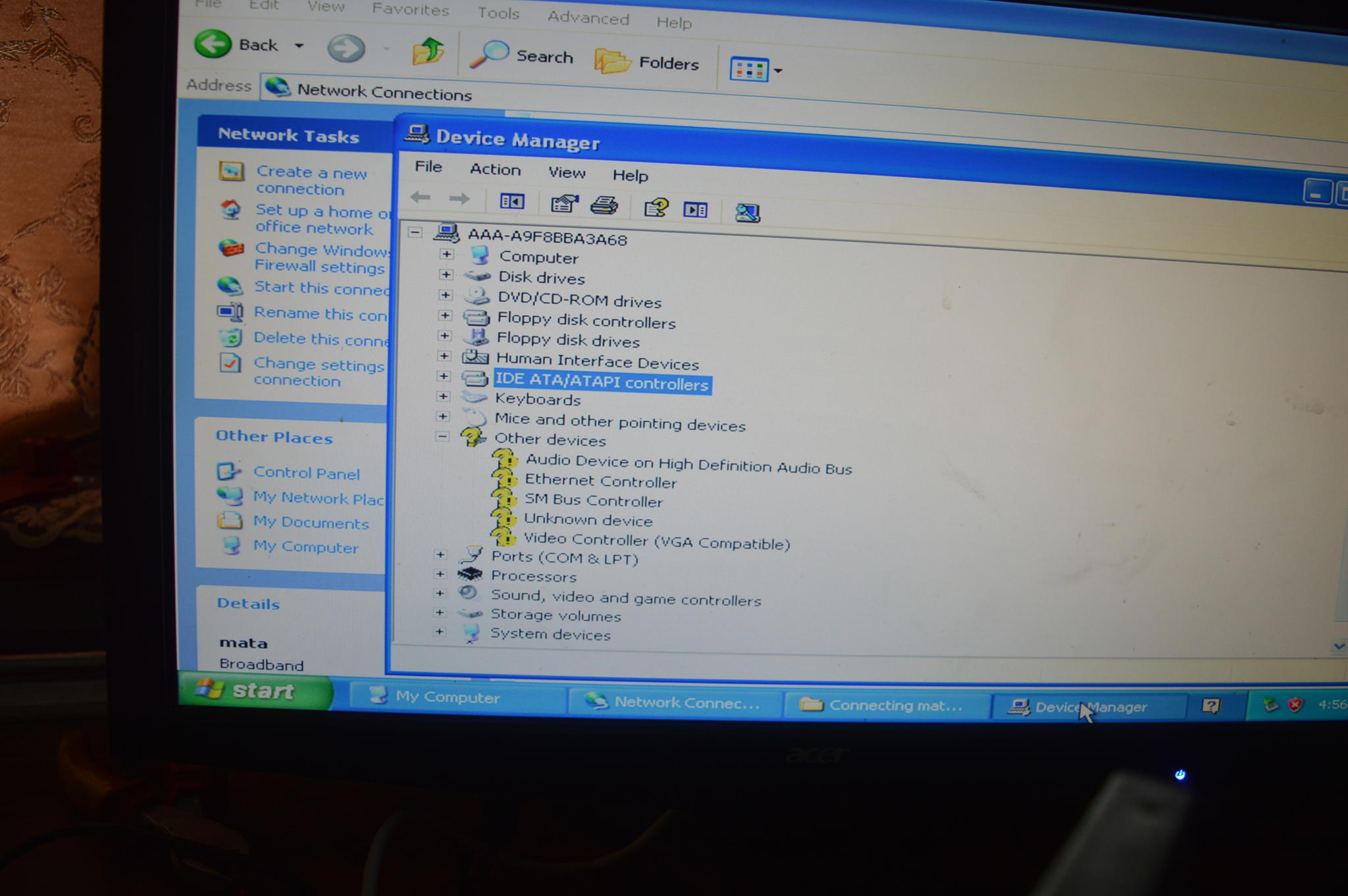

    I.m searching now for some drivers, as in XP device manager, under Other Devices, I don.t have any driver.
    I.ve found a cd with xp drivers for win xp, but there are so many, so I need to figure out which ones are the right one. For example, in LAN drivers I.ve got Atheros, Broadcom, Intel, JMicron, Marvell, Realtek, VIA.
    I did this things many years ago, so I guess they.ll come back to me.
    At least, now I have available the Standard PC option in device manager, so I can change the energy management of this unit. We.ll see if it works when I.ll get there.

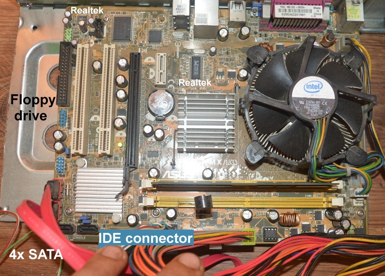

  2. #122
    looking at your photo
Name:	ASUS M B.jpg
    you can see two RealTek IC's
    I expect the larger one near to the heatsink will contain the LAN
    the small one in the top left corner is the onboard sound chip
    on the mother board
    hidden under the heatsinks are the
    Intel 945GC Northbridge
    and Intel ICH7 Southbridge
    John
    Last edited by john swift; 29-08-2018 at 01:45 PM. Reason: add ref to North & South bridge IC's
  3. #123
    https://www.asus.com/uk/supportonly/...Desk_Download/
    Try here
    The LAN chip is above the battery and PCI ex1 socket. If you can read the make (I suspect it is Atheros) that will help you determine the LAN driver. Once you have the LAN drivers installed you can get onto t'Interweb and get other drivers installed.
    In Device Manager/Hardware I usually check for yellow exclamation marks or question marks, but once I get to a state where everything seems to work, I lose interest in sorting out problems which do not affect me.

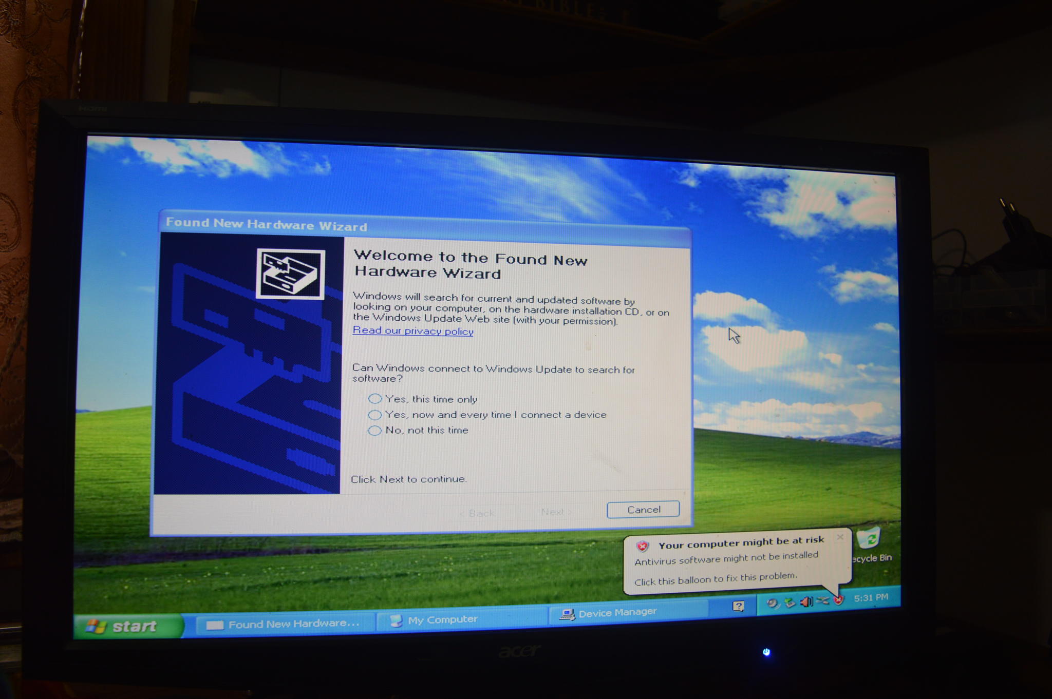

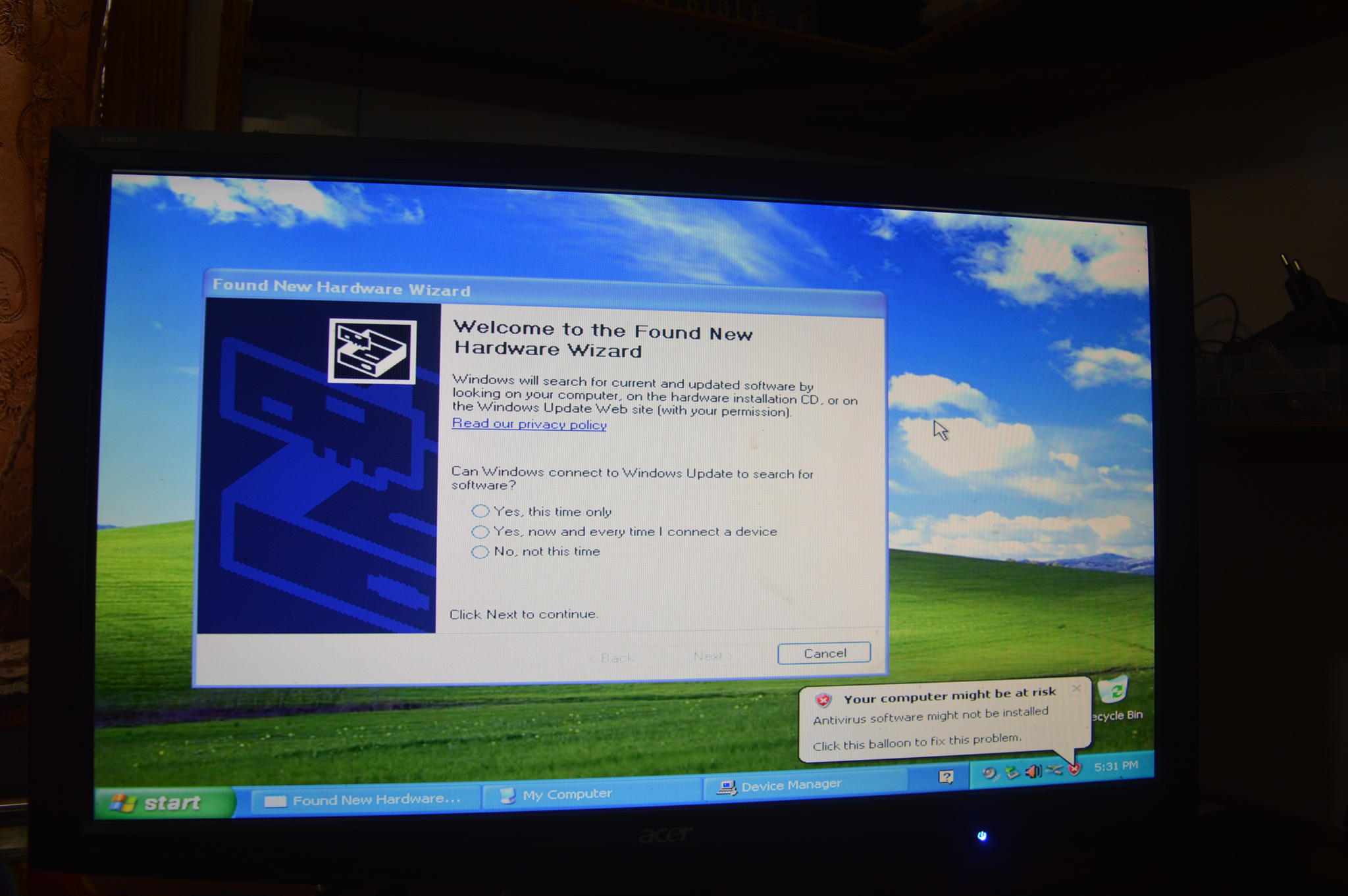

    Changing from ACPI to Standard Pc brings up this Found New Hardware message. Also windows fails to load first time, so it show Start Windows Normally and doing this, works just fine.
    Also in device manager things change.
    Changing back to ACPI makes the thing go away. The massage and failure to load windows.
    This drivers from the link provided confuse me a lot, as downloading the LAN driver for example I get inside the folder many other things, PXE, RPL, RTEGROM.206 and many others inside these as well.
    In the ones I have, in the Atheros folder, I have Atheros (AR8121, 8113, 8114... and Atheros (L1 Gigabit Ethernet 10 100 1000...
    I.m thinking of installing all of them until one works. It did not seem to be a problem in my distant past.
    Anyway, for people who do this regularly might be easy and fast, but for me it.s not. It took me more than half a day so far. Tedious thing...awwff. Long live Windows 10!
