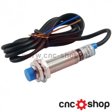

  2. #202
    NPN NO inductive proximity senzor, 4mm detection distance, 6-36VDC,300mA,3 wire (brown,blue,black)

    Quote Originally Posted by Radu_Andrei View Post
    Hi again.
    Shortly after the the 3 weeks old conversation, I received 3 inductive switches, which I.ll install next week.
    I like Rob.s approach of also keeping some mechanical switches in place next to the homing ones, but I.m somewhat unsure what.s the best way to wire all this.
    I.ve only got 5 pins on the Bob, one being used for the probe. So 4 pins for the remaining Estop, 6 mechanical limit switches (2 for each axis), 3 inductive homing switches (3wires).
    So for example (let.s say P15 is the probe)
    1. Combine all limits and estop in let.s say P10 and have P11,12,13 for x,y,z home switches.
    2. Combine all limits in P10 and all homes in P11, Estop in either P12 or 13
    3. Combine the limits and home of each axis in one pin
    So what the best wiring option and why?
    I have all the limit switches and estop wired in series (NC) to the main contactor that powers everything except the breakout board. One signal wire goes through a spare contact of the contactor to the breakout board to tell mach3 to stop the g-code.
    The homing sensors are connected to the same BoB input in parallel as I don't use simultaneous axis homing but need the spare inputs (actually I use one more input on X as I have dual motors and need to square the gantry). The homing sensors are configured as home and limit in mach3.

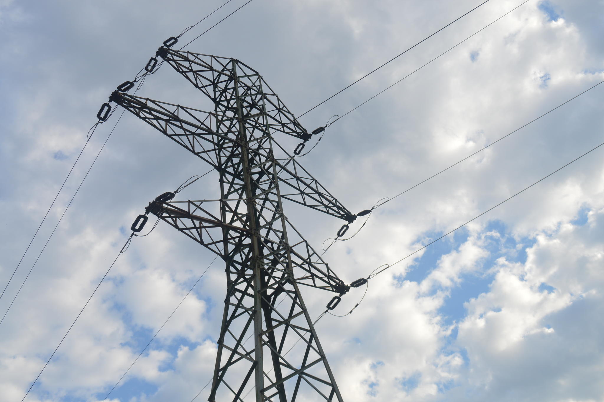

    I have read now what problems you had with the grounding and EMF. Are you not afraid to install the homing sensors in your system?
    Please do not wire the limit switches as I did! Better wire them in series to a relay coil and from the relay to BoB estop and the stepper drives enable pin if they have it.
    If I were in your place I would try to convert all the control circuit to 24V if possible. 24V is the industry standard as it is more reliable and resistant to noise and EMF than lower voltages.
    How far is your workshop from the high voltage power lines, measured horizontally?
    ps. Our government deserves more than an estop, I wish them many years in jail, and I hope those times will come.

    A lot of the noise problem was due to improper grounding, which was my fault, but thanks to the patience of the people on this forum, I managed to solve that and many other issues.
    I was considering to run the limit swithes on 24v or at least 12v, but they seem to work fine, from the low voltage perspective. They however are very cheap lever switches and tend to have some parts wobble or come loose. I will upgrade to some profesional ones soon in the future.
    My workshop is right next to the high voltage power lines. Like 3 meters away. The building existed before the high voltage tower was put in place. I asked a few guys at the City Hall about this issue, but they do not seem to have a problem or an interest in that.
    I.m a bit concerned about some aspects of the cnc build, but not afraid. Crashing it, does not seem a big deal in theory, with single drive for each axis.
    And it would not be the first time I mess up something in this project. Doing the math, I think I spent around 2500 euro for this project until this point. I bought the components bit by bit, during a few years, with the intent of building it someday. But from this amount, 5-600 euros was the tax for stupidity, representing materials or components, which from lack or knowledge or impatience etc, I ruined. But for the experince aquired, it worth every penny. :)
    What I am somewhat afraid, is that, in order to reach a certain profitability with this kind of machine, you need a decent cutting speed, and I might not be able to get that properly. Perhaps I should have bought higher quality components, and make the cnc smaller and lighter. Who knows. I have a few components left from this build so maybe in the future I.ll build a smaller version.
    You are 3 meters away from the double power lines in the picture above? No way!!! There are regulations for a protection corridor of around 30-50 meters along the high voltage power lines. I hope you are not living near... For health reasons it is recommended a distance of 150-300 meters from the HV power lines.
    Maybe those power lines are used only occasionally and coincides with the time your CNC starts going crazy. Are you hearing any hum under those lines?
