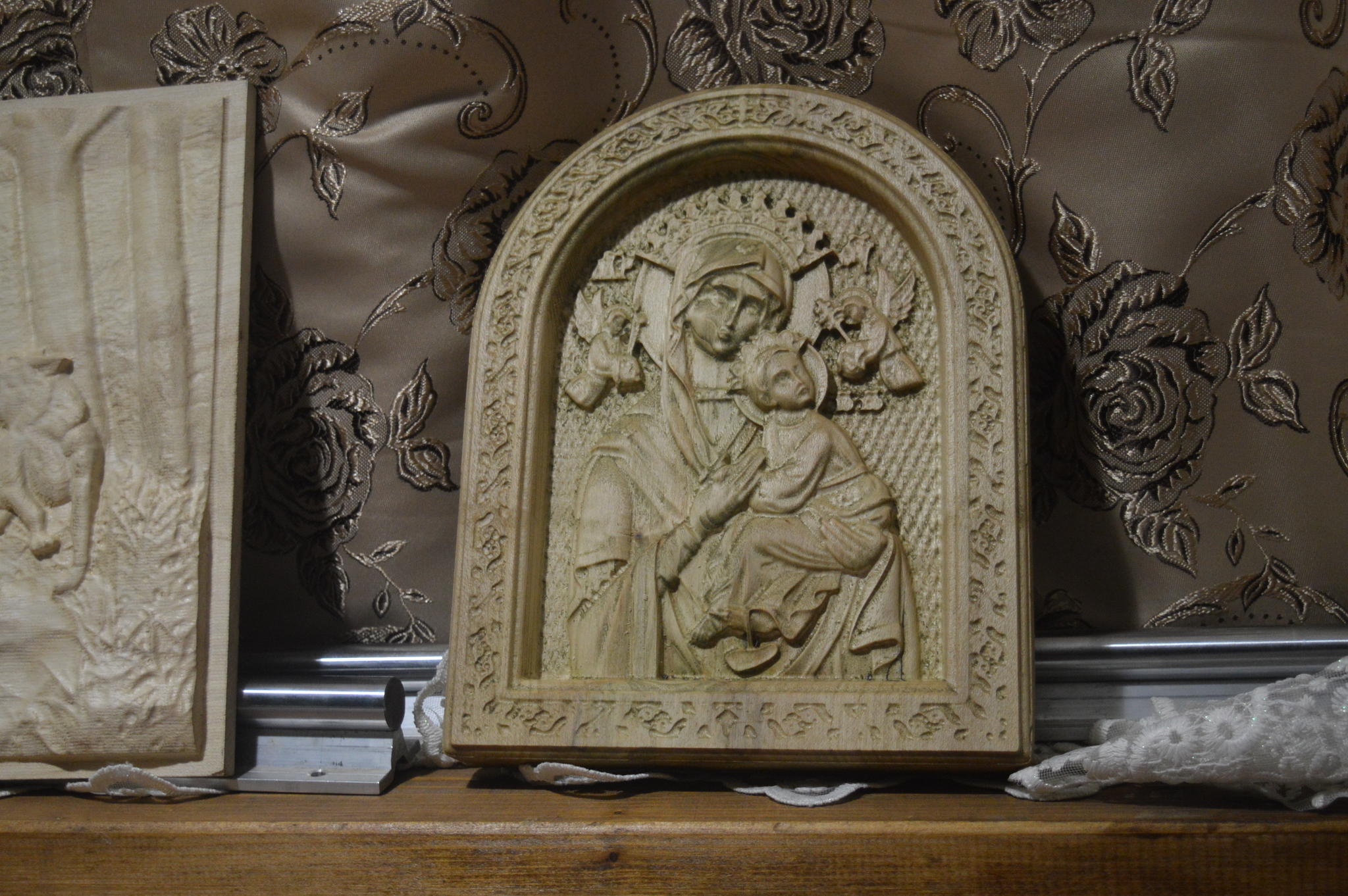

    Another thing which is a bit unclear, is why in this picture Click image for larger version.
ID:	25223, although the wood went through the thicknesser, and measuring it with the calipers , it.s equal on both sides of the board, if you look closely at the frame, the upper left side got enough detail and all the rest, especially the lower right side lost a lot of it.
    I did not run a gcode facing program as I assume the thicknesser is quite reliable in delivering flat boards of solid wood. This is the reason I stopped production for the moment, as the result are bad.
