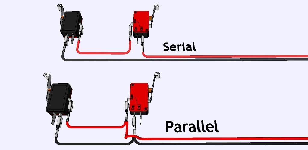

    As for the second issue, with the limit switches, any idea what I.m doing wrong?
    All 6 limits are wired in pairs of two, in series like in the photo, NC, where one wire goes into a numbered pin, and the other into the ground pin. P10 to 12 being used in this case for limits. How should I set this in mach3?

    Ok I would keep all the questions in one thread as it helps to see the history.
    Re the twin screws I use two motors with out issue. I think it is about half and half ie some use two and others one motor. There are pro's and con's for both.
    Do you have homing switches ? generally on the Z axis it only needs a switch at the top. I would set that up as a combined home and limit switch .
    You can wire all the limits in series to one pin. ( set that up in ports and pins in Mach) and also set up soft limits as the machine when homed should never hit a limit.
    There are plenty of vids on the net:- https://www.youtube.com/watch?v=ma7lMocQbv0 if that helps
  7. #17
    Quote Originally Posted by Radu_Andrei View Post
    In Mach3, Go into Config, - Ports and Pins, - Input Signals, - Automated Setup of Inputs and follow the instructions.
    If you don't get a response from the change of state of the switch, then you have a wiring problem. If you get a response it sets the input for you.

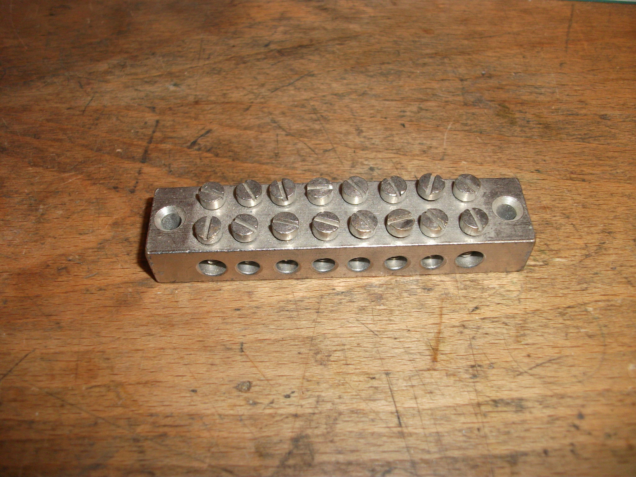

    1. a: Pigtailing - no problem, just remember shields should only be earthed at one end or you may get earth currents to make your shield as the primary in a transformer with the secondaries as your signal wires.
    1. b: Single earth point in control box, all earths and shields and mains earth to it. Topographically, earth connections are a star, however spur connection is allowed as long as it is a single line spur chain earthed at one end only at the star point.
    2. Yes.
    3. The VFD is usually the main culprit in creating electrical noise and it is common practice to keep it out of the main enclosure (which should be an earthed, shielded box I.E. not plastic).
    4. DC voltage supply lines are normally no problem in a steady state, switching transients can be a nuisance, but these would only be when there is an inductive load, like a pump motor, so these are best shielded. Homes and limit switches are normally in a steady state, but it wouldn't hurt to shield them against stray EM crap.
    5 and 6 - whatever !
    7. I hate ferrites and their nasty little cousins - slugs. Design out the problem if you can.
    8. Noise from the BoB, not usually (only when it gets drunk on a Saturday night) but seriously - I refer you back to 3 above.
    You should test each earth connection by continuity checking from the central earth point to the earthed appliance. Disconnect the appliance earth and check that the continuity between the earth point and the appliance then disappears. If it doesn't - you had a loop.
