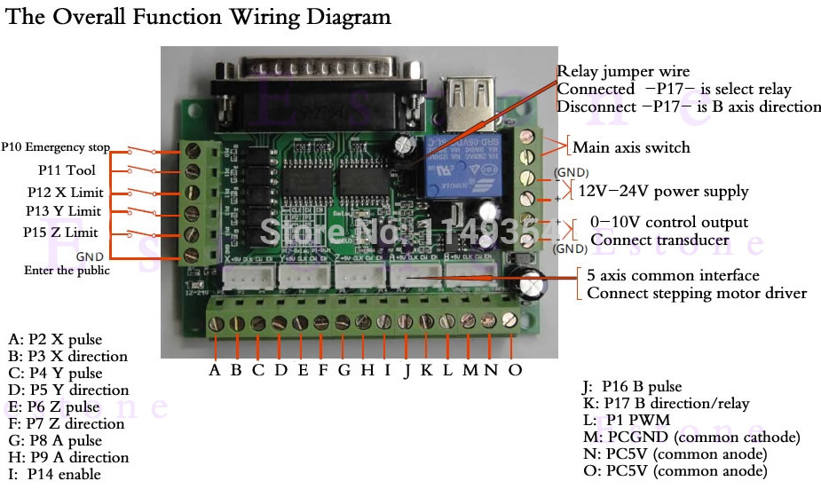

    It has the 12 v input, a light is on on the bob at the end of the input pins. It makes a subtle high pitch noise when I connect any of the input pins to the ground pin, but it does not register it in mach 3.
    All grounds are together, but now I.m testing it with a single wire.
    Pc gnd is not connected to anything.
    The only difference with this bob is that it has a P14, to which all I ran all ENBL- from the drivers.

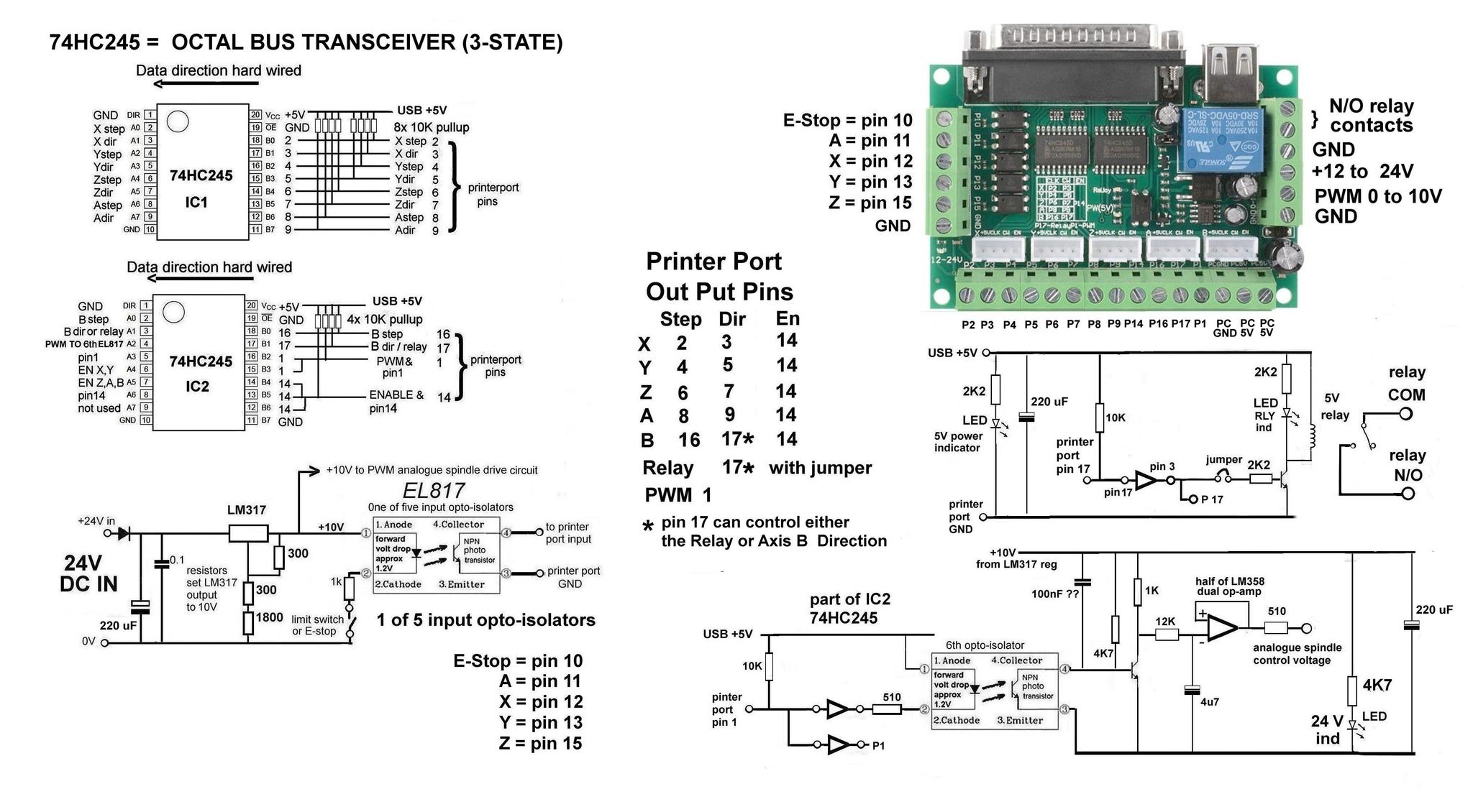

    having a quick look at the data sheet for the LM317 regulator
    the 12 to 24V DC supply needs to be a minimum of 13.5V
    the supply goes via a diode that drops about 0.6V and the LM317 regulator should have an input that's at least 3V more than the 10V output
    is the 12V supply regulated ? or is it unregulated and is more than 12V if lightly loaded
    for your initial tests you can disconnect the connection to the stepper driver enable

    Now on the other side of the bob, for spindle control via mach 3, from what I understand, the gnd pin goes to ACM, the 0-10v to V1, 1st relay pin (5th in order) to DCM, and 2nd relay pin to FOR.
    Is this correct?

    your connection to the VFD looks correct

    while the LM317's data sheet gives the minimum supply voltage as V out +3V this will be the worse case accounting for the production spread in the IC's parameters
    even if the supply is too low for the regulator to regulate the output as intended
    the fact you have a regulated 12V supply
    the voltage is likely to be near to 10V and not change too much and
    cause the calibration of analogue control voltage to the VFD to vary
