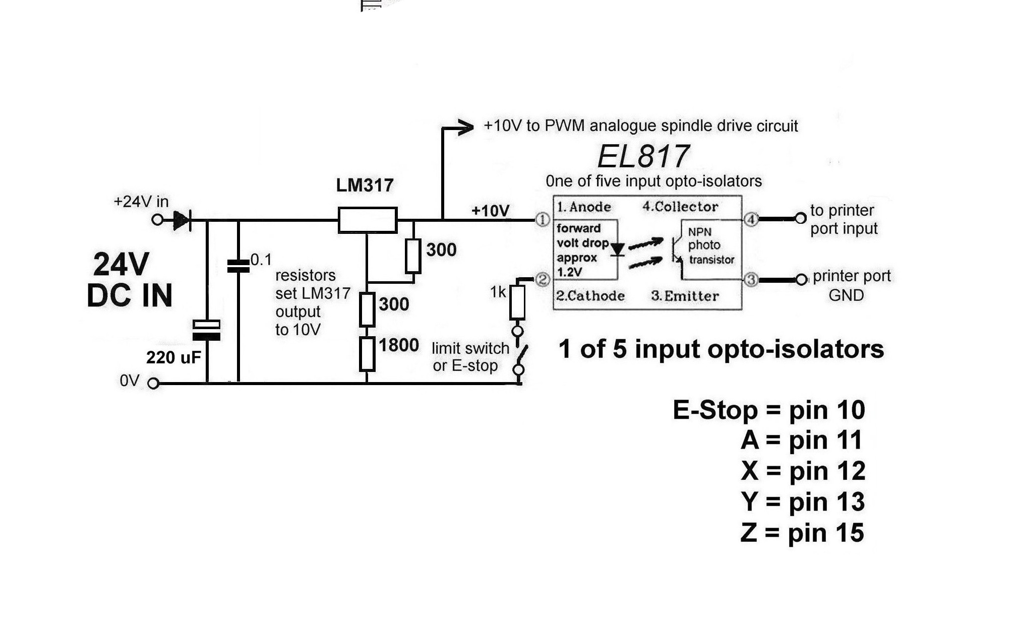

    Hi again.
    I.ve build the metal box and reorganized everything, and wired the new Bob. It seems the motor problem has gone, but will post a video soon and let you be the judge of that.
    Now, I.ve wired the Bob like in the photo attached, and I.m not getting any response from the input pins, from none. P10 to 15 are not seen in automated setup in mach 3.
    I should know the answer from the first picture from post 49, but the truth is that I don.t. :(
    What am I missing?

    If you are using the BoB in the picture, you will need the 12-24v input to work the LEDs in the output opto-isolators. It looks like you have a fault there. Also check that the GND connections are all together, except for the PC ground.
  3. #53
    the USB cable powers the two 74HC245 octal buffer IC's that connects the printer port outputs to your stepper drivers
    the 12 to 24v supply is required to power the five input opto-isolators
    & the PWM to 10V analogue converter that's controlled by pin 1
Name:	ebay CNC BOB.jpg
    when a switch grounds an input current flows through the opto-isolators LED so the NPN photo transistor is turned ON
    so the corresponding printer port input is grounded
    when the switch is tripped and opens
    the printer port pin goes high
    (set pin as active high in mach3)
Name:	ebay CNC BOB inputs.jpg
    John

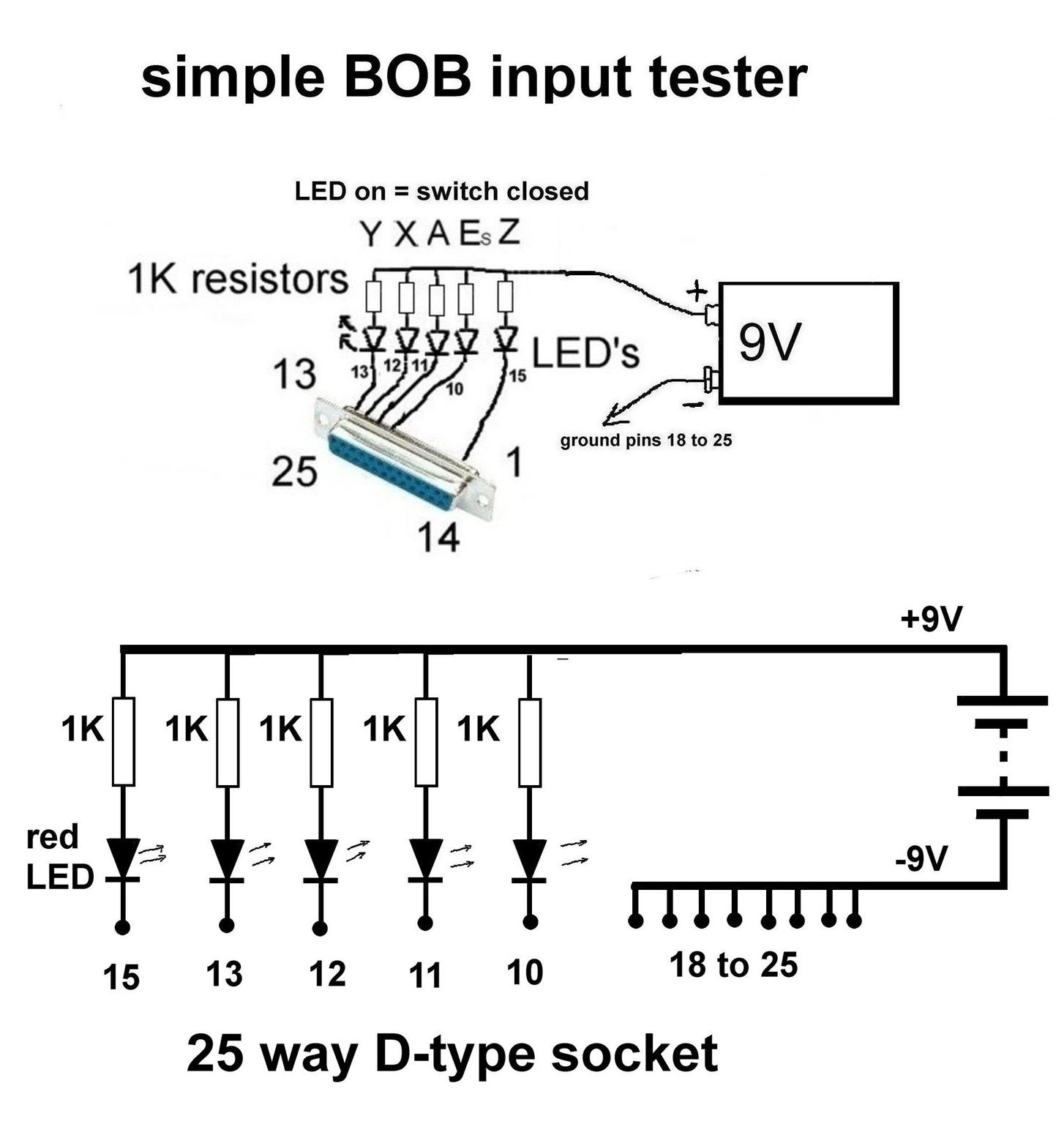

    having a quick look at the data sheet for the LM317 regulator
    the 12 to 24V DC supply needs to be a minimum of 13.5V
    the supply goes via a diode that drops about 0.6V and the LM317 regulator should have an input that's at least 3V more than the 10V output
    is the 12V supply regulated ? or is it unregulated and is more than 12V if lightly loaded
    for your initial tests you can disconnect the connection to the stepper driver enable
    John
    PS
    a simple input tester I used to test a similar BOB without using a PC (or motion controller)
Name:	simple TX14175 BOB input tester.jpg

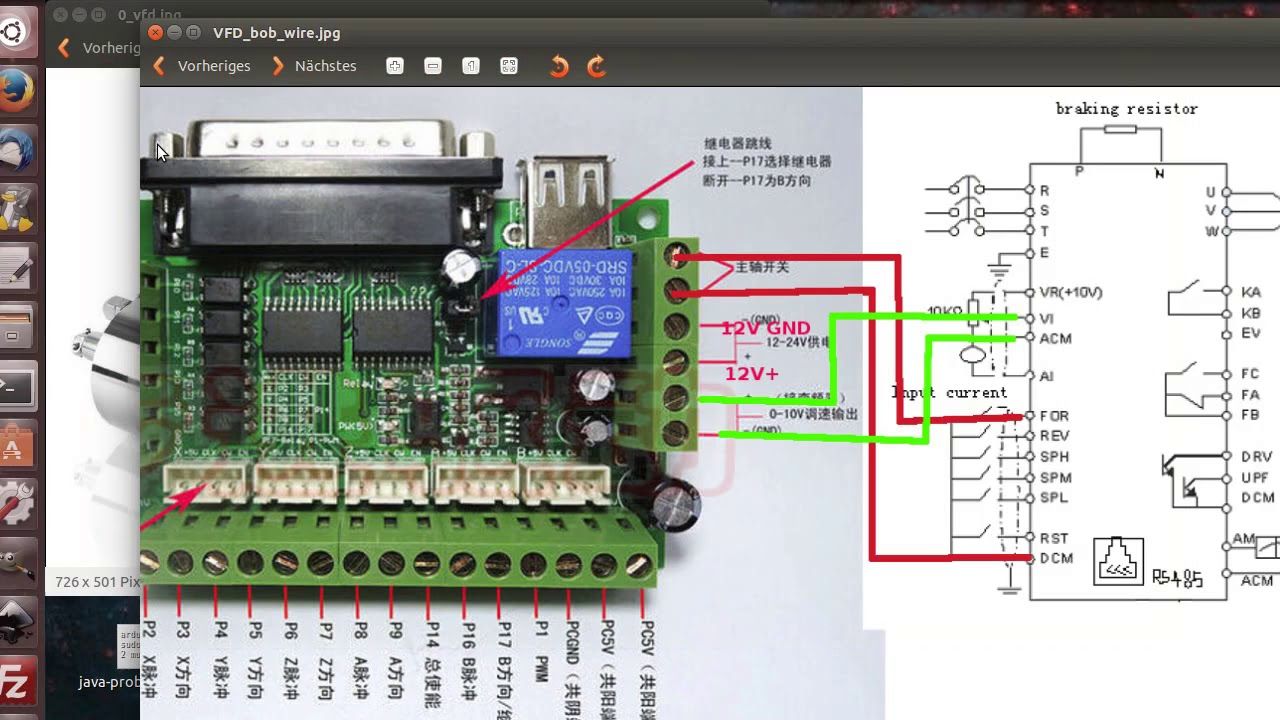

    the supply is a 12v transformer, which used to power up some car led.s strips. the multimeter reads 12.1 v. it is the one i use for the enclosure fans.
    as i fiddled with the wires, somehow it works now. probably a bad connection from the 12v supply. so Thank you!
    I looked a bit online, and the eccomerce webs in my country have plenty of 12v, but no 24 supply. Surely there might be some specialized shops somewhere.
    It works like this now. Do I ask for trouble if I don.t use a higher supply, 13.5v and above?
    Now on the other side of the bob, for spindle control via mach 3, from what I understand, the gnd pin goes to ACM, the 0-10v to V1, 1st relay pin (5th in order) to DCM, and 2nd relay pin to FOR.
    Is this correct?

    great to see you have it working even if your not 100% sure which connection you re-made during your investigation
    your connection to the VFD looks correct
