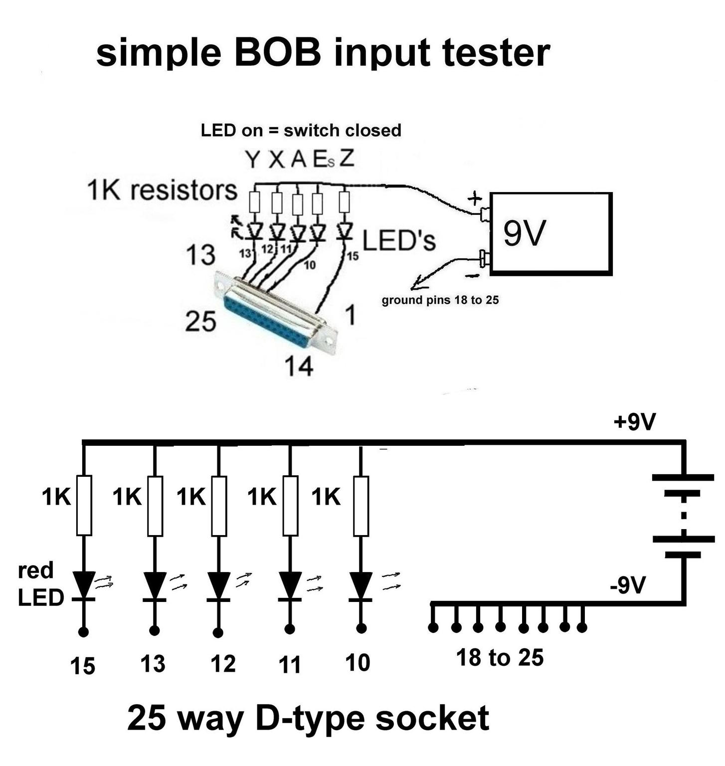

  3. #63
    Quote Originally Posted by john swift View Post
    PS
    a simple input tester I used to test a similar BOB without using a PC (or motion controller)
    Attachment 24652

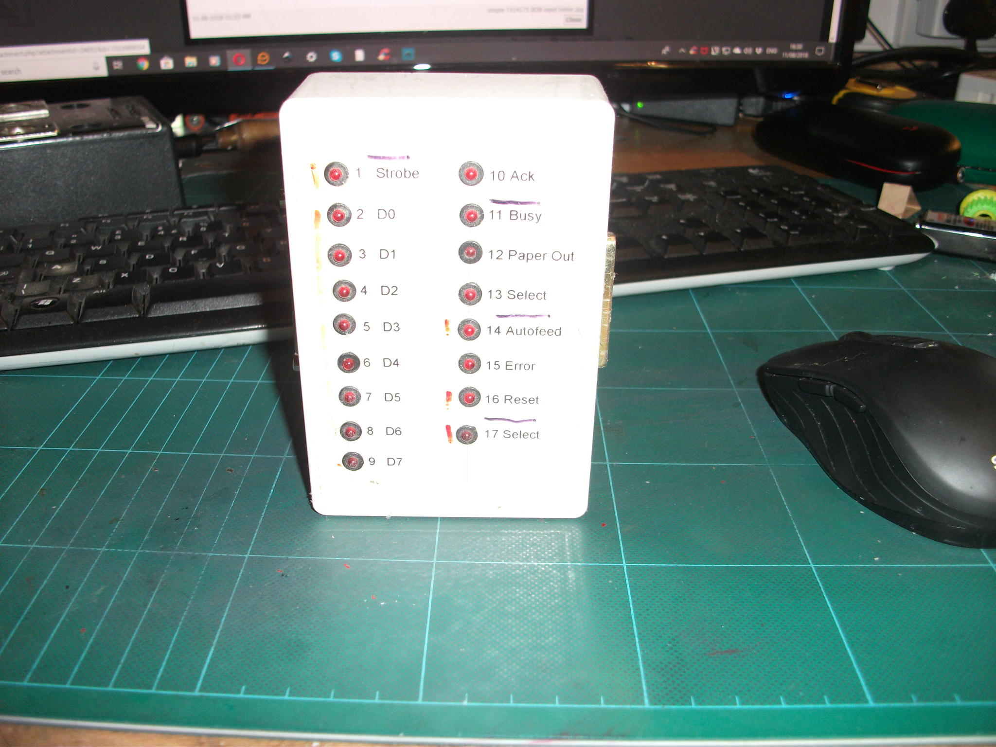

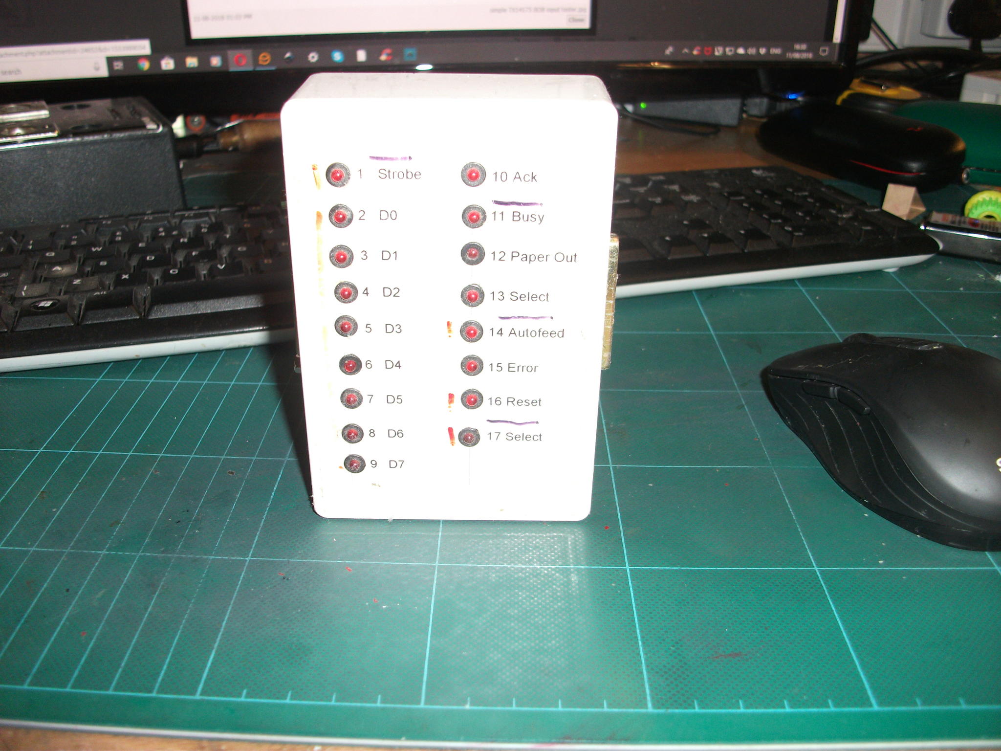

    I made Click image for larger version.
ID:	24654a pass-thru tester years ago when I was trying to work out what was happening with a printer/plotter I had. Exactly the same as that but with lower value resistors but each LED was powered by the printer or PC.
