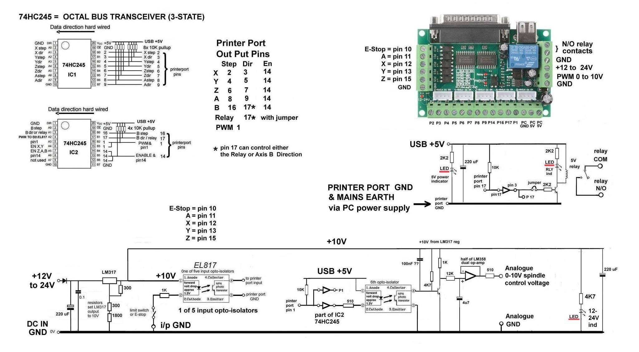

    there must be a detail we don't have to explain why you measure 26V on input P13
    which terminal did you connect the volt meters negative probe ?
Name:	ebay CNC BOB.jpg
    the printer port ground is connected to the mains supply earth / ground
    on the other side of the BOB's opto-isolated circuit
    the 5 inputs can not be more than +10V more than
    the 12-24V supply ground , input ground & analogue output ground
    (which are all connected together on the BOB)
    depending on the 12V power supply your using the 3 grounds may be at a different potential to the mains supply ground

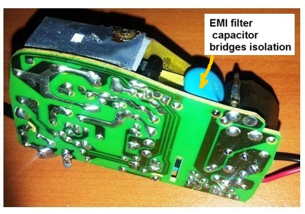

    small switch mode power supplies such as the ones used with laptops and other IT equipment don't have the negative output terminal connected to earth like PC AT or ATX supplies
    they have a small capacitor bridging the mains input & DC output !!!!
    ( the capacitor is a backwards step just to comply with EMI requirements)
    the leakage from a couple of devices is OK but several power supplies can add up to give you a shock
    John

    Perhaps we have a difference in language. By "working OK" I meant that are the inputs now working as intended , ie if you connect one of the inputs to ground does this show that it is triggered in Mach3 ?
    For the avoidance of doubt when we ask for a voltage measurement between an input and ground we mean between the input pin and -ve of the power supply (not earth star point).

    Yes, all 5 input pins are triggered in mach 3.
    The measurement regarding 26v (right now is 24v) was taken between p13 and the gnd situated right next to p15.

    P.S. measuring between -12v on the other side of the bob, and the p10 to 15, I get the same readings, measuring the +12 v and p10 to 15 I get 12v into all pins except p13 which has 16v.
    Is this the -ve fro the power supply? the - pin of the dc12v?
