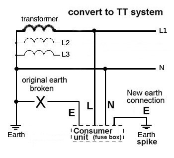

    Sure Andrei, I have this feeling that the problem is a poor earth connection outside the house. If you get a voltage on the earth wire when it rains, then that would give you a 'tingle'. Putting an earth rod in would sort that out I am sure, but whether it should be connected to your supply earth in your case is something I would take advice on as there may be a problem with leakage currents.

    the earthing problem explains a lot
    if your utility supplier will not fix the problem then
    replacing the faulty earth connection with an earth spike
    will convert your supply to a TT system and be safer than what you have now
    John

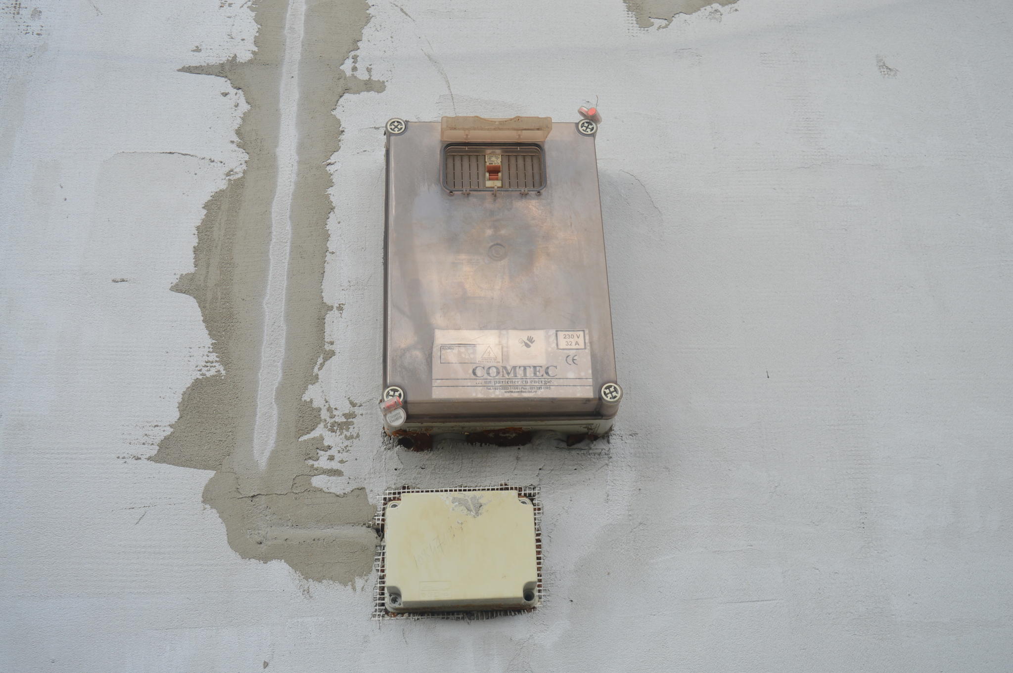

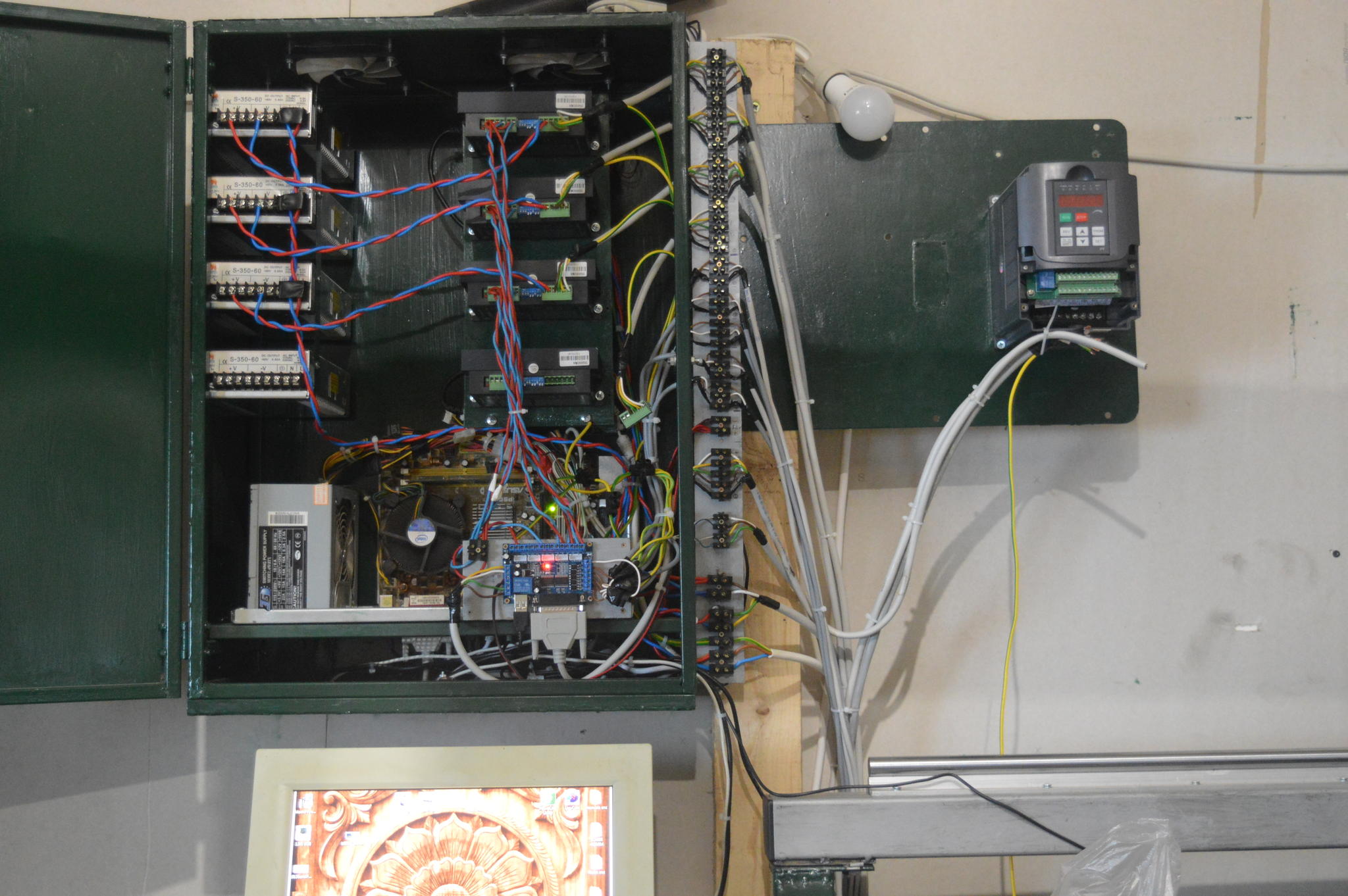

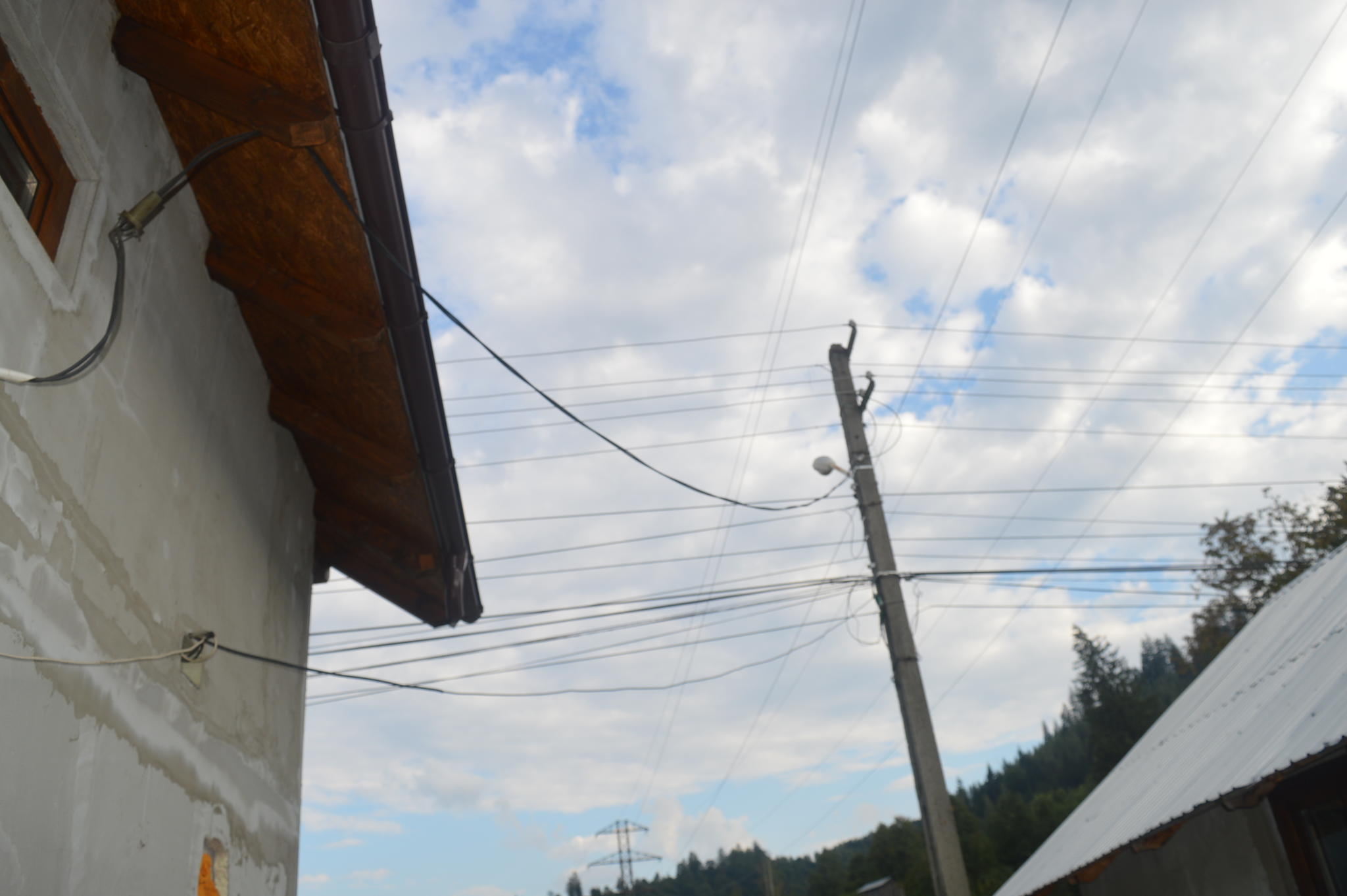

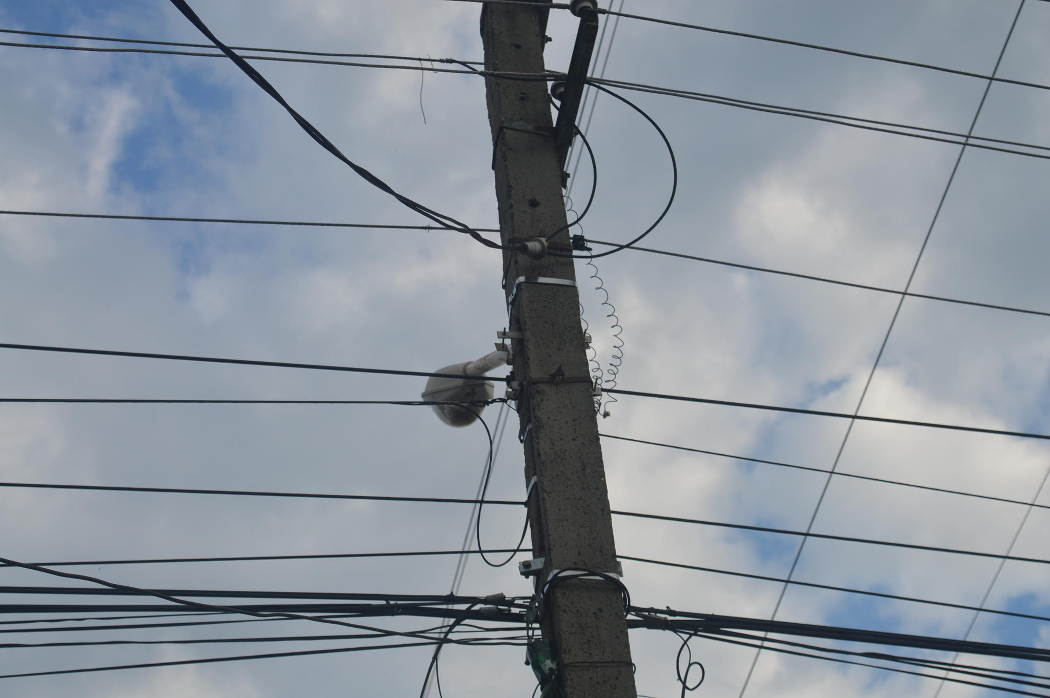

    A few pics with the house to pole supply connection, the main fuse box outside the property from which I get electricity into my workshop.
    A big high tension structure which is situated on my property, quite close to the workshop.
    It has a lightning protection thing included. Although, I have now and then some fluctuation in the supply, as some light bulbs are blinking/dimming, I never had any appliance broken or anything like that.
    Also have a cctv camera in the workshop, a few meters away from the cnc. It does not seem to be affected by the cnc. I don.t know the other way around and might be a different story when I.ll wire the vfd.
    There is also the metal control box, with some terminals in the left side, put there only because the terminals on the drivers, due to so much troubleshoot and rewiring seemed to go weak, and so any future fixing, will be done on this new ones.

    Re the earth rod For a test you could just knock a metre long metal rod into the ground and connect it to the incoming mains ground. If it works then get a copper coated rod.
