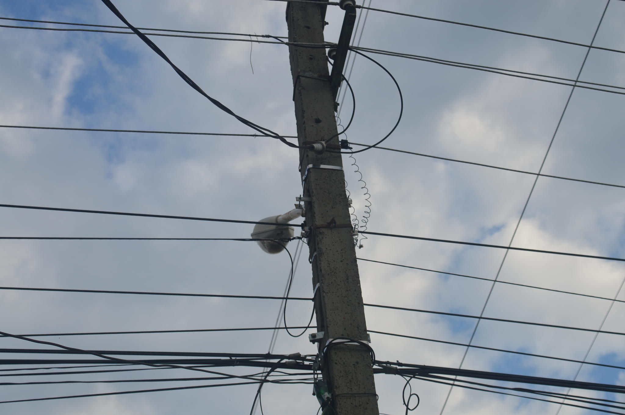

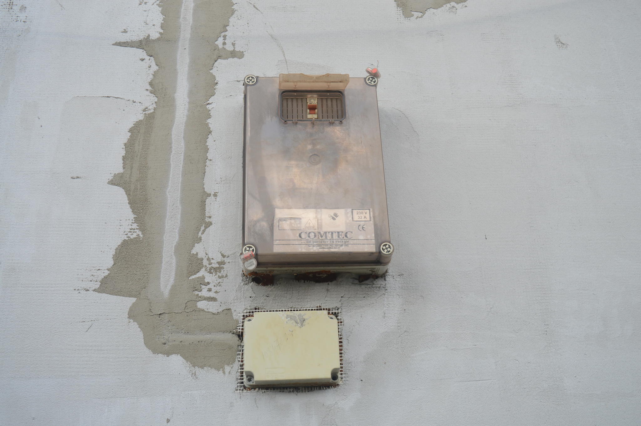

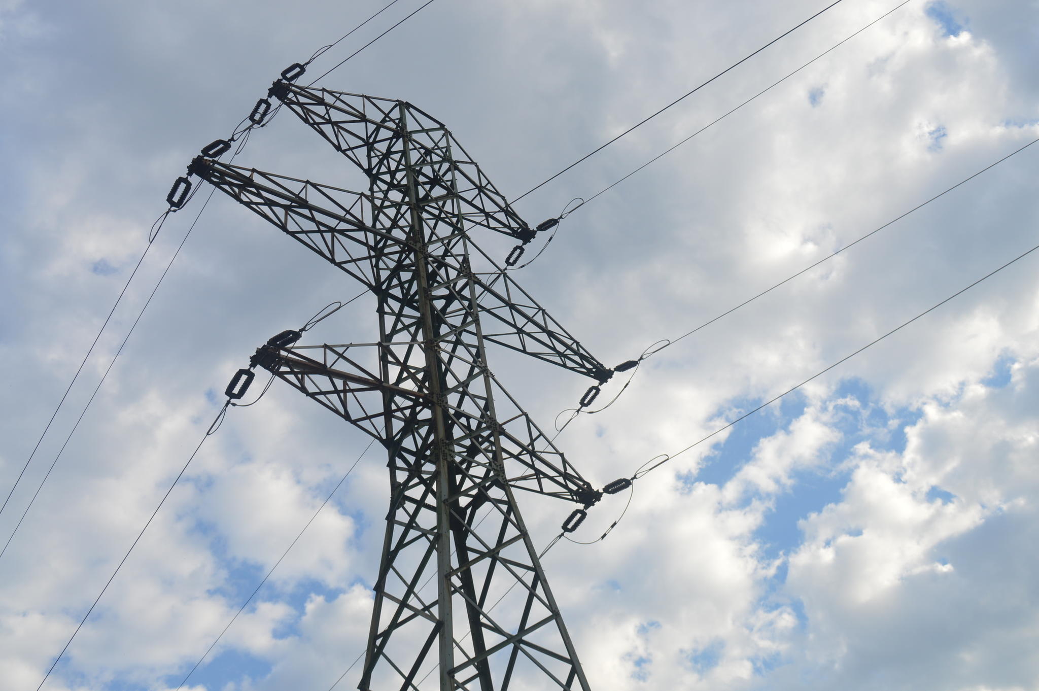

    A few pics with the house to pole supply connection, the main fuse box outside the property from which I get electricity into my workshop.
    A big high tension structure which is situated on my property, quite close to the workshop.
    It has a lightning protection thing included. Although, I have now and then some fluctuation in the supply, as some light bulbs are blinking/dimming, I never had any appliance broken or anything like that.

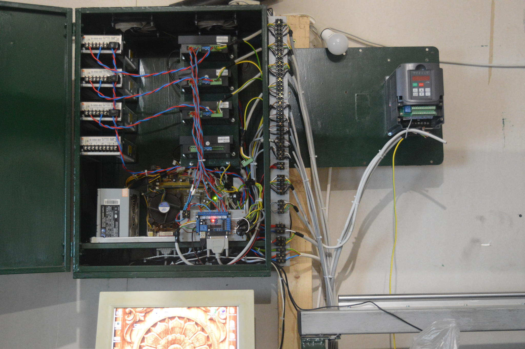

    Also have a cctv camera in the workshop, a few meters away from the cnc. It does not seem to be affected by the cnc. I don.t know the other way around and might be a different story when I.ll wire the vfd.
    There is also the metal control box, with some terminals in the left side, put there only because the terminals on the drivers, due to so much troubleshoot and rewiring seemed to go weak, and so any future fixing, will be done on this new ones.

    It was a lot jerkier a month ago. Not sure how good it is now, though, as all the articles I read say to tune the motors and speeds until they sound good, and honestly I have no idea what this good sound, sounds like.
    The settings in motor turning are 800 rev, 600 vel, 50 acc. At this speed, the y axis which is very heavy, seems to shake just a little at an abrupt stop. The other two, could be set to go faster, but as Clive says, one thing at a time.

    Re the earth rod For a test you could just knock a metre long metal rod into the ground and connect it to the incoming mains ground. If it works then get a copper coated rod.

    that should be fine - the longer length you can drive in the better unless you hit a drain You could then fill the pipe with water to make a good earth (not a joke!).

    The water in the pipe is only to drain down and wet the soil at a depth to make a better contact, so it doesn't matter if the pipe cracks with frost (which is unlikely if open at the top). If your soil is very wet normally, then it is probably an overkill. Copper pipe is as good, maybe better than a plated steel rod.

    Taking on your advice, and speaking to an electrician, a retired one in this case, he said they use to drive 3 spikes into the ground, a few meters apart, and weld a connection between them, so that the earth might match the live, and have a specific ohm readings, so that the fuse will work properly. He used to practice he.s craft many years ago, so not sure if his knowledge it.s still valid with this new fuses.
    Also said that the large metal structure from the photo has a very solid grounding structure going on, so I might use this. That is a high voltage system, and I.m not sure if it goes well with 220v systems.
    That.s the best I could find today, as we have a holiday going on, but will check with the up to date electrician as well.
    Will fix this earthing problem asap.

    You are 3 meters away from the double power lines in the picture above? No way!!! There are regulations for a protection corridor of around 30-50 meters along the high voltage power lines. I hope you are not living near... For health reasons it is recommended a distance of 150-300 meters from the HV power lines.
    Maybe those power lines are used only occasionally and coincides with the time your CNC starts going crazy. Are you hearing any hum under those lines?
