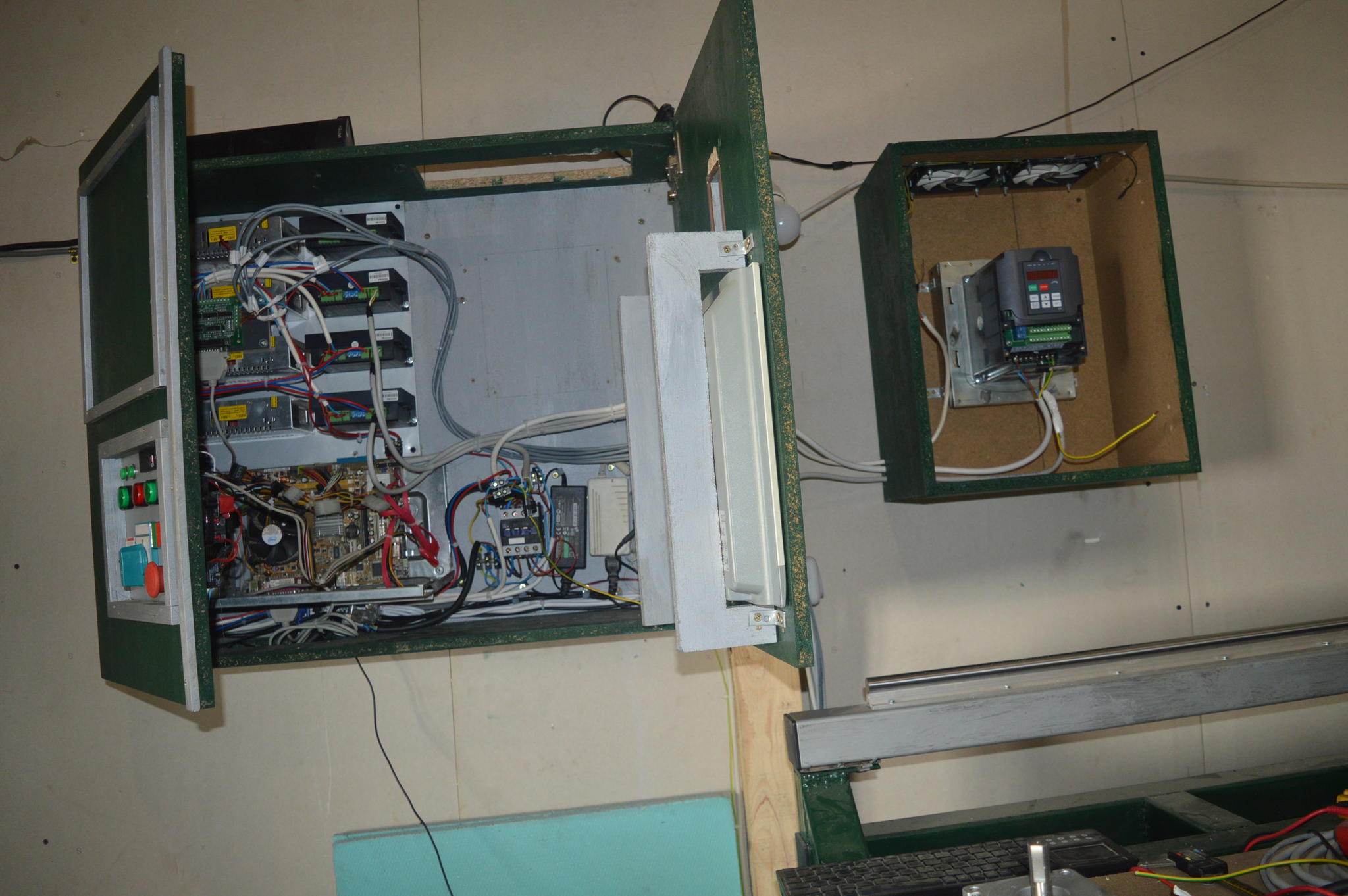

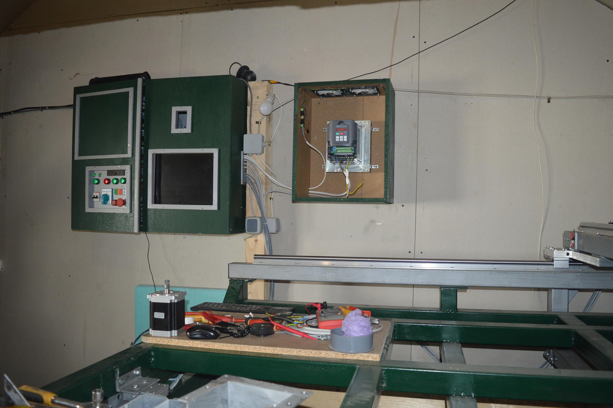

    This is where i.ve got so far with the project, and once again I ran into an issue which I.m not able to fix. Everything was going fine, until I.ve wired mains for the vfd, then I had a surprise when I almost crushed the z axis as it did not stop when I released the keybord. After I.ve wired the spindle, evrything went nuts, as the steppers make a strong noise, and move back and forward quite fast. It.s a chinese 1.5 kw air cooled kit.
    As it can be seen in the photos, my idea was to put eveything in one box, including the pc.
    I.ve decided to make another enclosure for the vfd and move it a bit further away, and it did not fix the problem. When I turn on the power for steppers (with a contactor) and the vfd (cam swith), even if the pc and mach 3 are off, or even if the vfd is off, the steppers go mad until i hit reset in mach 3, then they stop and work fine, until i turn on the vfd and/or the spindle.

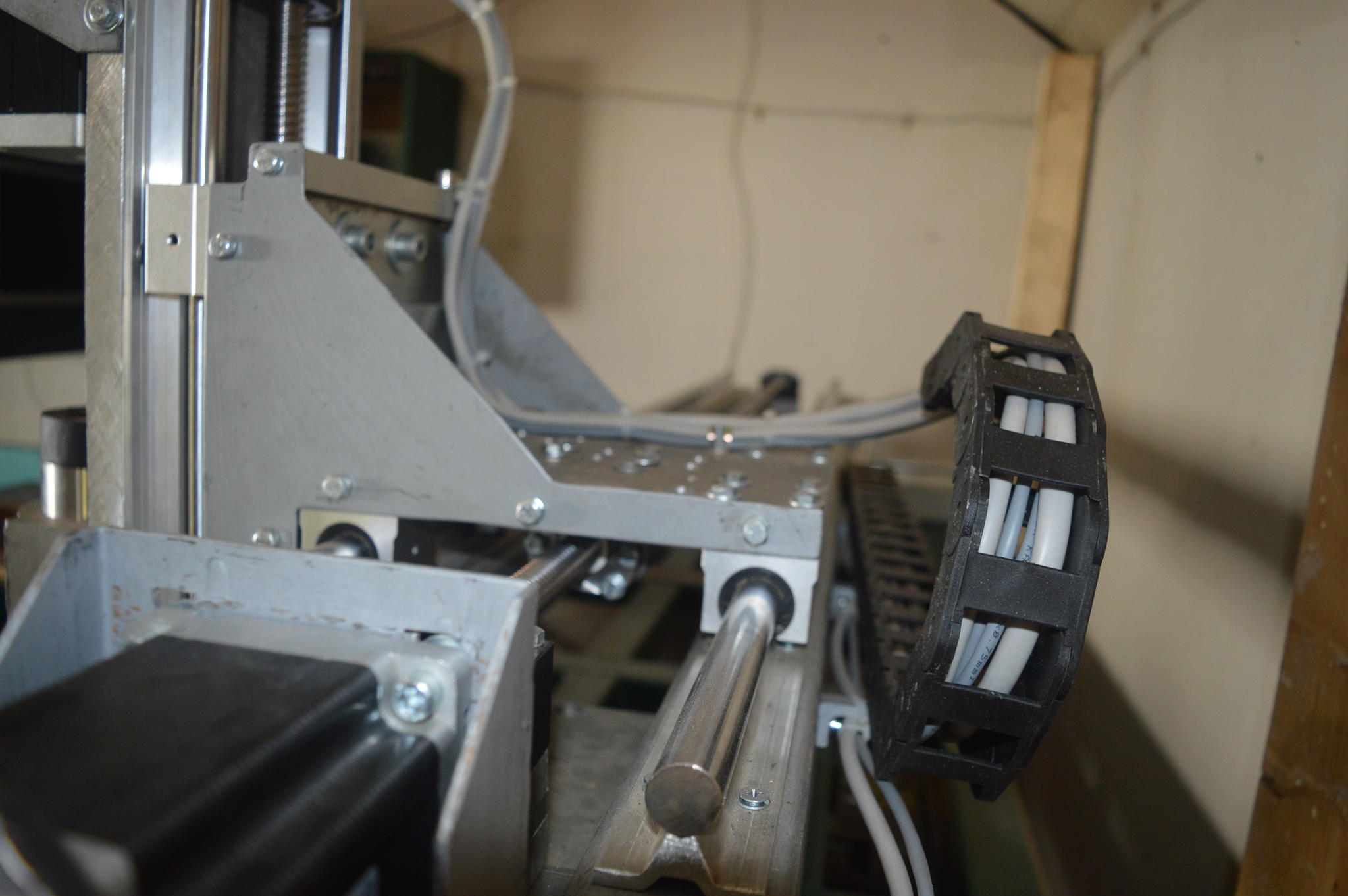

    The wires are shielded, 4 wire cable for all steppers and spindle (18 and 14 awg). I did open the cap of the spindle and connected to the case a ground wire (the 4th one) and connect it to a steel rod in the ground. I did this because it says in the manual to avoid having a common ground with a welder. And I do use one quite often. I did not connect the shielding to anything. I.ve only tried yesterday to connect one end of the shielding at the vfd end to see if it makes any difference, and it did not, and also disconecting the spindle ground from the vfd did not do anything (as by default there is not a 4th wire available). No shielding it connected at any end for the steppers or the limit switches. The only non shielded wires are the mains for everything, pc, sources, drivers, breakout board and vfd.
    All the wires go togheter in a cable drag chain.
    It is important to connect all the shields to a star point at the control box. Including grounding the router frame.
    Only ground one end of the shields. Also make sure the various mounting plates are also grounded to the star point.
    With a gantry that wide I think you will need two screws to stop it racking this can be done with one motor and a long belts or two motors one each side.
    Hi Clive,
    Thank for your reply.
    What do you mean by a star point?
    So I should connect all the shieldings at one end for the spindle, the steppers and the limit switches, to a common point in the case. The frame has a common ground/earth with the spindle, which goes into the vfd and from there into one iron rod in the ground. Everything else, has the ground wires sent into the main electrical grid.
    After all the shields are connected to this star point, where should this star point be wired to?
    Regards,
    Andrei
    Clive S's Avatar
    Lives in Marple Stockport, United Kingdom. Last Activity: 18 Hours Ago Forum Superstar, has done so much to help others, they deserve a medal. Has a total post count of 3,348. Received thanks 620 times, giving thanks to others 90 times. Made a monetary donation to the upkeep of the community. Is a beta tester for Machinists Network features.
    Quote Originally Posted by Radu_Andrei View Post
    Hi Clive,
    Regards,
    Andrei
    OK I am not familiar with how you receive you incoming mains in your country In the UK the electric company supplies a ground point (that in general is also connected to our neutral) But in Spain in the country areas the supply does not include a ground So you have you use an earth rod in the property.
    In your case I think I would connect the shield of the cy4 core going to the spindle to the star point at the control box end only. Ie don't connect the other end to the earth in the VFD.
    Thee start point is connected to the main ground (if that is a earth rod then that)
    What you are trying to achieve is not to get any ground loops.
