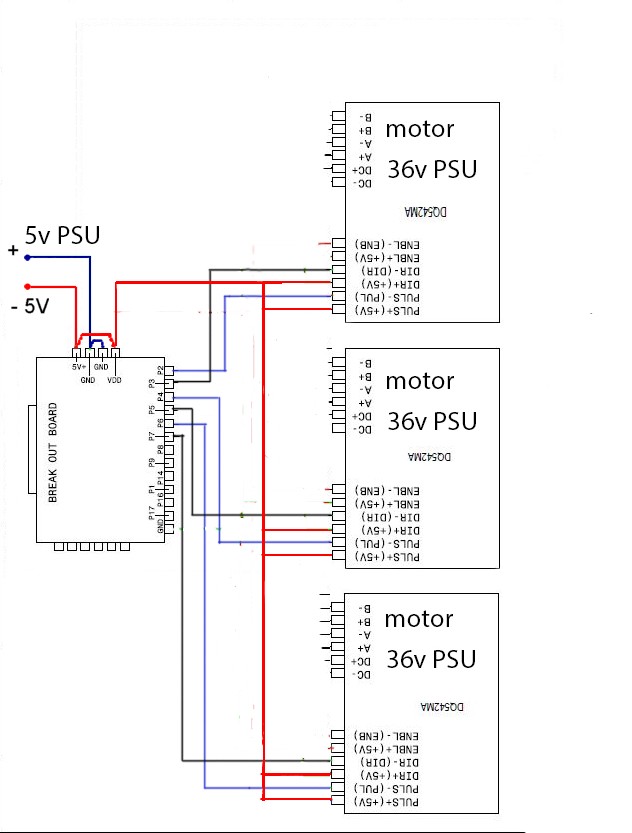

    Also I found this wiring diagram online, and it.s quite different from what I.ve done.
    I go to BoB from Pull- and Dir-and this one goes from +.
    Enbl+ is daisy chained and wired to the Vdd, while mine is bridged to Pull+ and Dir+.
    Do this small differences matter in any way?
Name:	Stepper Motors Wiring.jpg
  7. #37
    going by your photo in post 35
    without circuit details of your breakout board
    I expect the opto isolated BOB NPN outputs will be connected
    so they can output sinks more current to GND
    than it can source current from the +5V supply via a pullup resistor
    If I am correct
    I would connect the BOB to the stepper drivers like this :-
    the + step & +direction going to the +5V supply and
    - step & - direction being connected to the BOB outputs
    John

  9. #39
    going by the photo linked to in post 38
    it looks like the BOB is as I expected with pull up resistors on the outputs
Name:	6 Axis BOB op pullup.jpg
    unless you connect the - enable to a BOB output
    having the + enable connected to +5V will have no effect
    what could be a problem is having the BOB's output optoisolator being connected to another optoisolator inside the stepper driver
    having the step signal passing through two optoisolators could distort the pulses too much at high step rates
    John
    PS
    in the photo of the BOB you can see two links that connect the +5V in to Vdd and connects the two GND's together so you don't need the external wire link as in post 37
    PPS
    a while ago I produced this circuit diagram from photos taken from the net
Name:	ebay opto-isolated CNC BOB.jpg
    what I need to confirm is the connection of the 10K resistor connected to the 74HC14 input
    it was not clear from the photos if the resistor was a pull up to +5v or pull down to GND
