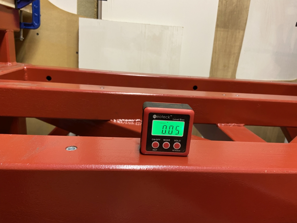

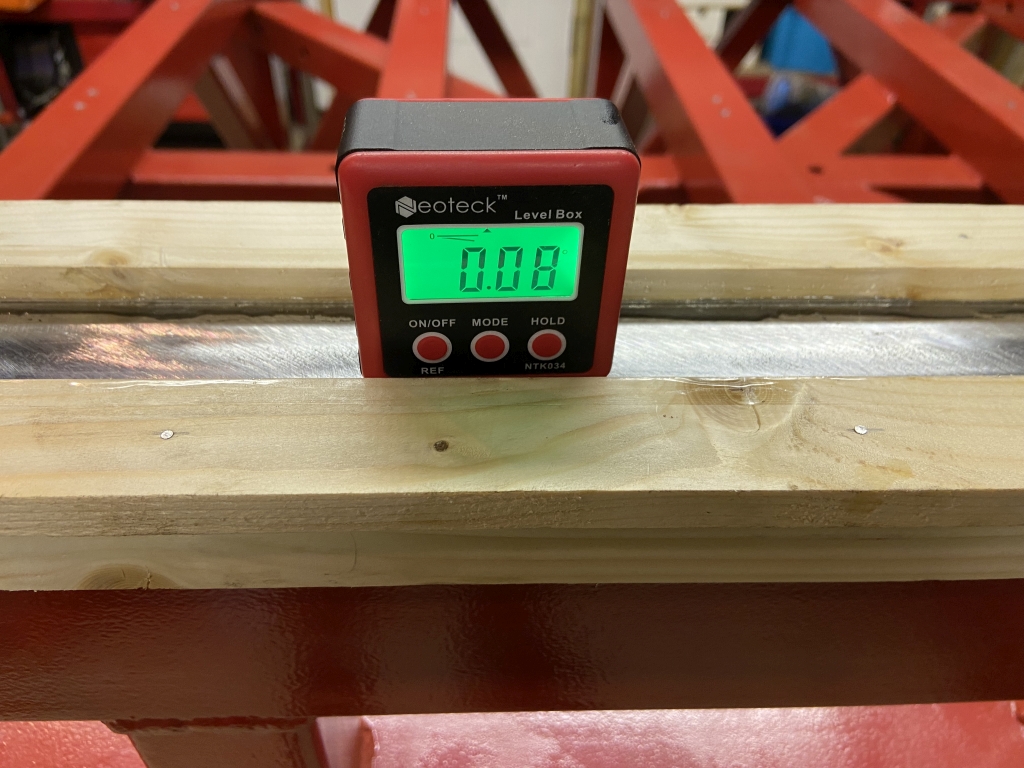

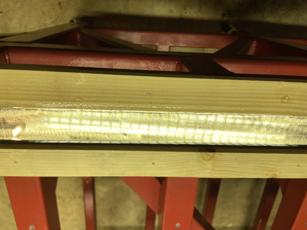

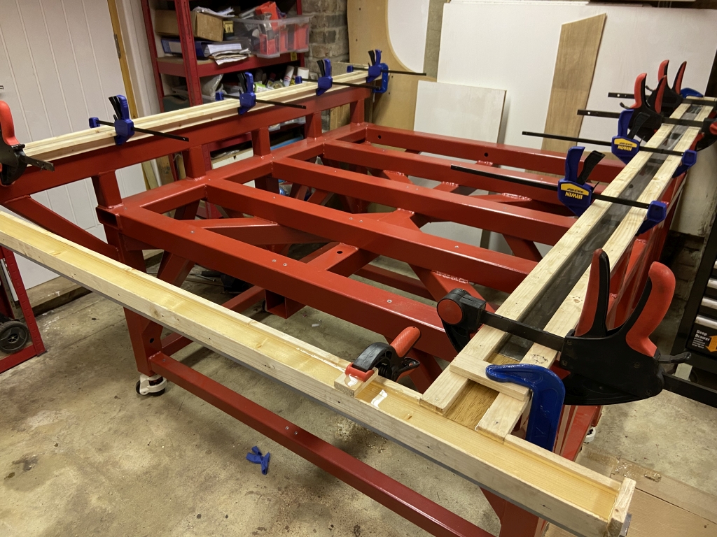

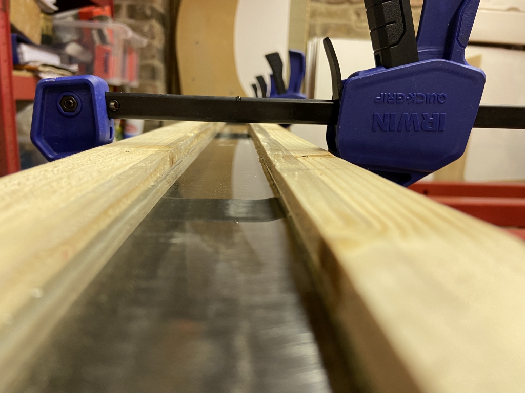

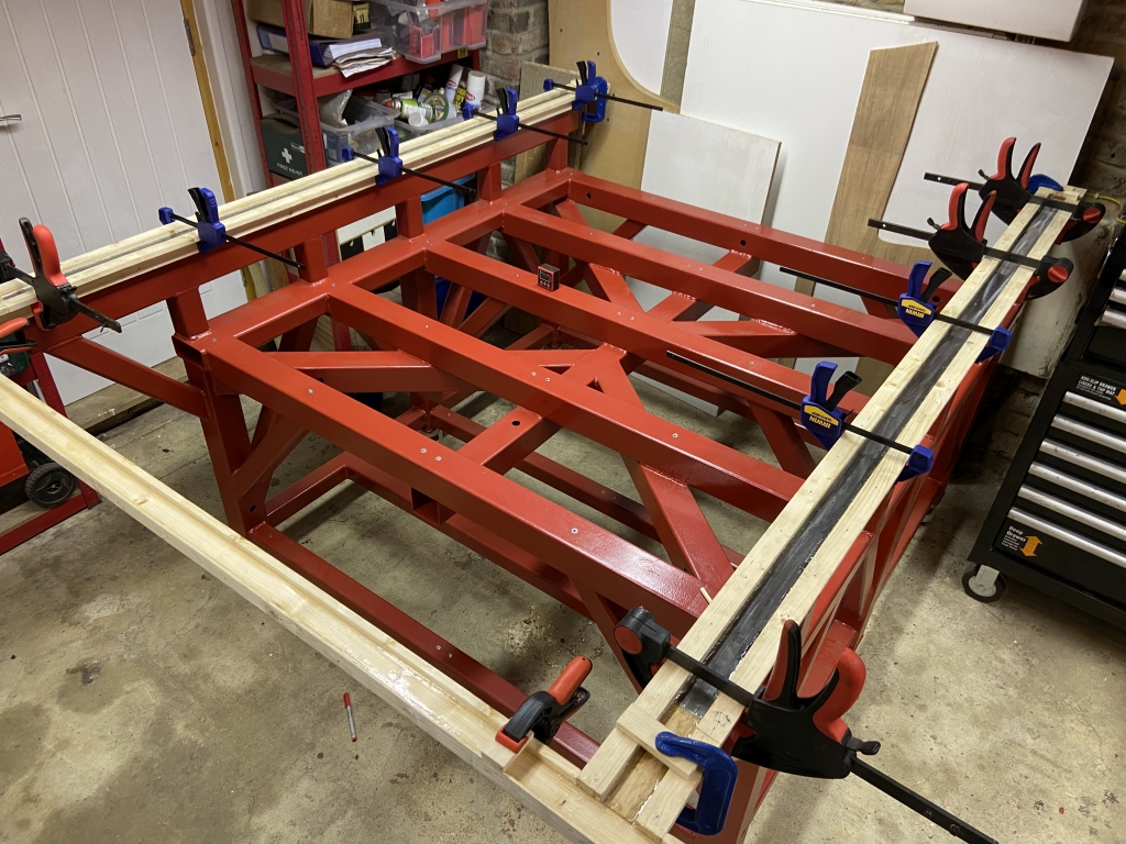

  8. #98
    Got the frame as level as possible and poured the epoxy this weekend:
    Overall I'm very happy with it, there's only one area I can see that has a slight wave to it, think I either cooked it with the blow torch or hit it too late and the epoxy was too solid to smooth itself out. I don't think it will be a problem, I'll see once I get to fitting the rails and fill / shim if required.
