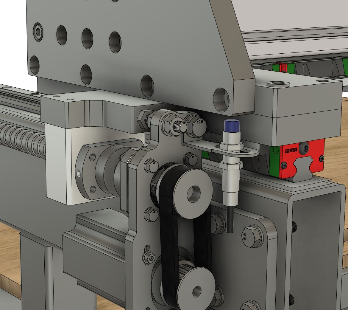

    I haven’t looked at the data sheet for the sensor but. I’d assumed that it would be triggered 2 or 3mm before contact and I could then have the hard stop almost flush with the sensor z. How much overrun should I allow for? I guess when it’s travelling at speed something like 5-10mm would be better?
    You need about the same length as a piece of string! All depends on the weight of the gantry, your approach speed for homing (crashes at rapid speed will hopefully be avoided by soft limits once the machine is homed which is the first thing you will do after switching it on) and some stuff to do with drivers that other regulars will understand better than me.
    Your Z and other axis (it's Y on my machine but X on many) sensors are right. In practice the overlap of the sensor and your target will not be very much when it triggers. I put slots in the mountings of my targets to make things adjustable but this does increase the risk of something moving and messing up the repeatability of homing.

    Quote Originally Posted by JonnyFive View Post
    The distance is determined by the sensor spec, if using just for homes then 2-3mm won't be a problem but if using for limits then usually you will be traveling at fairly high velocity when tripped so the inertia will easily travel 1-2mm if at high feeds.
    Also, the accuracy and sensitivity are affected by distance, so it's best to keep the distance on the smaller side of the sensor spec. This way it will react faster but obviously if end on you have less room to stop. 90deg is a much safer setup.

    Finally got around to sorting the proximity sensor bracket:

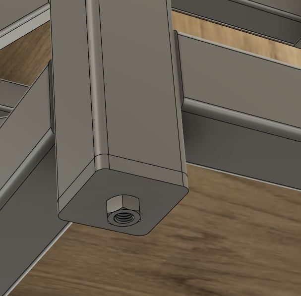

    I think I'm finally there with the design, still need to finalise the motor choice and sort out some sort of levelling feet - can't decide whether to add levelling casters, they're pretty expensive but probably worth the money if I ever need to move the machine. At the minute I've just got M12 nuts welded on to the base of each leg - they look a little small to me but it seems M12 feet are good for 1000kg each - should be enough!

    I made some steel discs as targets for mine as the sensor will be more sensitive than on aluminium, but both will work.
