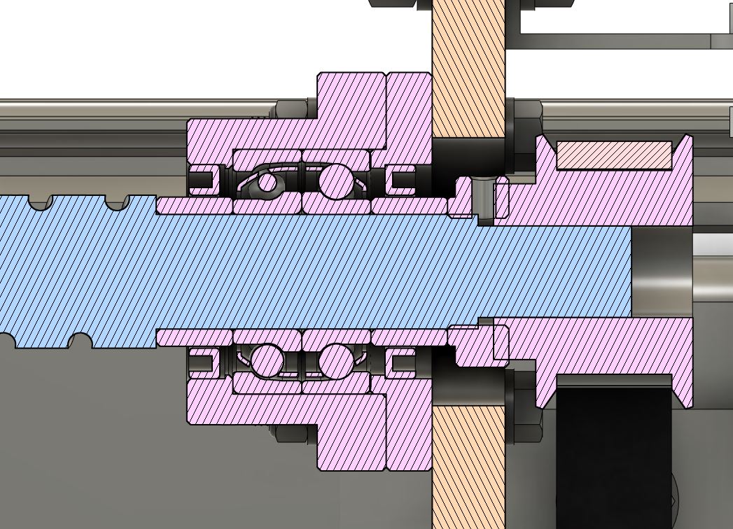

    I'm trying to finalise the ball screw design and noticed that the standard dimensions from BST don't seem to be compatible with the FK15A bearings - looks like the spacers eaither side of the bearing are too long and there's not enough length to get the locknut on the end:

    Am I missing something? Do I have to turn down the spacers? I'm planning on tweaking the end to have 2 locknuts rather than using the grubscrew, just want to make sure I'm doing it correctly.

    Have you purchased the ball screw and bearing FK15A from Fred if so he should have machined it to match the bearing.
    Also did you tell him the "F" length you wanted it is normally 15mm as standard but I usually tell him to make it 30mm so as to get more space for a pully.
    I am not familiar with that bearing.

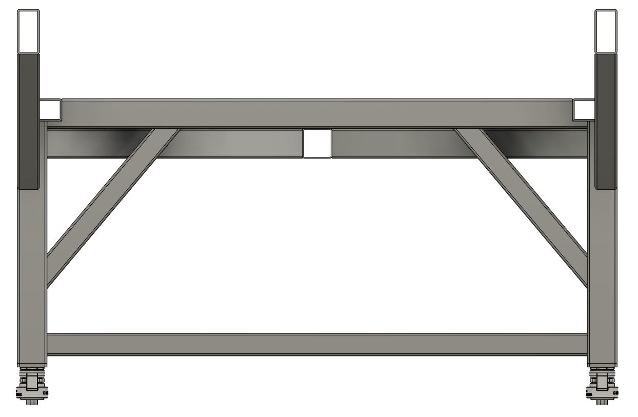

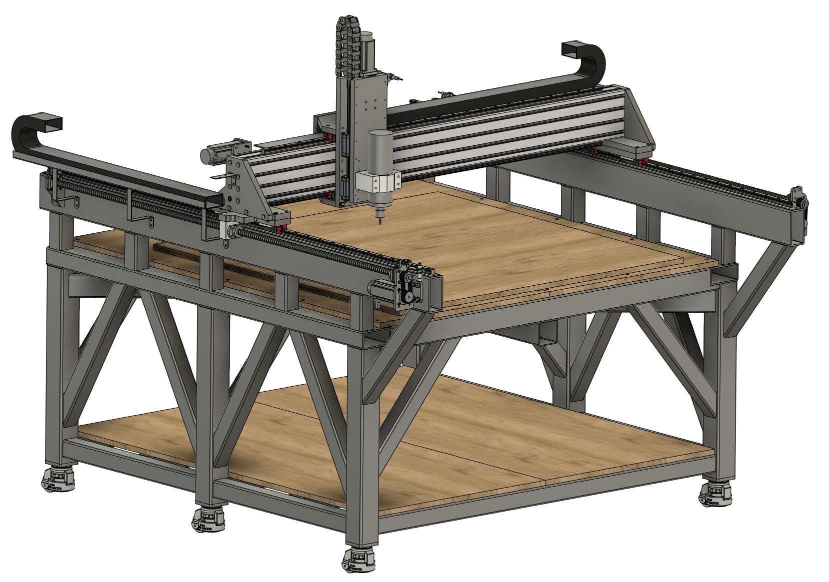

    It's been slow progress over the last few months. I've spent the last month or so trying to work out how much this thing is going to cost me, looks like it's going to be around £5.5k.
    Here's what I got so far:
    Steel box section for the frame:
    I have scavenged some 80x80x3 box section from work; I have redesigned the top of the frame and the main leg uprights to use this, the rest will be 60x60x5 & 60x120x5 as previously planned. The price of steel is insane at the moment, it's going to cost £750 for the rest of the steel I need - my original cost was £500 when I priced up the entire frame a couple of years ago!! I've been trying to figure out if I've over engineered it, compared to most other designs I've looked at I seem to have an awful lot of steel in there.
    Parts from BST:

    = £1417
    Aluminium extrusion for gantry:
    2 off 160 x 80 x 1620mm (with drilling / tapping) = £1064
    Aluminium tooling plate:
    I've calculated approx £500. I was hoping to get these made for me but there is a maker space recently opened up near me that has a CNC mill so I am thinking it will save me some cash and be a good introduction to CNC to sign up and make them myself.
    Closed loop steppers & drivers = £500
    Electronics:
    I've estimated £500 to cover the PSU, enclosure, cables etc - is this about right?
    Miscellaneous:
    Estimated around £500 (not including PC and software)
    Is there anything obvious I have missed? Are my estimates about right?

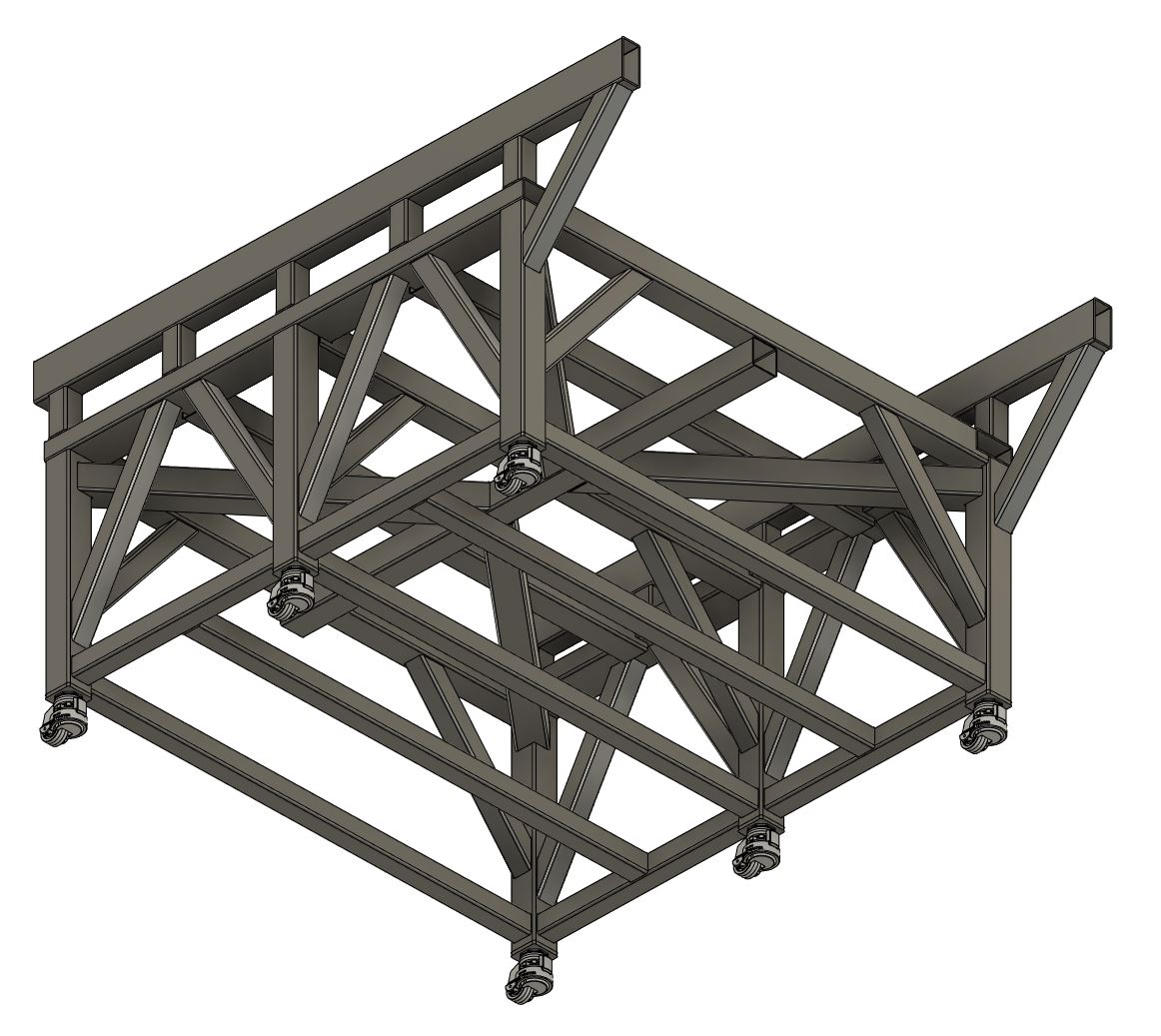

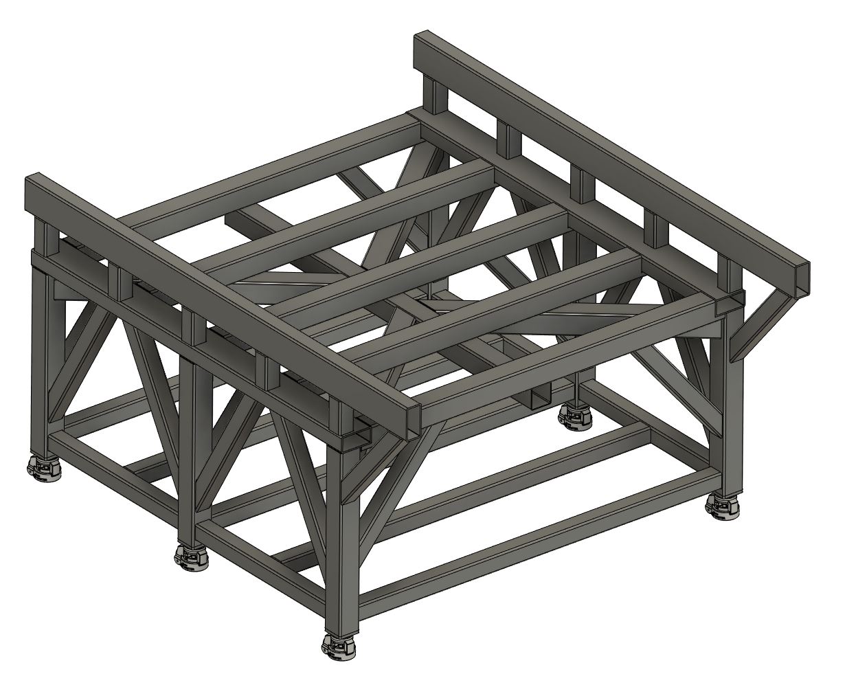

    I have reworked my frame to include the 80 x 80 x 3 that I have, I used it on the machine bed and the main uprights - I figured the bigger second moment of area compared to 60 x 60 x 5 would make these parts stronger. The frame now looks like this:

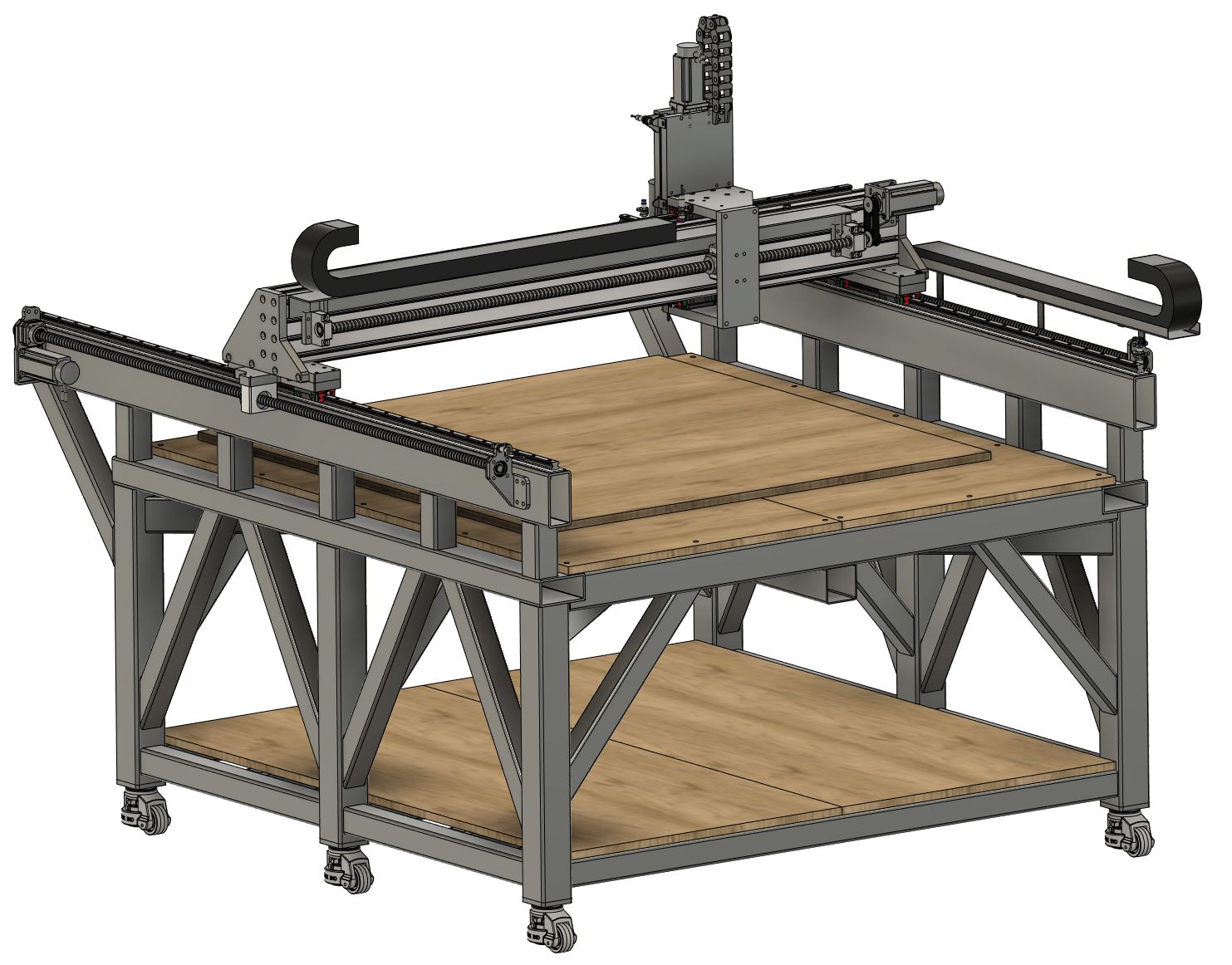

    I am also pondering whether to have just a single aluminium extrusion for the gantry to save a bit of money. I can see that it adds a lot to the stiffness to the gantry but £500 each piece is a big investment. I have seen people get pretty good results on lesser machines with far smaller gantry sections. For example a single 160x80 section has a second moment of area 22x greater than a gantry made from C-beam. I'm not 100% convinced the extra cost will result in a significantly better machine - interested to hear what people think of this?

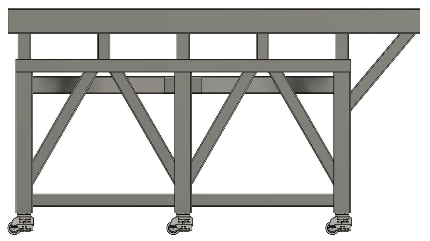

    This is how the machine looks now:

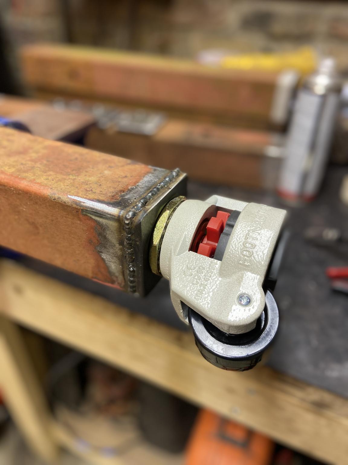

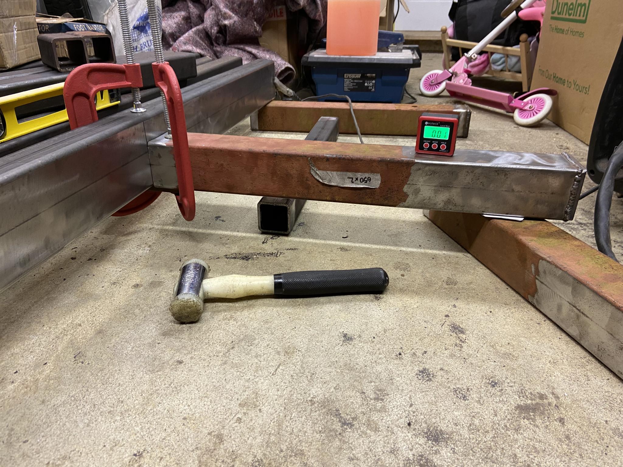

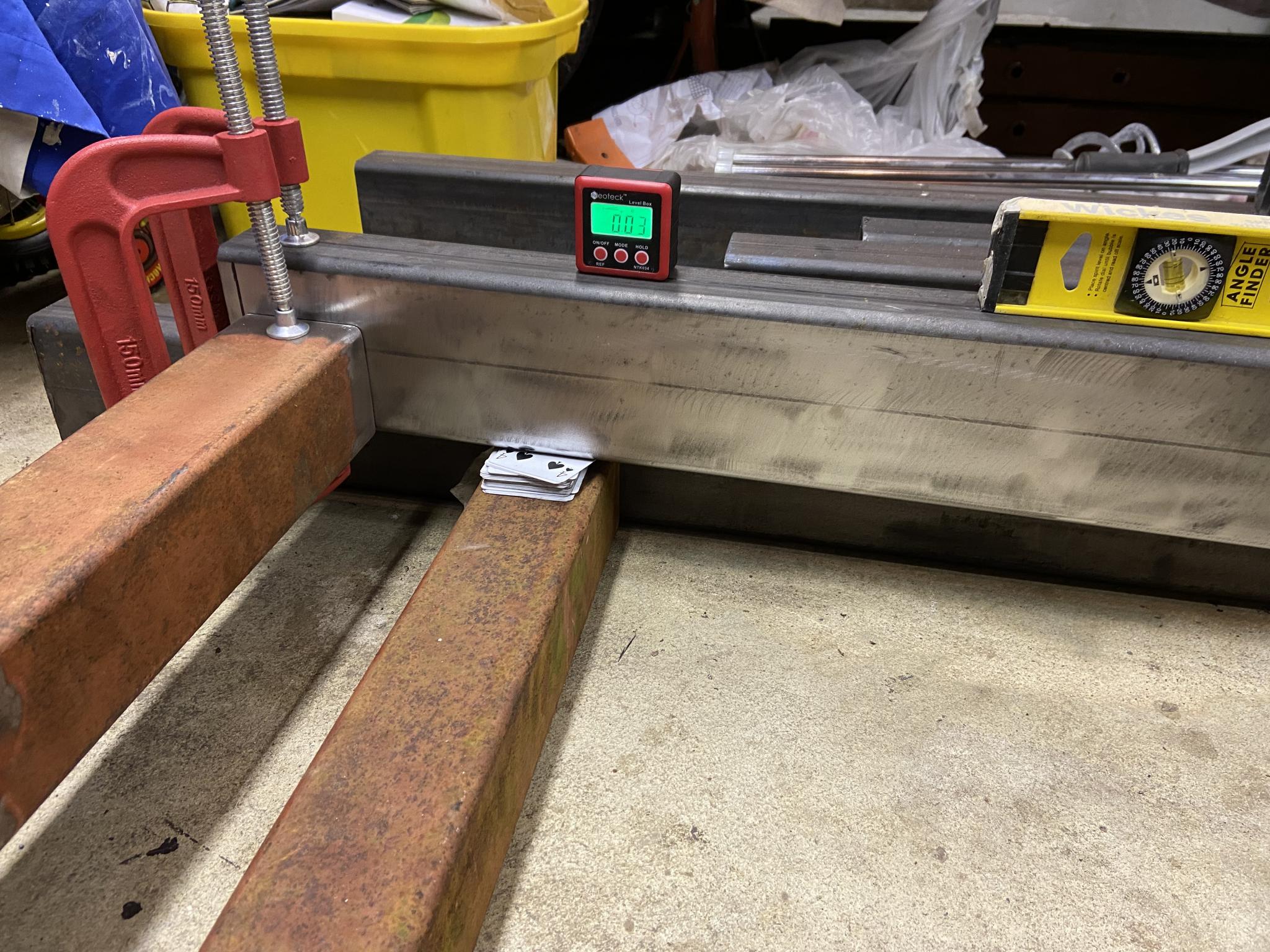

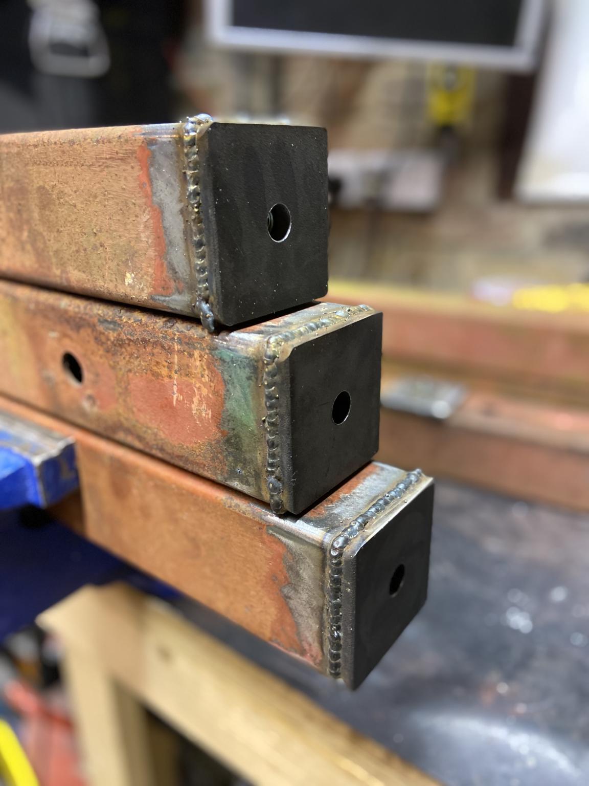

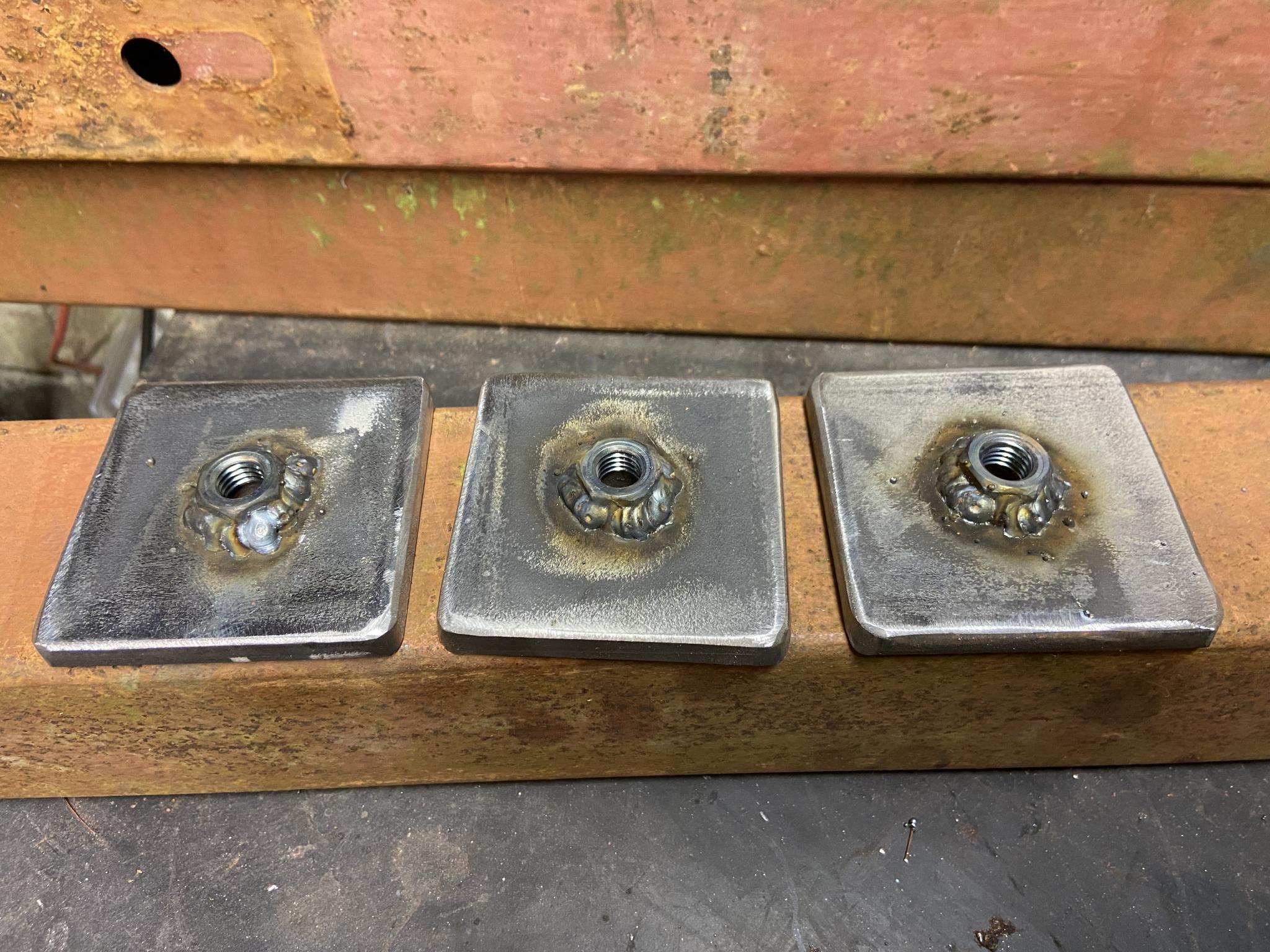

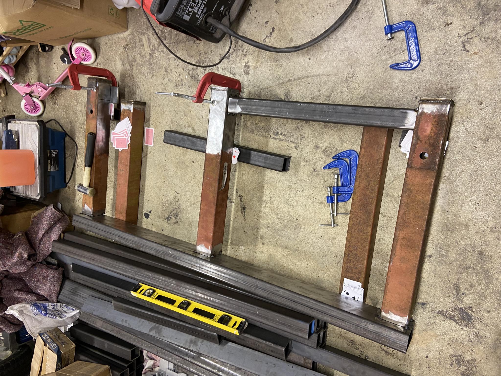

    Finally the first step to making this thing a reality, excuse the terrible welding!!!
ID:	30943   Click image for larger version.
