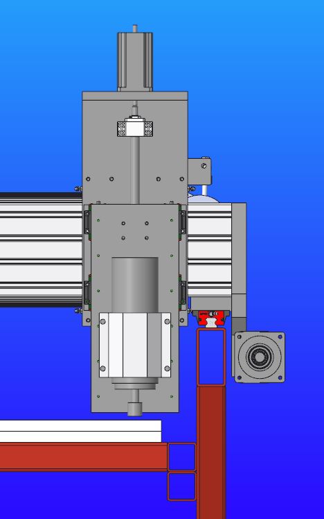

    Does this look about the right amount of clearance with the z-axis at its lowest?
    My plan is to have two pieces of wood for the bed, the top one being sacrificial. I've assumed the shortest cutter would stick out about 25mm and allowed this much clearance from the top of the first spoil board. This should allow for the top board to be resurfaced a few times and still give enough travel on the Z. Am I about right with this?

    Quote Originally Posted by JonnyFive View Post
    Spindle looks ok but spindle plate would be better higher to give clearance for clamps or vice jaws. To still give enough travel the whole gantry then needs to be raised the same amount. But if you move it too high then the Z axis has to extend down further so it is all a balancing act in the design stage.
  9. #19
    Ok, I’ll move things around a bit to raise the gantry and mounting plate. Cheers
    If you raise the Z plate and lower the spindle in the clamp to stop the Z plate catching clamps etc.
