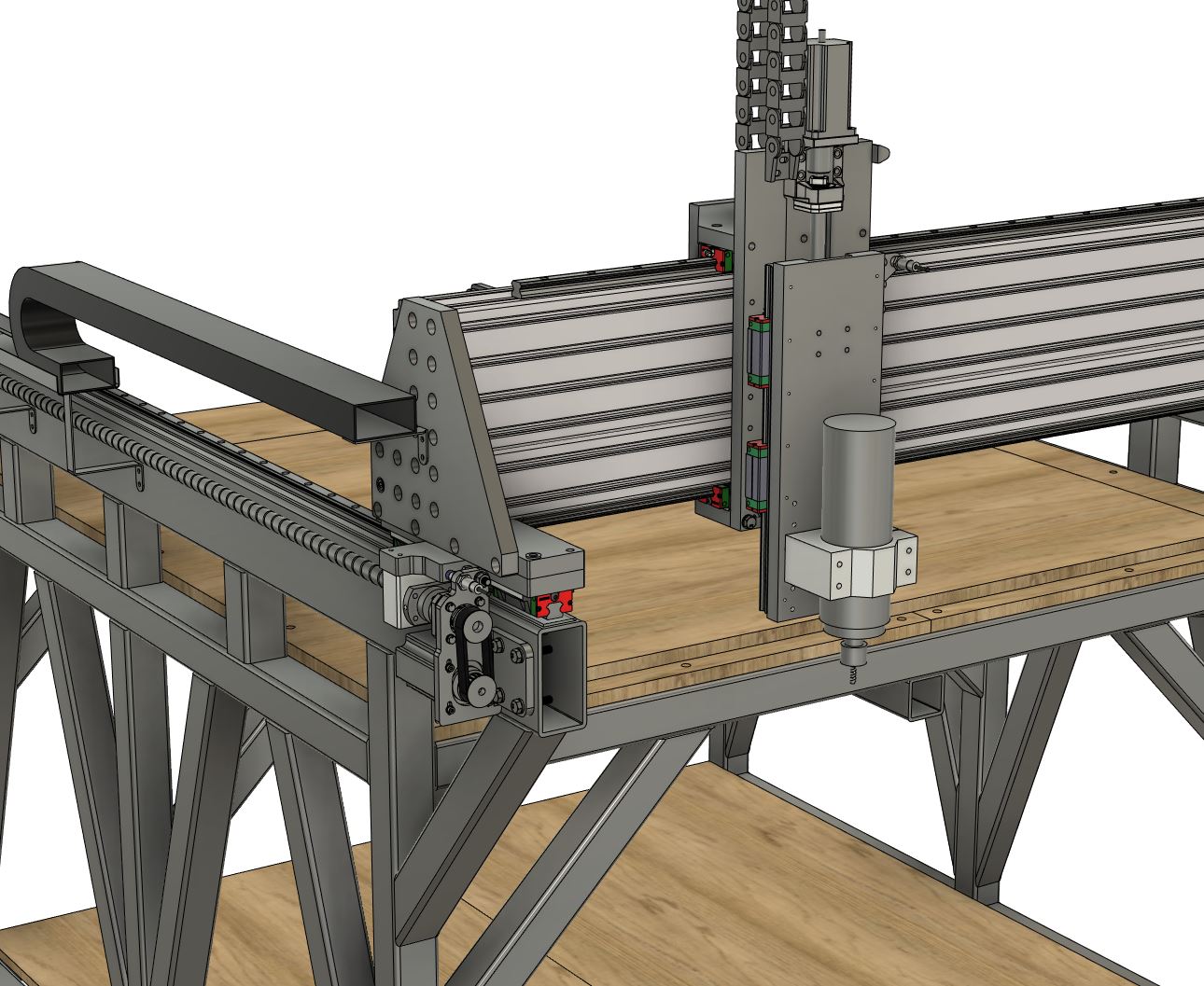

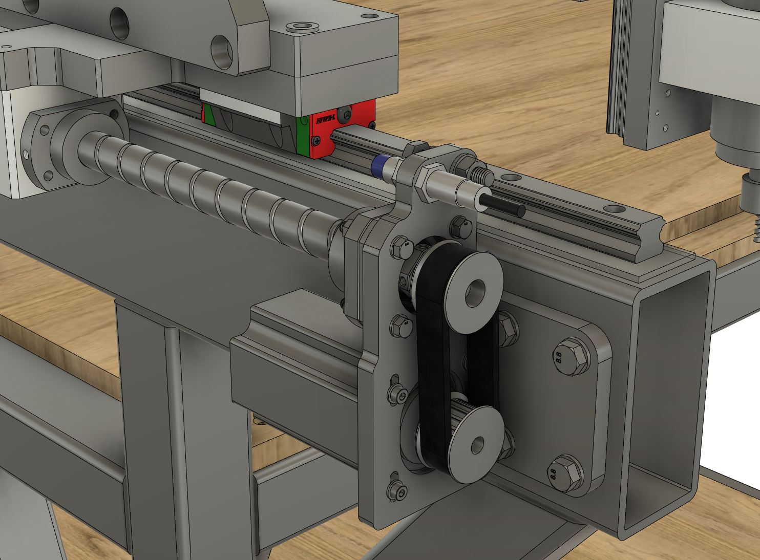

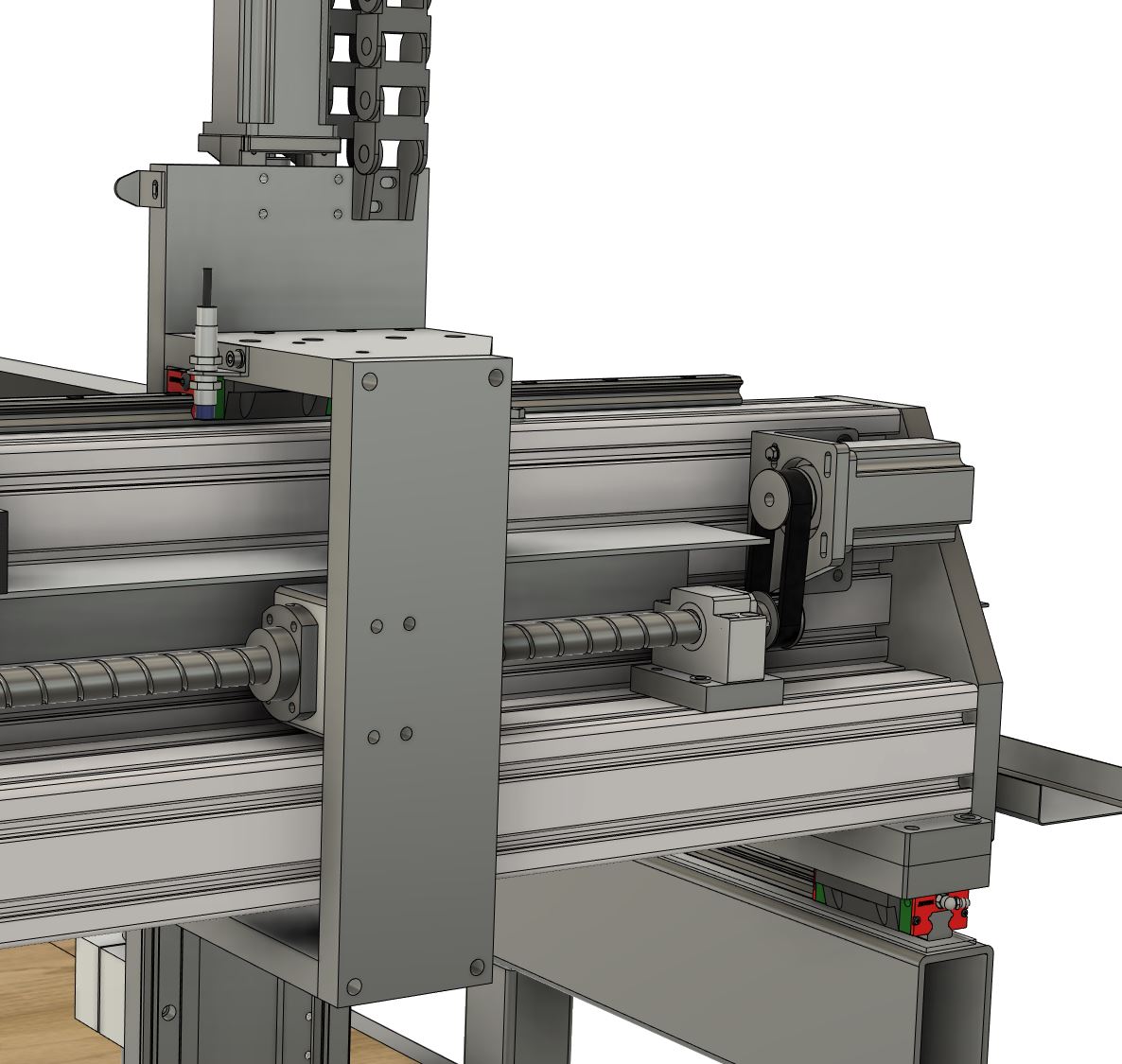

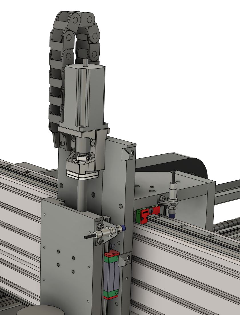

    I think I've remebered how I got confused with the 2:1 gearing, think I read somewhere about using 2020 ballscrews and then gearing them for lower RPM. 2010 seems to be the norm for a 4' machine so will go with that.
    I've made a bit more progress on the design......
    I have removed the gear reductions, now the x & y axes are geared 1:1 with 20T pulleys and the z is direct drive. I am still working with the 4Nm Nema 23s on all axes.
    I have also tidied up the end stops and proximity sensors.
    The x & y cable chains now have inner dims of 25 x 57mm (I couldn't find 25 x 58mm).
    Think I'm nearly there with the mechanical design, soon be time to concentrate on the electronics - not looking forward to that one!

    Looks good to me. The only thing I would point out is that you have the proximity sensor end-on. There's very little room for deceleration between detecting the gantry and being smashed by it. A safer option is to have the sensor pointing uipwards so that it detects the gantry riding above it. You already have a non-smashable mechanical end-stop in case that fails.
    Kit
  7. #56
    That’s a fair point, I’ll look at moving them through 90 degrees. Thanks!
  8. #57
    Clive S's Avatar
    Lives in Marple Stockport, United Kingdom. Last Activity: 15 Hours Ago Forum Superstar, has done so much to help others, they deserve a medal. Has a total post count of 3,348. Received thanks 620 times, giving thanks to others 90 times. Made a monetary donation to the upkeep of the community. Is a beta tester for Machinists Network features.
    I personally would turn the Z axis sensor the other way round ie. fit it on the back plate. This will make the cable neater.
    You could just drill the back plate.
  9. #58
    I like the sound of that! Thanks.
  10. #59
    Quote Originally Posted by JonnyFive View Post
    Thinking about it, I think the reason I didn’t do this is because the sensor would have to be where the lower target thingy is now and there isn’t enough depth to fit it between the gantry and z plate. Unless I’ve misunderstood what you’re suggesting?
  11. #60
    Kit
    I haven’t looked at the data sheet for the sensor but. I’d assumed that it would be triggered 2 or 3mm before contact and I could then have the hard stop almost flush with the sensor z. How much overrun should I allow for? I guess when it’s travelling at speed something like 5-10mm would be better?
