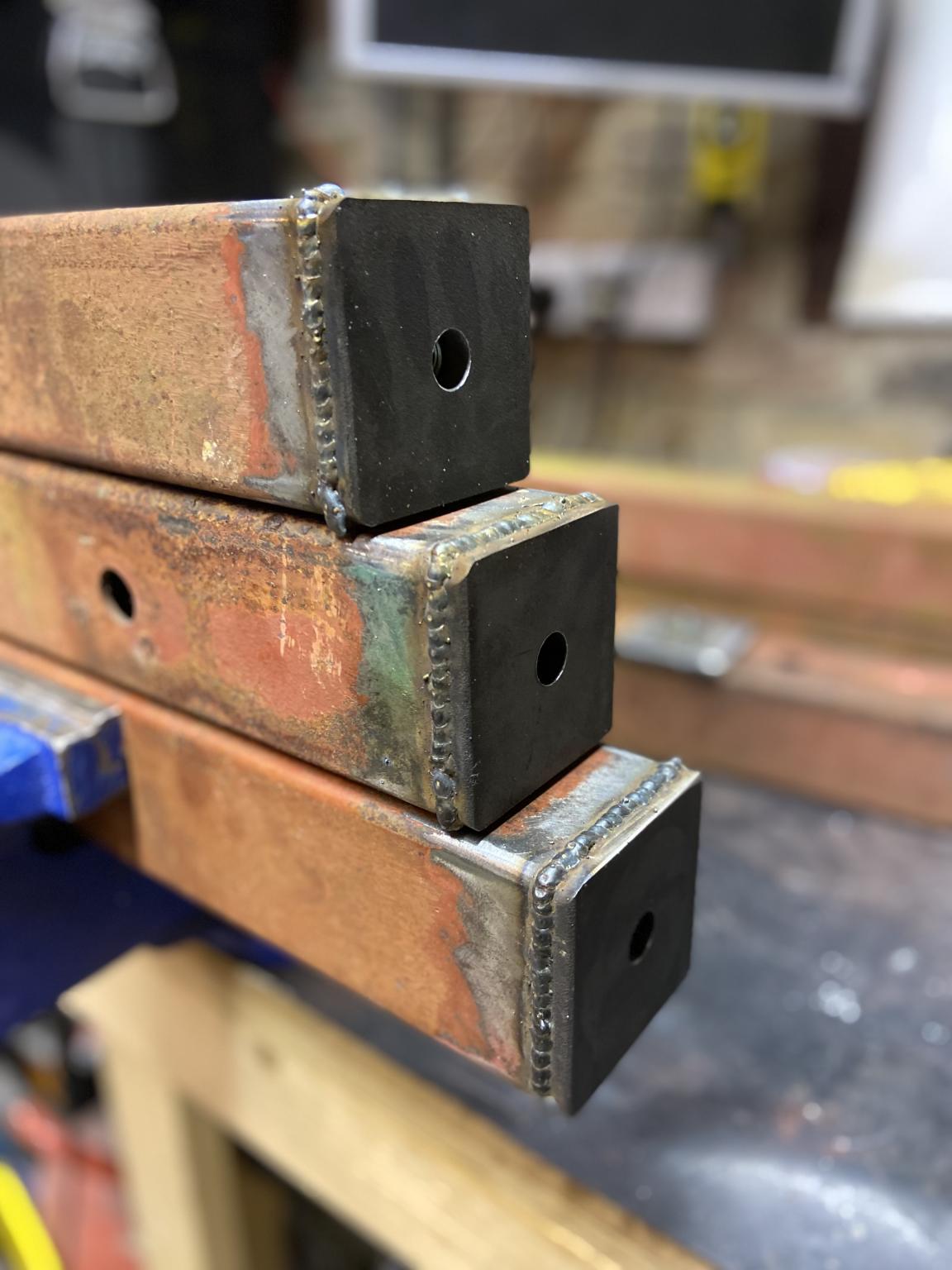

  10. #80
    Finally the first step to making this thing a reality, excuse the terrible welding!!!
ID:	30943   Click image for larger version.
