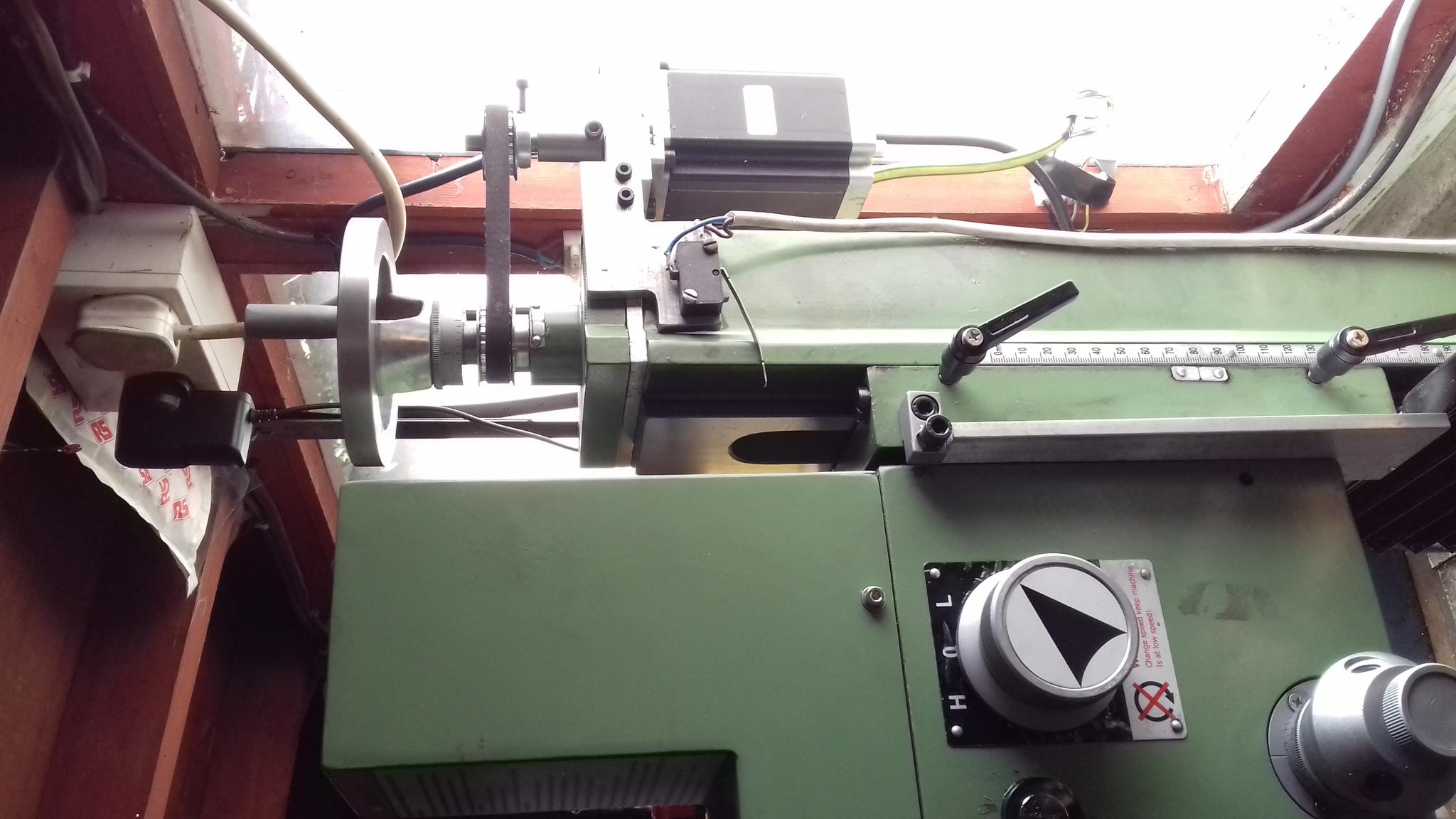

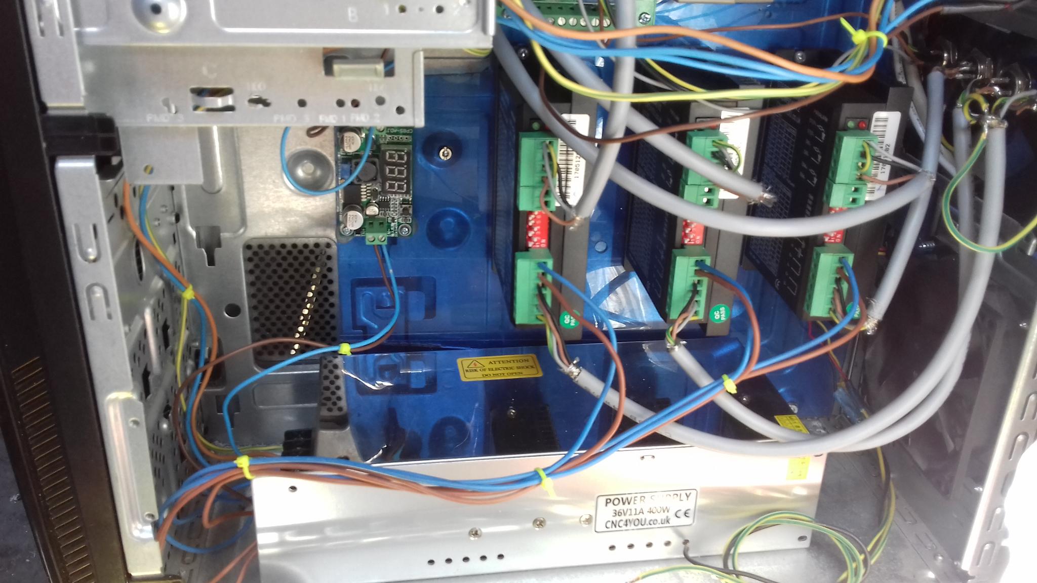

    hello all out there,thought i would try to send some pics of my man cave,hear goesClick image for larger version.
ID:	24467Click image for larger version.
