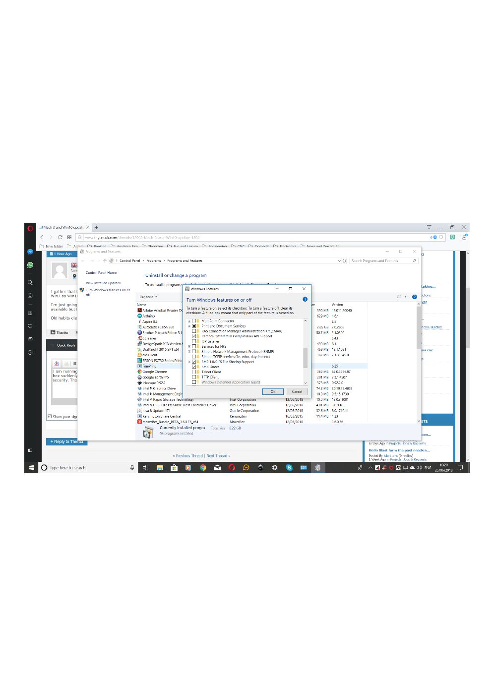

    I am running XP Home on my CNC machine and it is fine. I think it age matches Mach3. I am not to enamoured of Win10. I had a problem where my NAS box suddenly became inaccessible after a windows update. It runs SMB1 and Microsoft have withdrawn support in favour of SMB2, which has better security. There is a simple fix, but it was a bugger to find.
    Take no notice of the attached file, I can't read it and I can't delete it.
