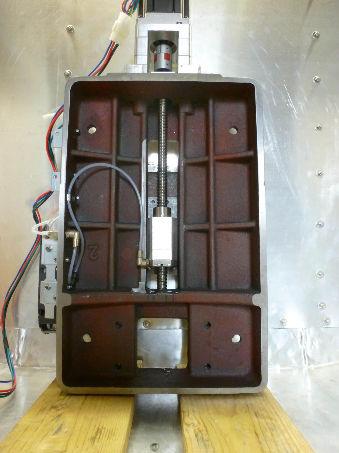

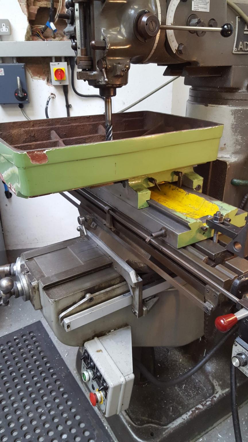

  7. Hi Terry,

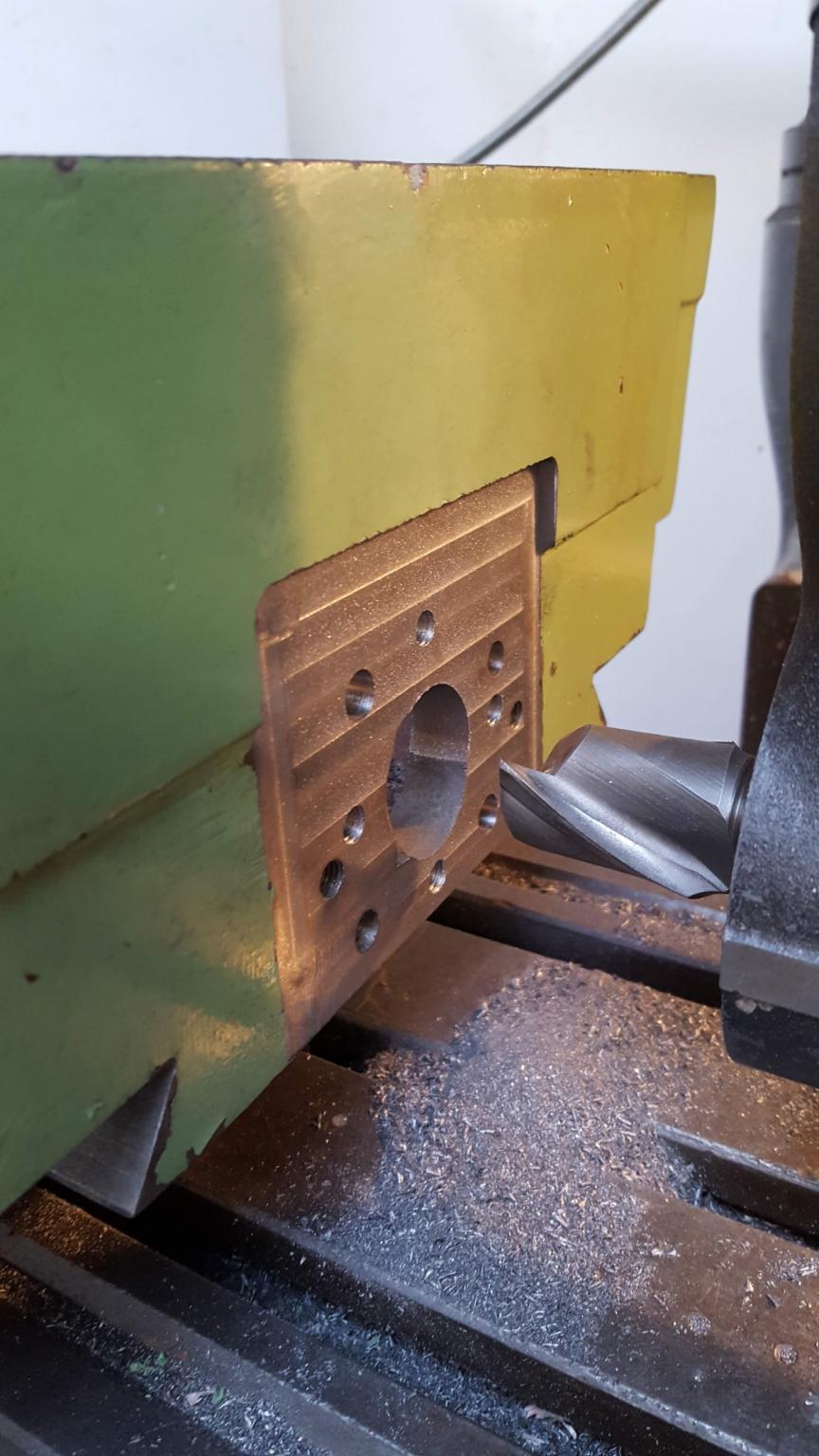

    Send an email to simon.m at cubethree.co.uk and I'll send over my CAD in SW2018. I'll also dig out some images of the machining of the casting for the leadscrews.
  8. I used a Bridgeport to machine all in one go the ballscrew mounting features. Used a 90 head to do the end faces. Although a slightly more complicated setup it got everything square and true as best I could.

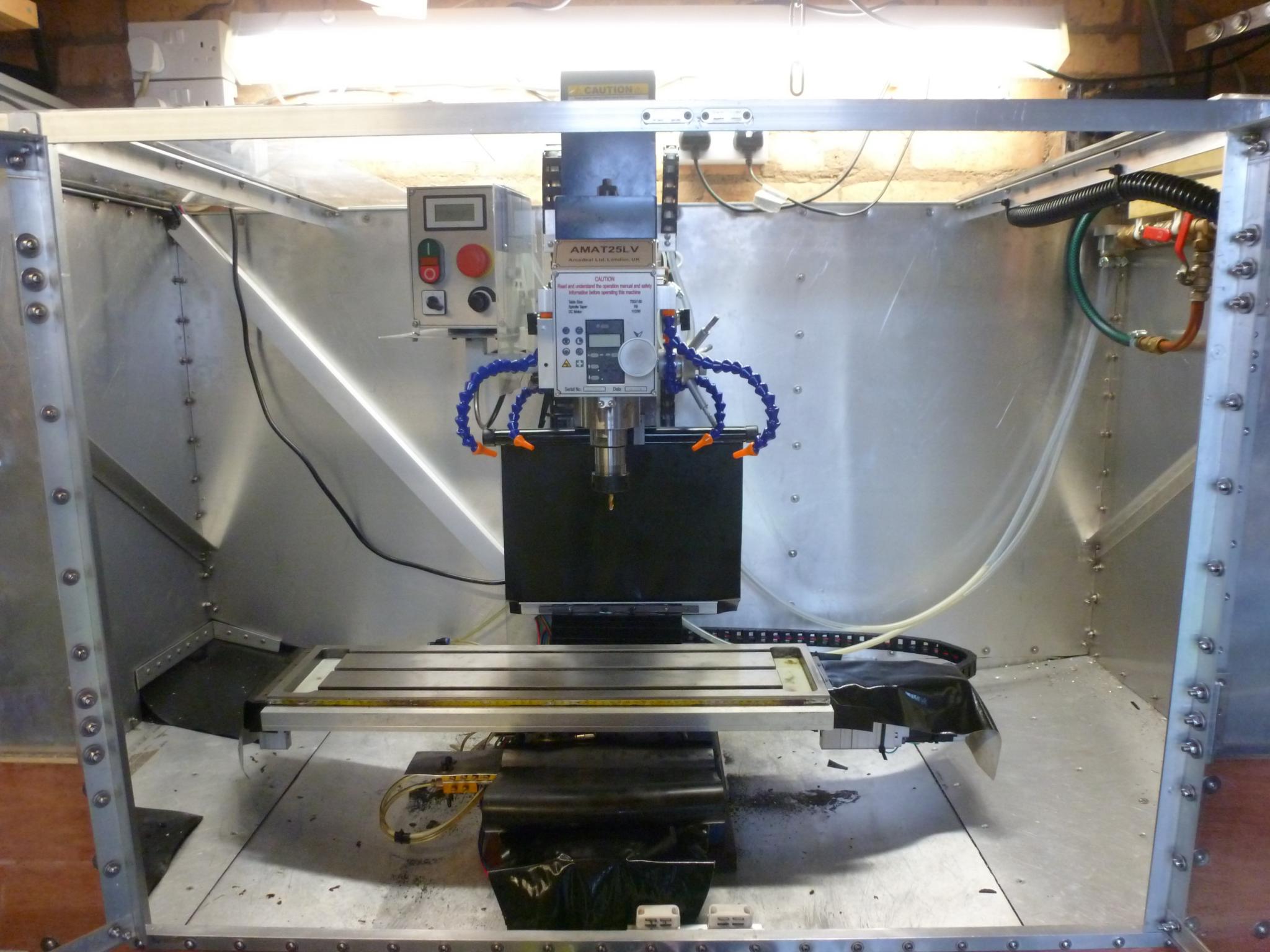

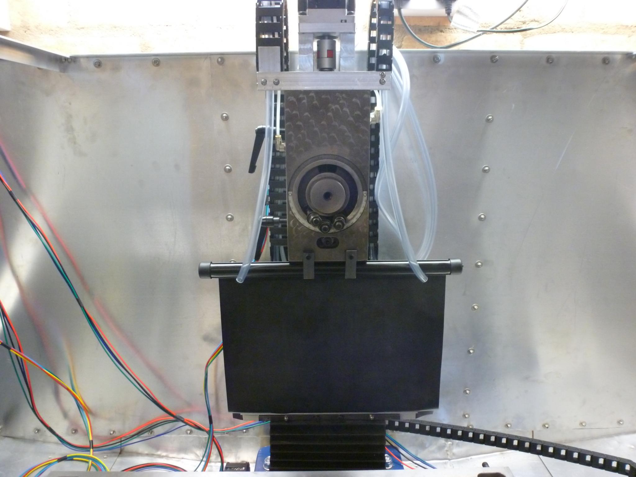

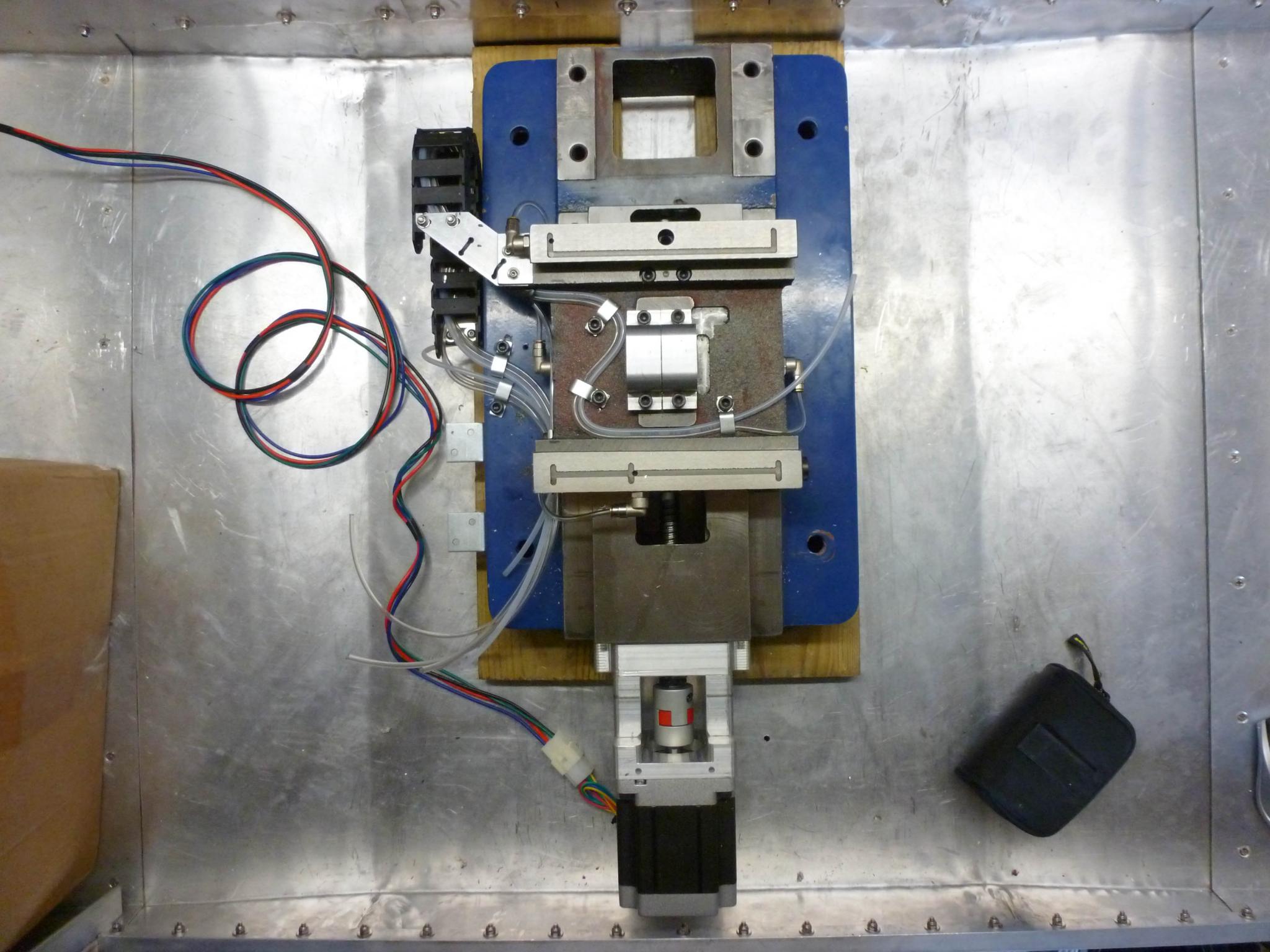

  10. #20

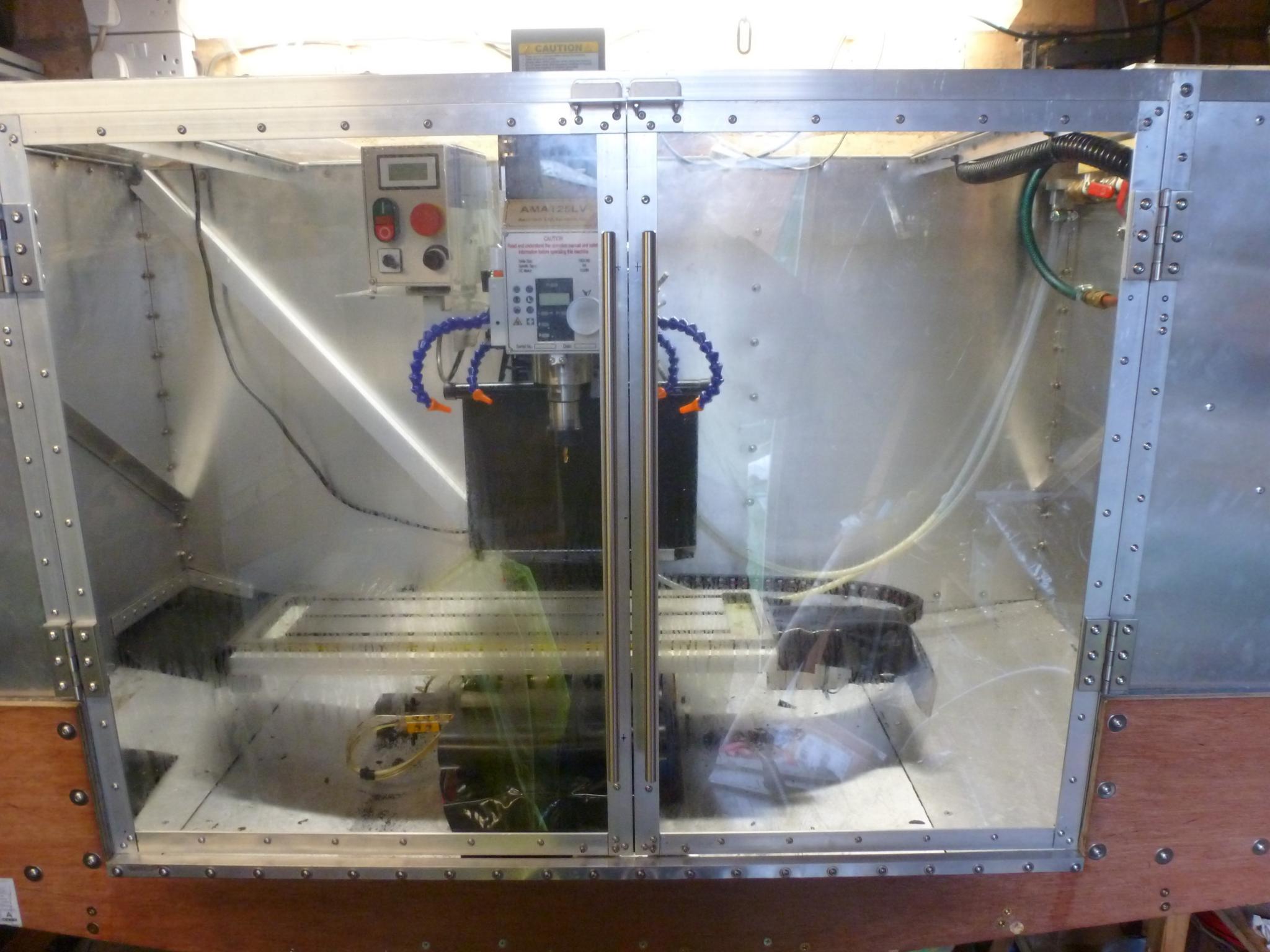

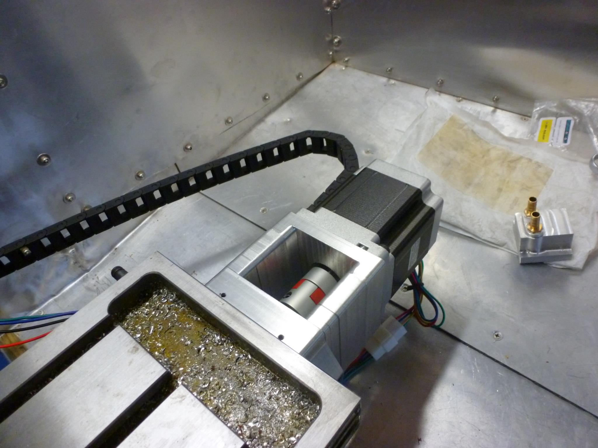

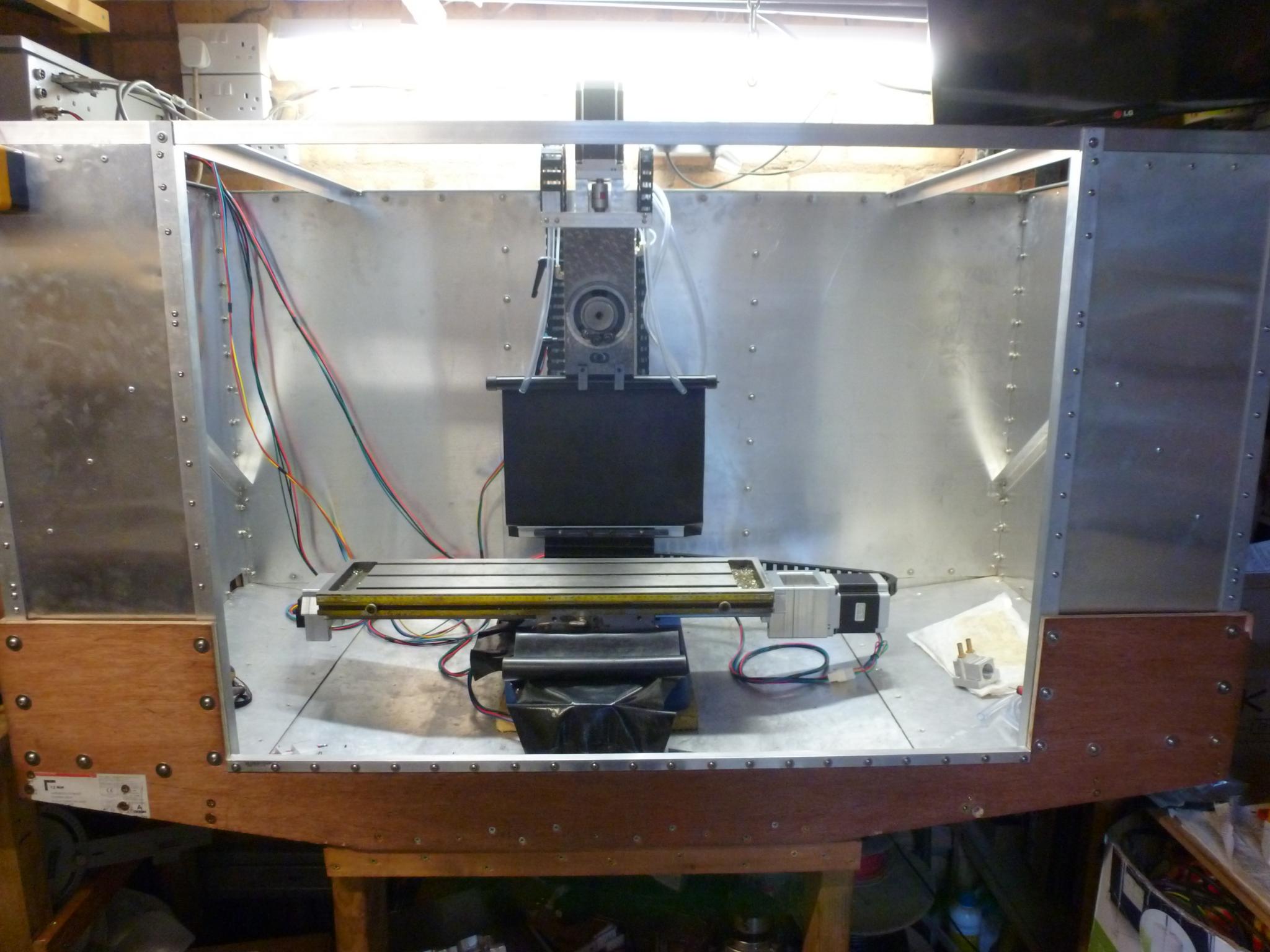

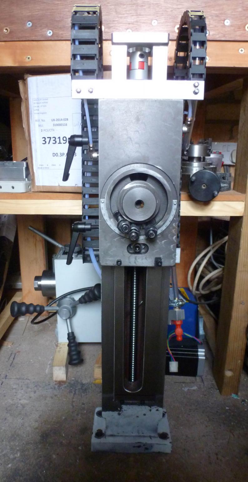

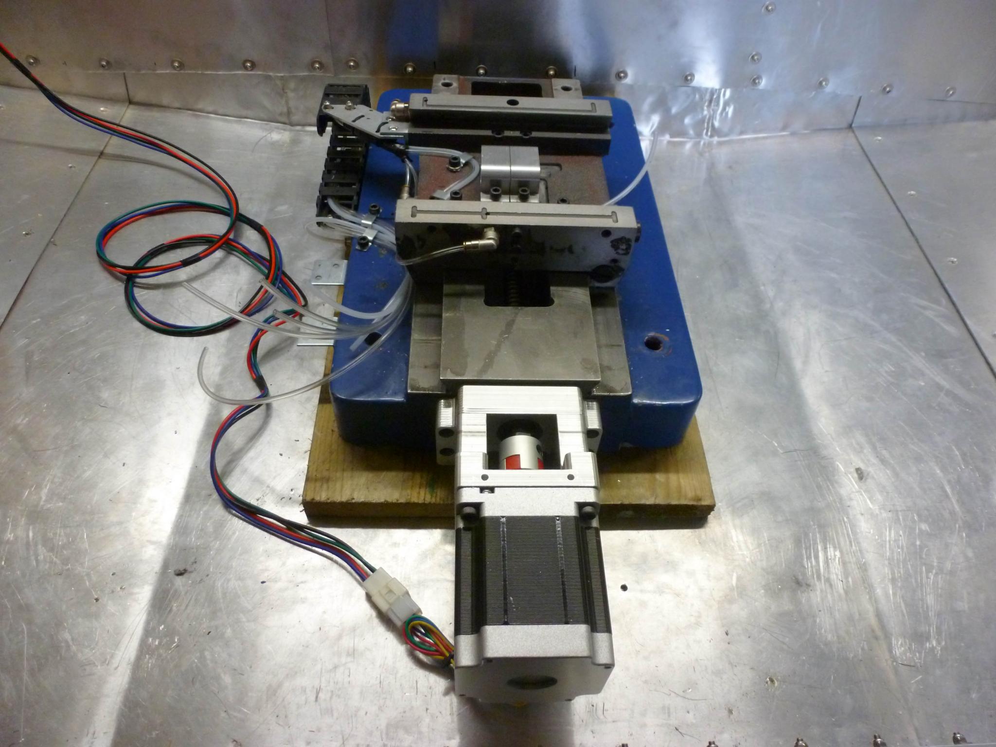

    I've only just finished my AMAT25. Hopefully start testing it out this week, time permitting.
