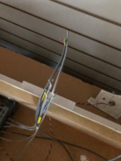

    I am looking for advice/help on repairing my cnc router. I have had the machine for 3 years now and never had any problems ( touch wood ) however having recently moved the machine ( due to relationship split ) i noticed there had been some damage caused ( maybe intentionally !!) .
    The Connection that came from the drive board to the PC . I believe it was a 36pin connector where the series of wires had been soldered to . So i am now left with around 18 lose connections . Honestly i have no idea where to start , with sourcing the correct replacement connector and where each of the wires is then connected so any advice would be greatly appreciated ?
    on the other hand does anybody know of another way around this , like can i buy a replacement unit to avoid any re-wiring etc as i am a complete novice in these aspects !!
    or does anybody know of a company/persons that i could contact to repair.

    Hi caldwell22,
    Is it the standard printerport from the pc to the bob cable?
    Those should be pretty standard pinout.
    Are you running mach3 ?
    What bob or controller do you have?
    People need more info to be able to help you with this one :-)

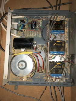

    Hi Adam
    what Geckodrive stepper drivers do you have ? the photos not clear enough to read the model number

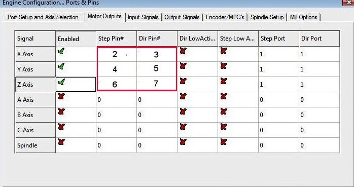

    What control software are you using Mach 3 ????
    ( looking in the ports & pins you can see what functions have been assigned to the pins so you can wire the controller the same as before)
    what PC are you using ?
    assuming your machine connected to the PC's parallel printer port
    its possible that the wires where connected directly to a 25 pin D-type plug
    but I would use a breakout board & 5V power supply to buffer the outputs from the printerport and make the connections easier and avoid soldering to a 25 pin plug
    if thats a 12V fan next to the stepper drivers you are missing a 12V power supply
    John

    is this the stepper drivers in your control box ?

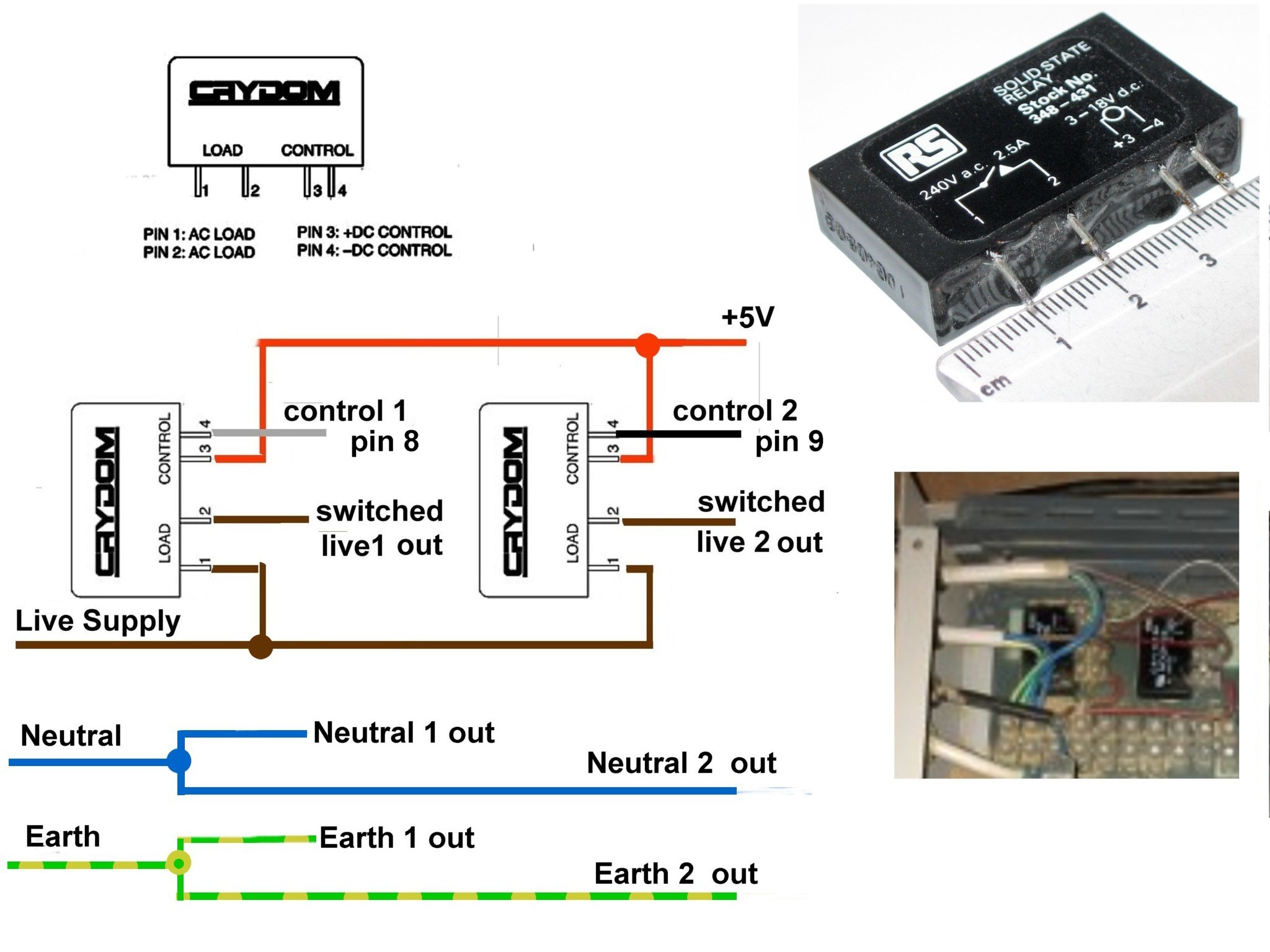

    do the two solid state relay switch the spindle & dust extractor ON & OFF
    with no control of the spindle speed
    some thing like CNC4PC's
    C10 break out board should do all what you need

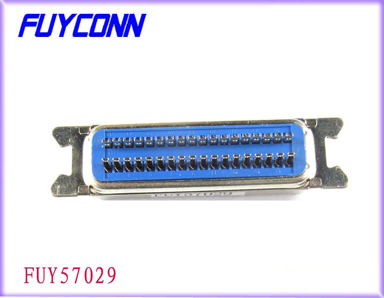

    HI ,
    Thanks for your reply , yes that's correct the cable from the printer port went to a female 36pin connection then from the cnc those series of wires went into a male 36 pin connector. This is where all the wires were soldered too . Click image for larger version.

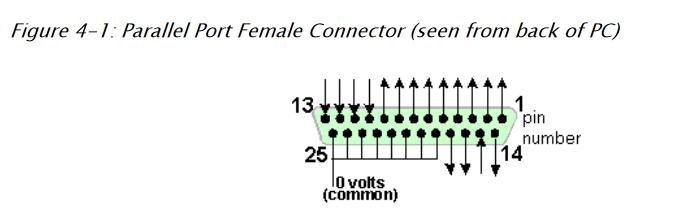

    Yes , in Mach3 the first printer port can only provide 5 inputs (for E-stop & limit switches etc)
    and 12 outputs that you can assign to control your motors , relays etc
    printerport pinout
Name:	from page 34 of mach3 manual.jpg
    PDF manual
    http://www.machsupport.com/wp-conten...all_Config.pdf
    I assume when your machine was built
    printers and printer cables had the original 36 way Centronics connector
    to connect to your PC's 25 way D-type printer socket

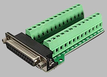

    use a 25 pin male to male printer cable and
    to save soldering a connector / adaptor like this :-
    https://www.ebay.co.uk/itm/222305065110
Name:	25 way D-type socket with screw terminals.jpg
    the 25 way D-type connector are less expensive than 36 way centronics connectors
    In addition you need a +5V supply to connect to the G201 stepper drivers & solid state relays
    this can be taken from your PC
    as can a 12V supply for the fan
    John

    this is the Mach pins & ports page to find the pins assigned to control your stepper motors
Name:	ports & pins.jpg

    John ,
    Thank you very much for all your help .
    I will order the c10 break outboard and wire as stated in the ports/pin lay out in mach3.
    Then i assume i will need the adapter you have linked on ebay to connect to the pc printer port cable. so will order those .
    the limit switches that are in place on the machine have never worked since ive had it so will get those up and running all at the same time using the attachments you have provided.

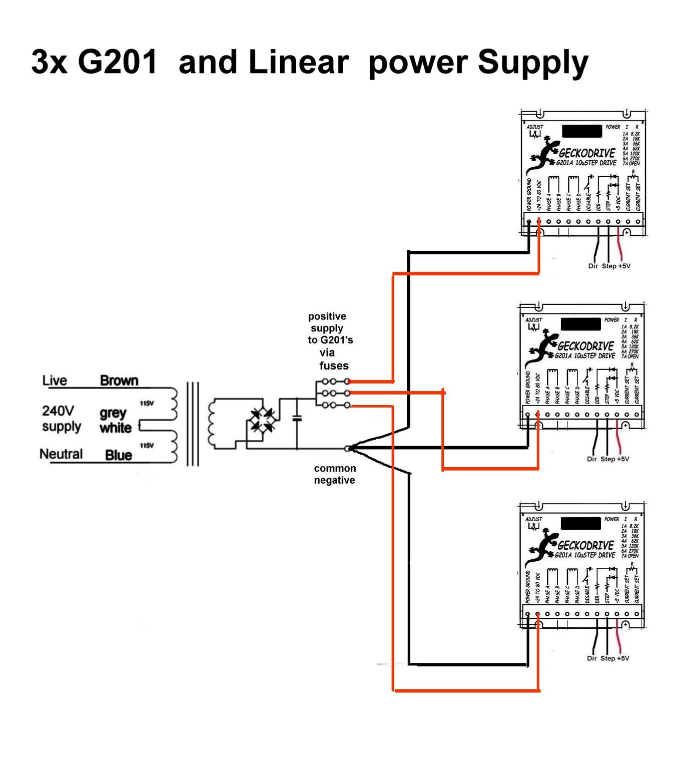

    Hi Adam
    while your photo is a bit too low a resolution
    this a little more of the wiring of your box
    from what I can see
Name:	control wiring.jpg
Name:	G201 and power supply.jpg
Name:	SSR connections.jpg
    John
