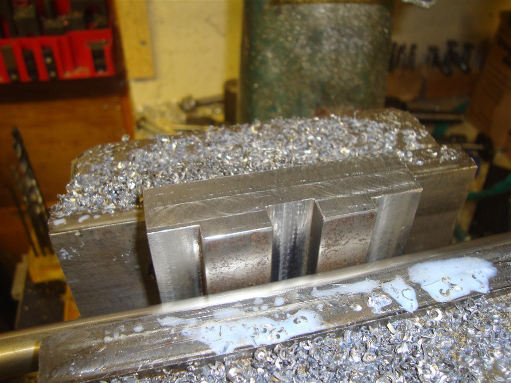

    Not a chance of getting an RM1204 ballnut in the cross slide, let alone two, so I've mounted them behind. To do this I milled a block of steel to extend the saddle for the ballnuts' mount and drilled it:
Name:	DSC09374 (Medium).JPG

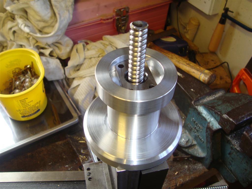

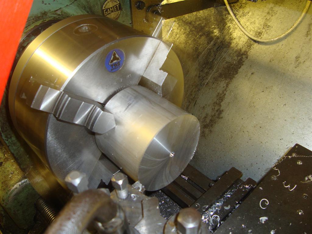

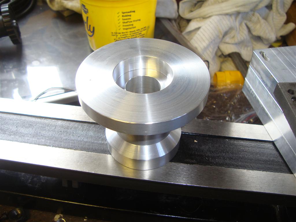

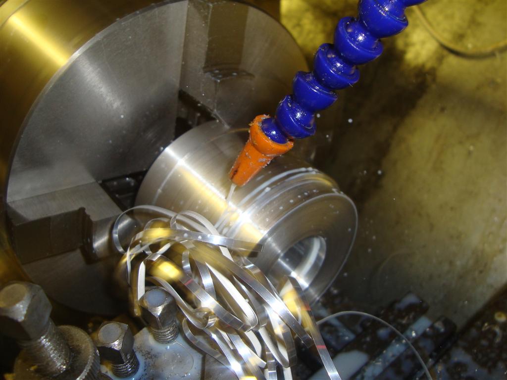

    Next I turned some 3.5" aluminium bar to accommodate a two ballnuts, one in each end:
Name:	DSC09376 (Medium).JPG
ID:	5872Click image for larger version.
Name:	DSC09378 (Medium).JPG

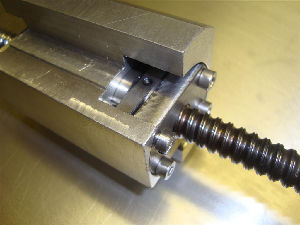

    One ballnut fixed in this side:
Name:	DSC09382 (Medium).JPG

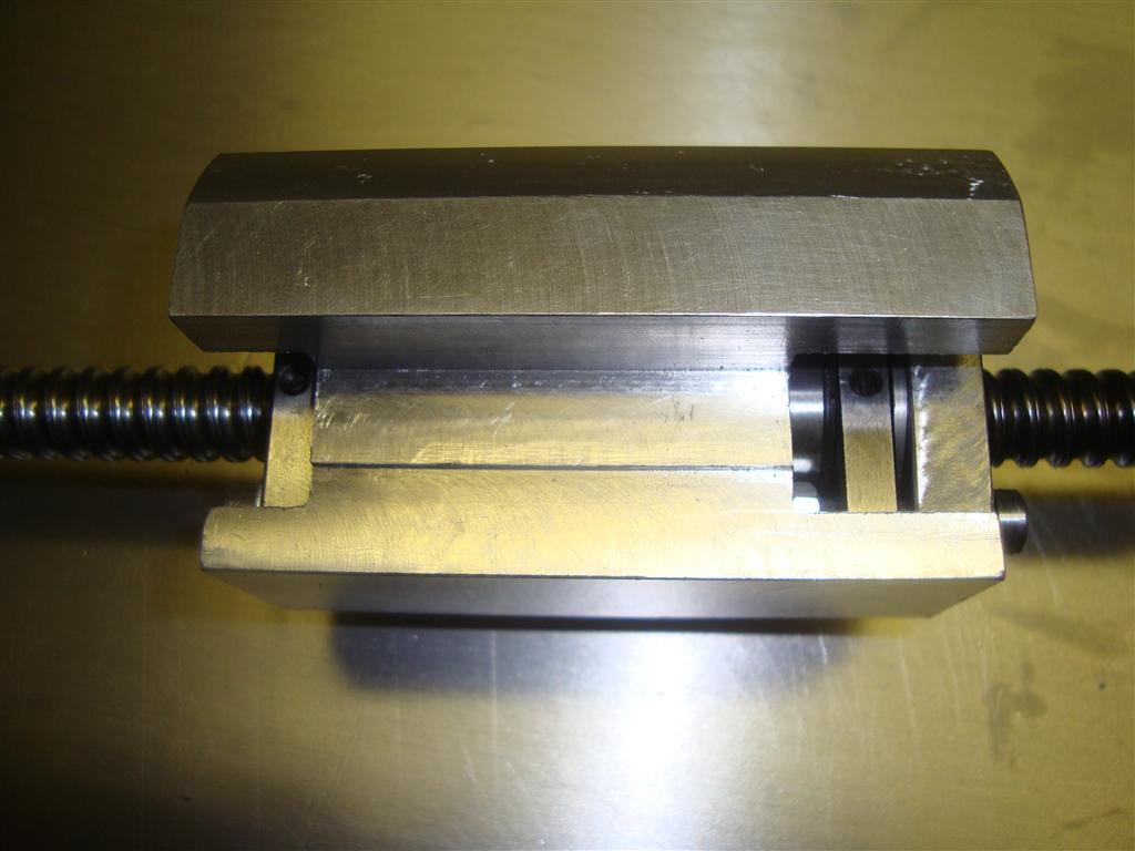

    The other goes in this side. On 'top' of that goes a steel spacer, then and end cap to accommodate a pair of beleville washers. This cap is bolted through the ballnut to apply a preload of about 300N and rotationally constrain the ballnut:
Name:	DSC09383 (Medium).JPG

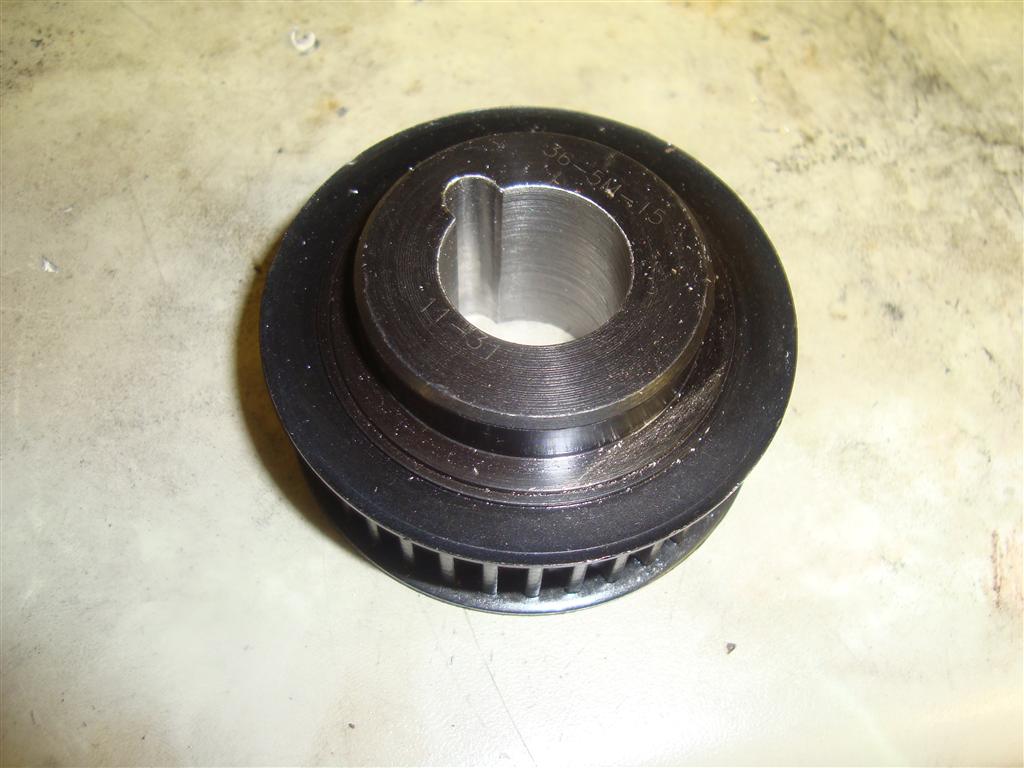

    Cut the aluminium motor mount on my CNC router. Just a few 5/8" thick aluminium plates with a cavity between to accommodate the pulleys so that swarf cannot get in the belt drive or bearings. I used a 12T pulley on the stepper motor and 30T on the ballscrew for 0.008mm resolution with a 200step/revolution stepper motor. If you count using microstepping it's a convenient 1um resolution. Once assembled I put a DTI on it and you can see the needle move for every microstep...so reasonable to assume somewhere between 8um and 1um, either way plenty good enough for this sort of machine. The angular contact bearings are held in a separate part and clamped with a 5mm steel plate also cut on my router. I machined the ballscrew with an M8 thread on the end used to apply preload to the belville washers / magneto bearings.

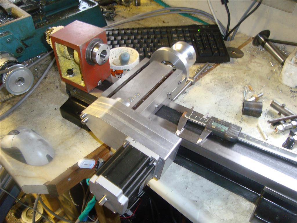

    Z-assembled, but only with one ballnut:
Name:	DSC09384 (Medium).JPG
ID:	5876Click image for larger version.
Name:	DSC09455 (Medium).JPG

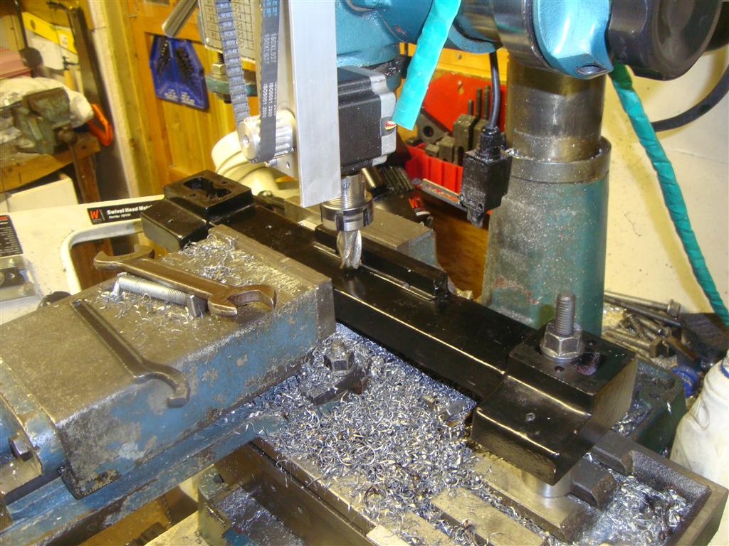

    After much deliberation I decided I couldn't get an RM1204 ballnut to fit under the lathe bed without milling some of the bed and raising it. I just milled a couple of mm off the webs in the bed to get the ballnuts to clear, so that shouldn't weaken it to much. Forgot to take a picture of that.
    Next I milled the middle protrusion off the bed stand:
Name:	DSC09418 (Medium).JPG
    Then made some 10mm spacers from ground flat stock to go between the bed stand.

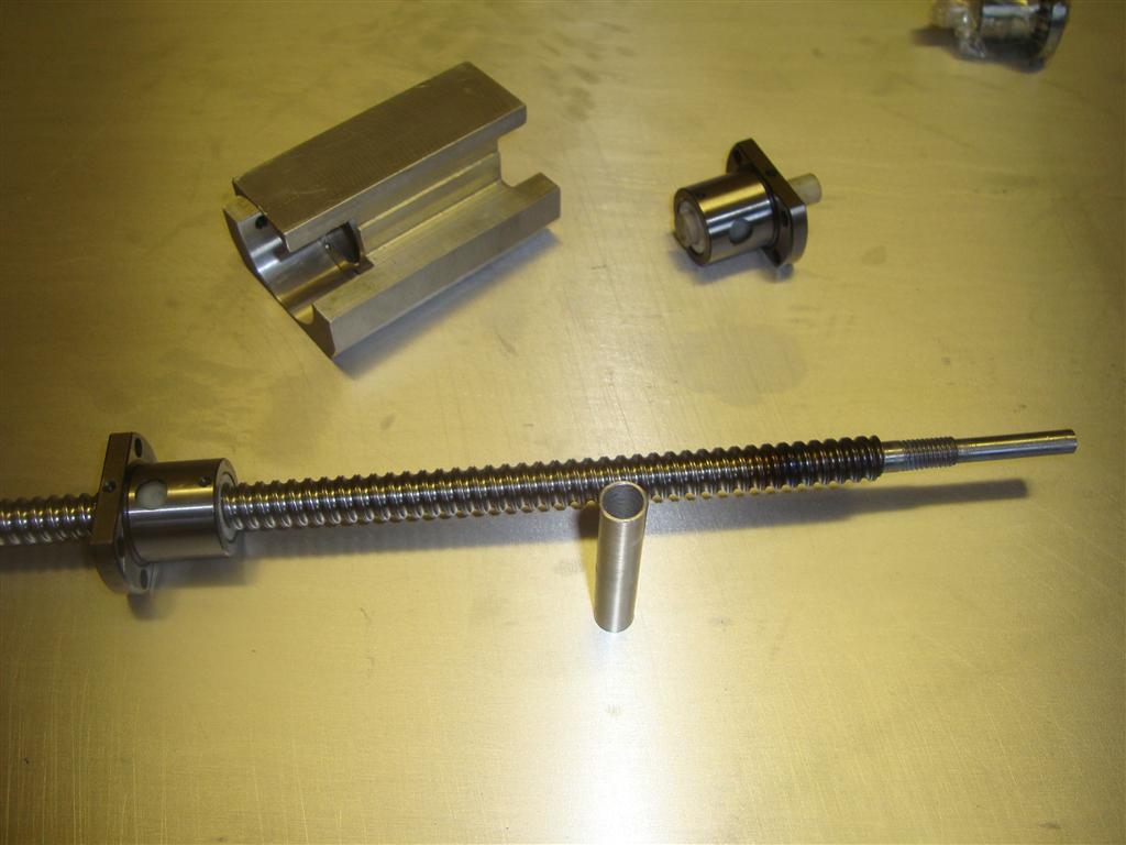

    I cut the ballnut mount from 2.5" aluminium bar. Bored, drilled and tapped both ends to accommodate the ballnuts in a similar fashion to the X ballnut. Then some milling and finishing with flycutter. Next I machined the ballscrew and made a quick tube to fit over the end and transferred it into the ballnut. This enables fitting the ballnut without all the balls dropping out...
Name:	DSC09442 (Medium).JPG

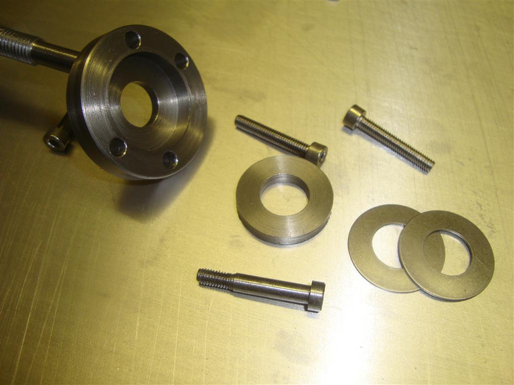

    Belville washer pressure piece and one screw machined to closely fit the ballnut on the cylindrical portion. This constrains the ballnut rotationally.
Name:	DSC09450 (Medium).JPG
ID:	5883Click image for larger version.
Name:	DSC09447 (Medium).JPG

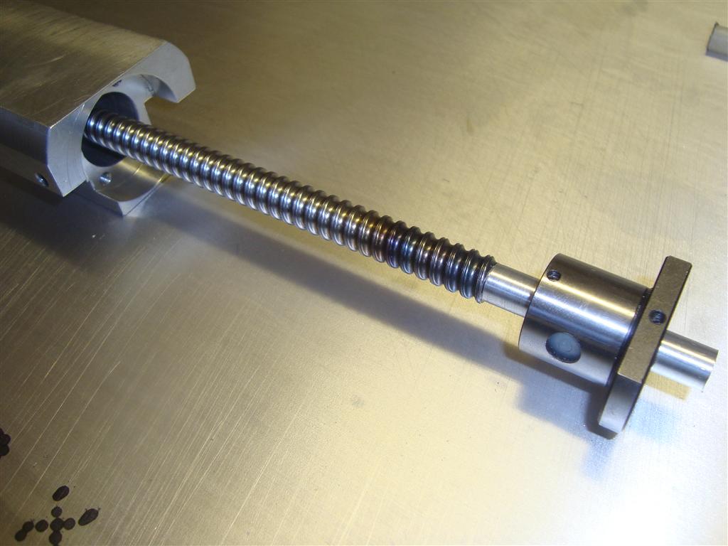

    Sliding the ballnut on:
Name:	DSC09445 (Medium).JPG
    Assembled and preloaded:
Name:	DSC09451 (Medium).JPG
ID:	5884Click image for larger version.
Name:	DSC09452 (Medium).JPG
ID:	5885Click image for larger version.
Name:	DSC09446 (Medium).JPG

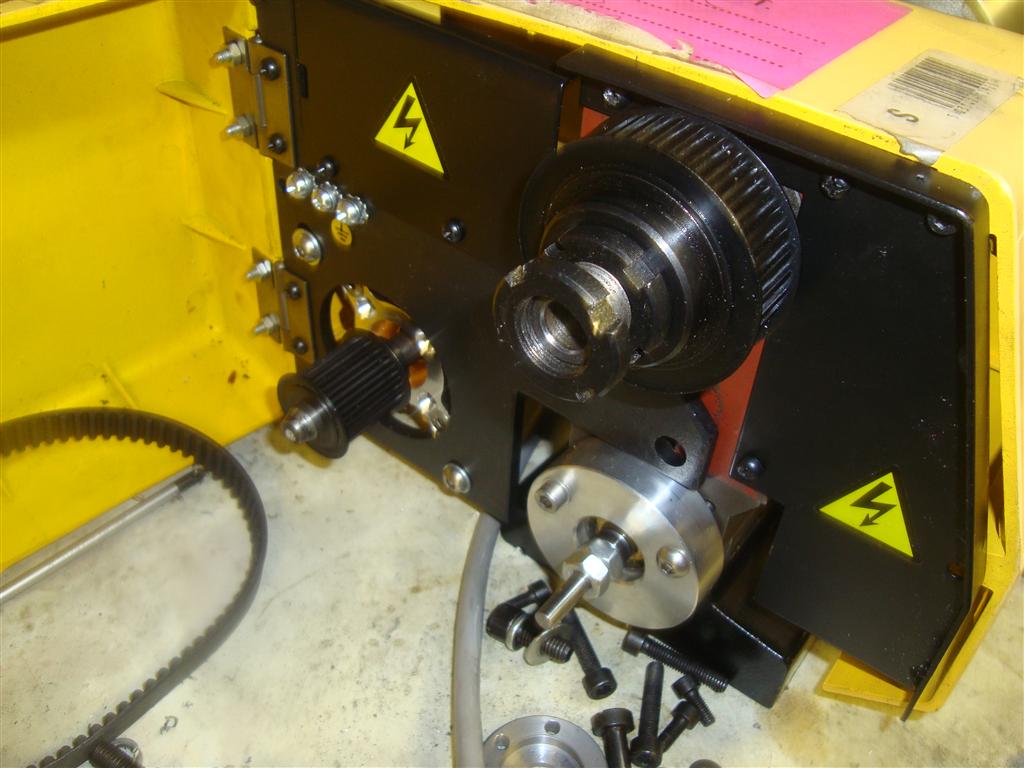

    The 6.5kW (allegedly) brushless motor I had was the same diameter of the somewhat limited 150W DC motor this lathe came with, so it bolted straight in with the mount it came with. I just had to make a shorter shaft (so the original covers fit) and machine the pulleys. Although this motor initially seems excessive, it's arguably well matched since it has plenty of torque over the full speed range, I probably wont need to use the 1:3 ratio.
Name:	DSC09460 (Medium).JPG
ID:	5889Click image for larger version.
Name:	DSC09459 (Medium).JPG

    I chose the springs based on:
    Preload force=10-20% of ballscrew static load rating
    Belleville washer compressed no more than 75%
    I stacked them like () to get greater adjustment whilst maintaining the same spring constant. The Z-ballscrew has two Belleville washers at one end, the other end fixed and one angular contact bearing on each end, so the screw is tensioned. On X the end of the screw is floating, so clearly both washers and bearings at one end.

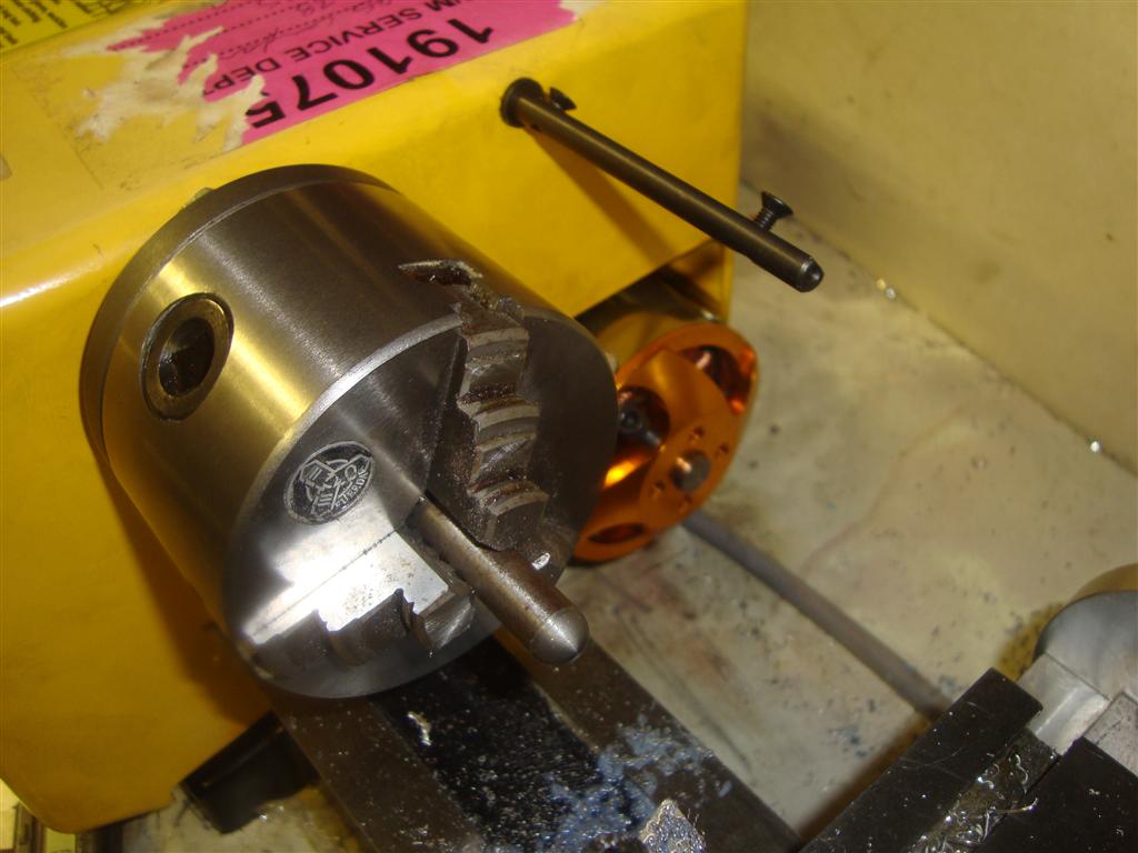

    About Ø75mm would clear the saddle, so in theory that diameter once I have found external jaws for the chuck. That reminds me I need to get/make an MT1 live centre. In practice clearly the spindle isn't strong enough to be doing that on a regular basis. I'll convert my Colchester Student lathe once this one's finished for much bigger parts.
