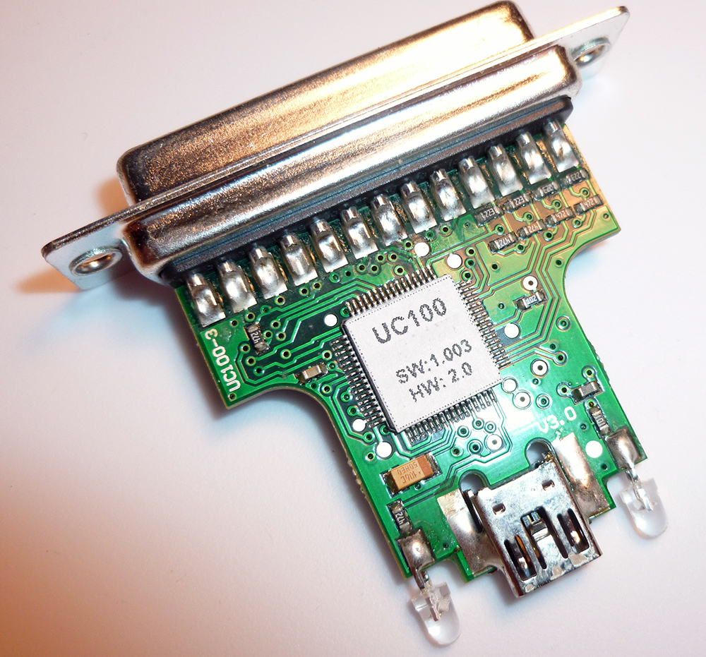

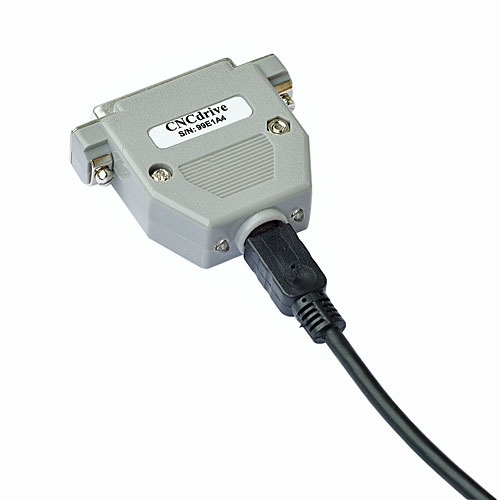

  9. #29
    so the original breakout board works with the old XP PC but not the new windows 7 PC
    its possible the W7 PC either not configured correctly or
    has a 3.3V output that is too low for the BOB
    when you tried the uc100
    what state was the green power LED & blue Communication LED ?
    inside of a uc100
    LEDs visible either side of USB connector
Name:	uc100 LEDs visible either side of USB connector.jpg
    may be the UC100 plug in is not installed correctly ??
    John
    Last edited by john swift; 21-07-2018 at 04:52 PM. Reason: add 2nd picture of UC100
  10. #30
    so whats the output on my xp and my uc100 is a bogus one thought I ordered a proper one it was sold as a uc100
    im to old to learn and to young to die
