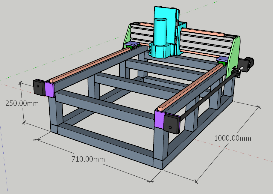

    Hello boys and girls,
    After a long long time of promising myself to build a machine, I'm finally going to do it. I hope to mill/cut plastic, wood, and hopefully some aluminium up to 6mm thick. Accuracy I'm aiming for is around 0.1mm if possible.
    Here is my machine plan. I would love some constructive criticism.
    Specs:
    Y-axis supports are 40x80 extrusion.
    X-axis gantry is 80x120mm heavy duty extrusion.
    Gantry side plates are 10mm aluminium plate.
    machine base is a tooling plate of 10mm aluminium. It has a few holes here and there, which I've modelled in sketchup, so excuse those please.
    Final working area is around 440x280mm, but if I can find a bigger base plate, that would be great.
    Motors: I'm not sure, but probably around Nema 23 size, perhaps 4Nm?
    Rails will be 20mm Hiwin, or Chinese, depending on price.
    Ballscrews will likely be 1605.
    Would someone be so kind as to critique my build please? :) Note that I haven't included the ballscrews for the x and z axes yet. Still working on positioning those. Ideas?

    Hi Nealieboyee,
    Good to see you going for a build.
    Like me i think you will like building a machine your self.
    Things i see that a lot of people do different.
    Move the horizontal rails on gantry to top and bottom of the profile instead of front side.
    The downside is that it will raise the height of the machine some 5cm
    Move the vertical rails to the moving part of the Zaxis.
    These changes will be more rigid and the spindle moves closer to the gantry
    Please take a look at the routercnc mk3 and the Davek build.
    Would end plates connecting the base plate to the Xaxis, to get the Xaxis profiles a little more rigid, be a good idea?
    https://r.tapatalk.com/shareLink?url...2&share_type=t
    Grtz Bert.

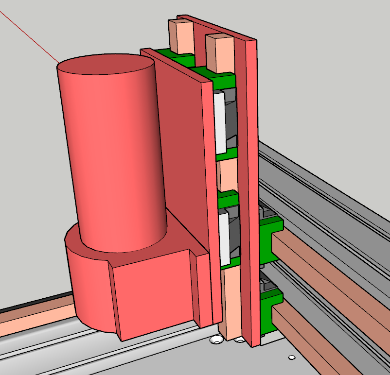

    Thank you for your kind words :) I've moved the x axis linear rails to the top of the gantry as suggested. I've also rotated the base plate to give me more usable space in the x direction. If I can find a bigger base plate I may use that, or even welding a steel frame....We'll see soon.
    I've also added bracing from the y axis rails to the base plate. Do you think it would really help on the x axis too? Those braces also serve as the new plates for the bearing supports for the ballscrews.
    As for the z axis, I've moved the linear rails to the moving part of the axis and added side supports to give a bit more strength.
    Anything else that jumps out at you?

    Hi Nealieboyee,
    Yes like that. maybe make a full box around the gantry... just make sure no play can occure... i think you have draw side plates for that.
    So what size materials would you like to machine? Z is kinda low..
    Clamping solution and spoilerboard accounted for?
    So is there a butget reason to go stepper direct mount on the bascrews?
    If not, 1610 with belt pully reduction 2:1 is popular for several reasons.
    15 teeth on stepper, 30 on ballscrew.
    BTW what are the cutouts for in the base plate? now they reduce rigidity and make the endplates redundant.
    So is the size set or still looking for the right parts to come by?
    The best advice ever offered by this forum:
    Dont buy any electronics kit / balscrews / rails , before plan is completely done and everything fits in cad.
    More experienced forum memeber can help you pick steppers psu and so on.
    I only bought stuff when i ran out of work on every step.
    This saved a lot of money for me.
    Grtz Bert.
    Quote Originally Posted by driftspin View Post
    Hi Nealieboyee,
    Done and done :)
    I'm not too fussy on size of material. Obviously the larger the better, but space will become an issue. I've resized the machine, as shown in the images. Final footprint is now 1000x700mm..ish. Thats about as big as I can go. The spoilboard...I was thinking of 25mm MDF? Maybe incorporate that tooling plate full of holes into there somewhere. If, IF I can get my hands on enough free 40x40mm extrusion for a surface, then I may make bolt-through hold downs using inserts.
    Not really. I didn't even think of using belt reduction. What would be the reason to go for that over direct coupling? Resolution? As for budget, I'm putting most of it into decent linear rails and bearings, as well as the electronics. I'm trying to build the frame and mechanical side of the machine as cheaply as possible, using mostly offcut 10mm and 12mm aluminium plate.
    Yeah I've gotten rid of the base plate now. It was just a bit too small to give me enough cutting area for the size of the machine.
    As of now, the size is set at 1000x700. I'll be using 80x40mm extrusion that I may be able to get my hands on for free. If not, I'll weld the frame from 50x50x3 steel box section.
    If you can get 90x45 extrusion you will find that the spacing holes on the BK12 and BF12 bearing blocks will line up with the slots in the extrusion

    Don't make the Z clearance and maximum Z movement too small because you are going to regret that. Anything less than 15cm is too small in my opinion.
    Hello all,
    Been a while, but this is still being built. My linear rail, bearings, ballscrews, supports etc from Fred at BST should be here in a few days. Can't wait. I've changed my design a little bit. It will now be bench mounted, so the base is a lot shorter. See below. I've also swapped out the aluminium extrusion in favour of 50x50mm steel box section. Space isn't a major problem, so I don't have any problem with the motors sticking outside the envelope of the machine. Other than that, is there any other reason I should go with belt driven ballscrews?
    Any thoughts?

    Hi Neely Boy,
    What is your free Z height ?
    Looks like there will be very little room left for clamping solution spoilerboard and length of the cutter...
    Maybe you could lower the bed in your design a little to free up some space.
    What material thickness are you looking to cut?
    Beltreduction has some advantages.
    -Foot print
    -Option to change steps per mm later on.
    -Noise reduction.
    -Less stepper vibration transfer to cutter.
    Also you can gain speed vs ballscrew rpm
    when you raise the pitch of the ballscrew
    and "belt pulley reduce" the ballscrew rpm vs stepper without losing resolution.
    This is usefull when you hit the critical rpm for a given ballscrew/pitch vs speed.
    Also some high pitch screws tend to be more efficient.
    But since you already ordered this is a non issue..
    Did you order ballscrews prepped for pulleys? I ordered mine with a slightly longer F lenght shaft... 30mm of pulley shaft.
    Hope this helps.
    Did i forget anything?
    Grtz Bert
