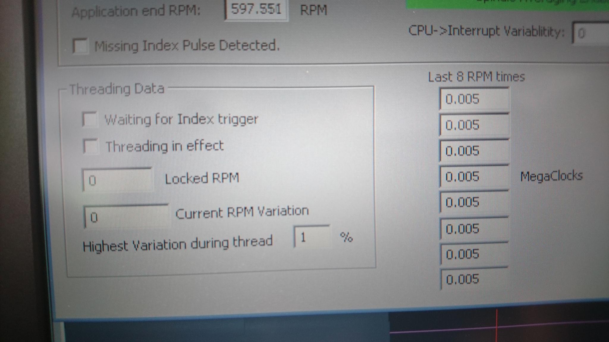

    The STrue is always slightly out unless I run it in closed loop spindle control mode.
    I tried running the threading program at 200 rpm but again it wouldn't actually start threading.
    On the Diagnostics info screen the "missing index pulse detected" remains unchecked so I think there is no problem with that.
    However I just noticed that the "rotation speed real-time" is about 180000rpm
    Whilst the "application end rpm" is 598ish.
    Would this be a problem?
    I've attached a photo of this screen in my original post.
    Okay I think I found the problem (or a symptom) but I still need the cure :)
    So I noticed that on the turn diagnostics screen the "Locked RPM" and "current RPM Variation" read 0 and "Highest Variation during thread" reads 1% when the Spindle Feedback is disabled. This is when the program will run the threading but with poor results.
    However, when the Spindle feedback is enabled, all of the above fields on the diagnostic screen read " 1.#INF "
    Please have a look at the attached picture.

    I have a feeling that for some reason mach3 cant syncthe threading to the spindle speed.
    I found a thread describing the same problem here:
    http://www.machsupport.com/forum/ind...79.0/wap2.html
    The person having this problem managed to sort it out just by fiddling with the sensor wiring. I've tried rerouting the wires but to no avail. Is there anything else that would cause the syncinc to fail?

    I'm not sure on the reliability of the threading diagnostics page.
    If you open the diagnostics page with all the LEDs, does the one for the index go on/off as you manually move the spindle slot through the sensor?
    It does sound like you've got a sensor problem. How big is the slot you're detecting?
    Can you run the spindle any slower than 200rpm?
    If it works at really slow speeds, it could be as simple as needing the slot enlarged.
    Yes, I can run it slower than 200 rpm. And yes, the index led flashes as I move the spindle by hand. I used to use a slotted disc with a proximity sensor, now I'm using a magnet on the shaft with a hall sensor. The pulse is nice and long, the rpm readout is stable even on max speed (about 1800 rpm).
