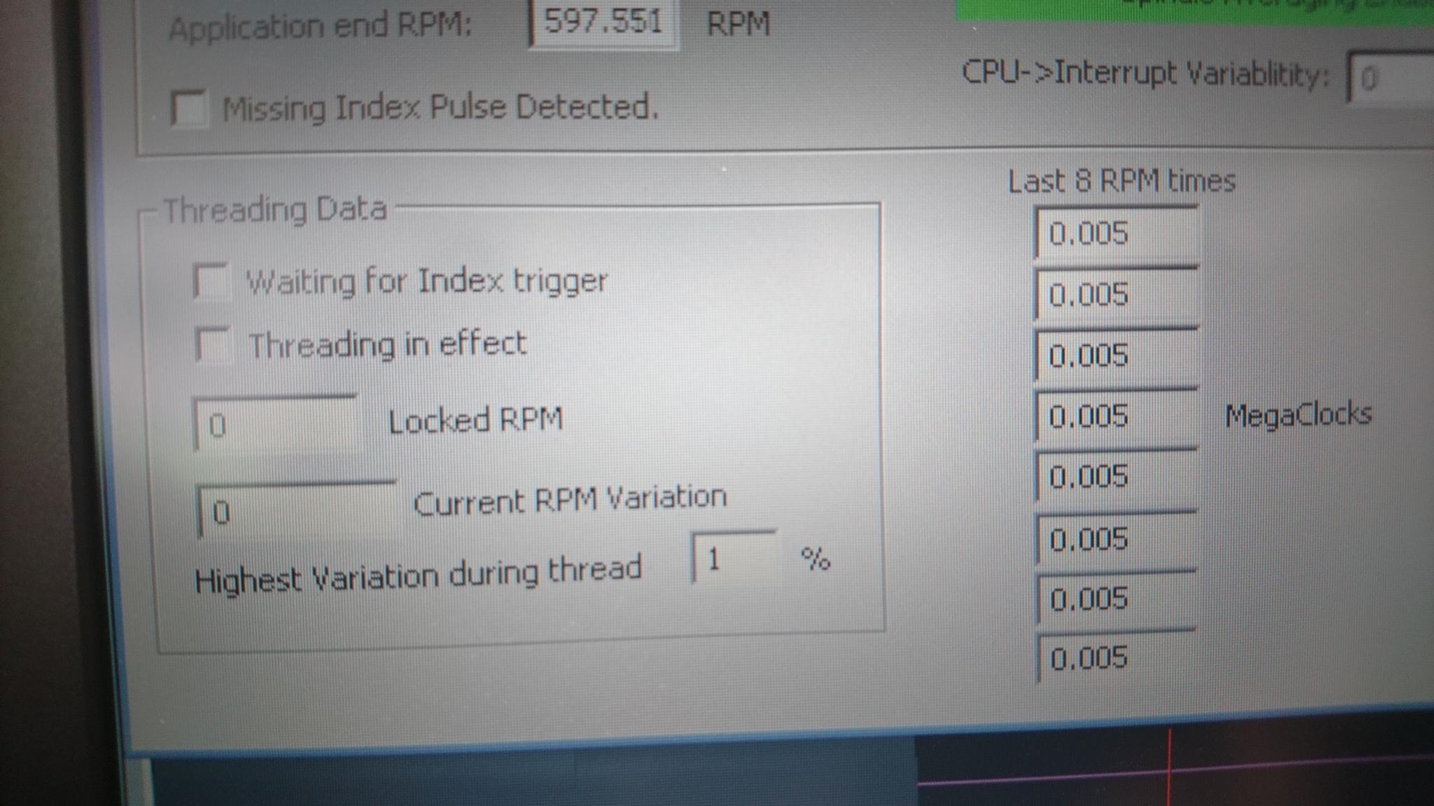

    Just before I go spending £££ on more stuff, there is this thing that keeps bugging me.
    Like I said in the original post:
    If I have the "Use Spindle Feedback In Sync Mode" checked, the program starts to run but pauses just before it is about to cut the thread and sits there waiting for something I assume.
    From what I could gather reading forums, people say that this option should be ticked for threading.
    Does anyone know why this is happening?
    Thanks!

    What should happen with Mach3 threading, is the tool moves to the start point, it then waits for the spindle speed to stabilise, and then the threading move should synchronise with the spindle pulse.
    However I did just remember, if Mach calculates that the axes can't respond quick enough to the spindle speed for the given move, then motion will just hang. It could be worth dropping the spindle speed down a good bit, and re-running the code.

    Just had a search, there is a quite a good threading guide here - http://www.machsupport.com/forum/ind...c,13017.0.html
    However it doesn't cover that much of the setup, and even the main turn manual (http://www.machsupport.com/wp-conten...3Turn_1.84.pdf) is a bit sparse on details, other than saying the pulse has to be a minimum of 200 microseconds. Battwell is correct in that multi-slot doesn't work, so ignore that.
    Battwell, the 5ms is likely to be the sensor response time, which is another often overlooked problem. I always used sensors from a reputable source with known response/trigger times. I've seen some sensors that have quite a long response time, and some from cheap sources give no figures, so are a bit hit or miss as to whether they work reliably. They also have to switch cleanly, which can be affected by non ideal sensors, and any optos in the signal chain (some BOBs use low speed optos, which may increase response times).
    You just need to work through everything one step at a time.
    Is the index pulse being fed back reliably?
    You mention you have the RPM displayed, but is it accurate. Unless you're running closed loop, it should always be off from the requested RPM by at least a few RPM. From what I remember, Mach will show the commanded speed by default, not the actual speed.
    Also, is the index LED going on and off on the diagnostic page when you move the spindle slot back and forth through whatever sensor you're using?
    Are your axis tuned to accelerate/decelerate fast enough?
    If they're set too slow, Mach will calculate they can't move fast enough, and just hang at any threads. Try running the spindle as slow as possible, and air cut a very small pitch thread. If it works, then check your motor tuning. Lathes will appear to run very well with low acceleration, it's only when you try threading that the poor acceleration will show.
    If none of that shows a problem, then post on the machsupport forum. There are guys on there who know far better about potential problems than on here.

    The STrue is always slightly out unless I run it in closed loop spindle control mode.
    I tried running the threading program at 200 rpm but again it wouldn't actually start threading.
    On the Diagnostics info screen the "missing index pulse detected" remains unchecked so I think there is no problem with that.
    However I just noticed that the "rotation speed real-time" is about 180000rpm
    Whilst the "application end rpm" is 598ish.
    Would this be a problem?
    I've attached a photo of this screen in my original post.

    Okay I think I found the problem (or a symptom) but I still need the cure :)
    So I noticed that on the turn diagnostics screen the "Locked RPM" and "current RPM Variation" read 0 and "Highest Variation during thread" reads 1% when the Spindle Feedback is disabled. This is when the program will run the threading but with poor results.
    However, when the Spindle feedback is enabled, all of the above fields on the diagnostic screen read " 1.#INF "
    Please have a look at the attached picture.
    For some reason I can't attach the other one with the fields reading the " 1.#INF "
    I have a feeling that for some reason mach3 cant syncthe threading to the spindle speed.
    I found a thread describing the same problem here:
    http://www.machsupport.com/forum/ind...79.0/wap2.html
    The person having this problem managed to sort it out just by fiddling with the sensor wiring. I've tried rerouting the wires but to no avail. Is there anything else that would cause the syncinc to fail?
    Many thanks!
