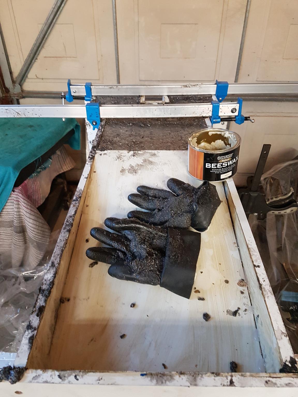

That was a great idea with the lathe cross slide although I couldn't quite get it to work, having issues with its size. I ended up getting a mag drill... Drilled 60 holes and tapped for the insert bolts.
Mould made and epoxy poured, all 150kg of it. Got it done in about 90 minutes with two of us. Had some slight issues, no vibration, we ran out of pigment towards the end and the mould blew out on one side. But overall went ok, if anyone wants more details on how to go about this I could write a more detailed post / video.
Will probably de-mould tomorrow.
