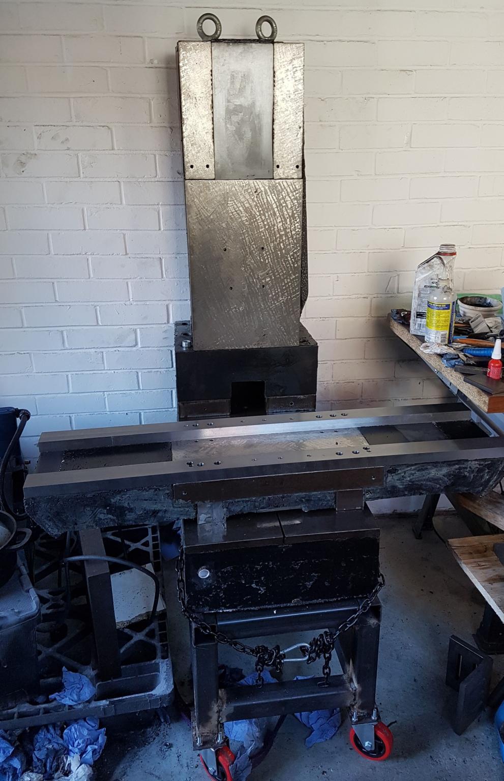

    Some progress:
    It started to look a bit like a mill:

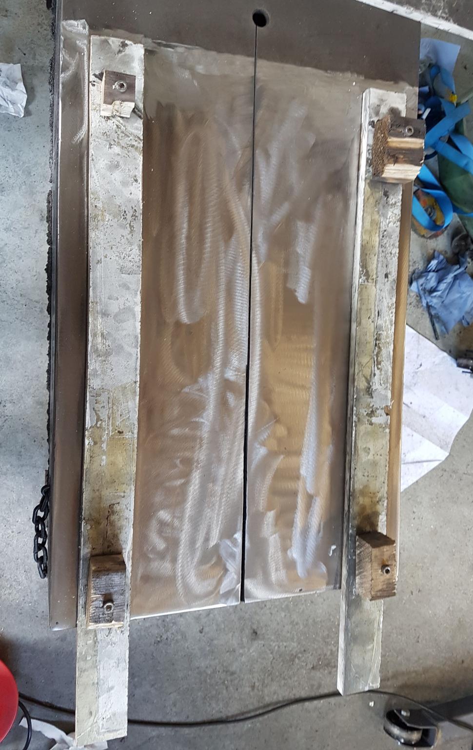

    Next step was to flatten the base casting so I could get the rails on. It was to big an area to scrape and the reference surface and base were to heavy to invert. So I blocked off two rail sized areas with wood and then used an angle grinder to lower the rest of the surface, a bit crude but worked well.

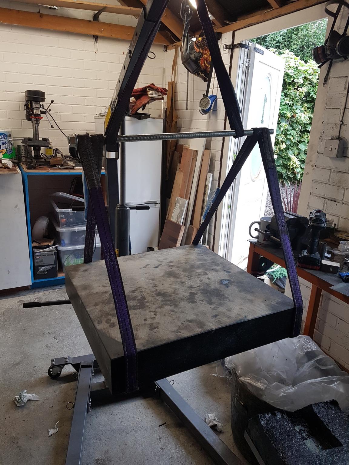

    I then flipped my surface plate and lowered it onto the base. It wasn't that far off, you could see damage from the previous owners of the surface plate.

    After several rounds of scraping, it is flat to about 0.02 - 0.03 mm

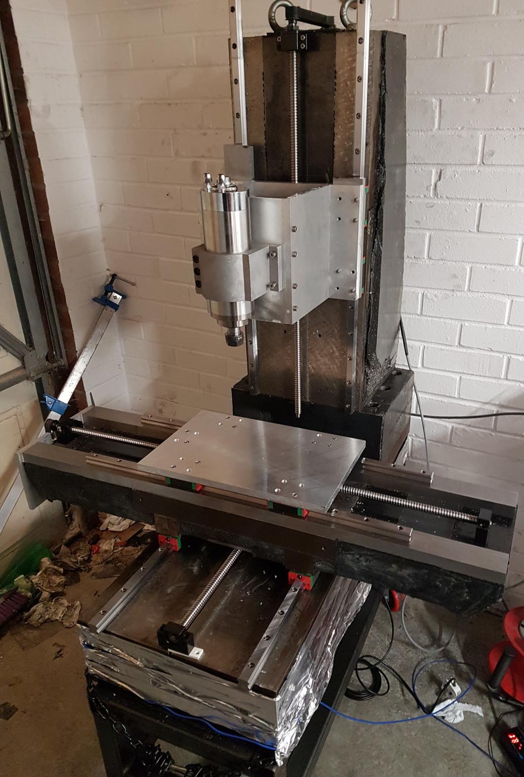

    More progress, rails installed, steppers installed on temp 3D printed mounts, temporary head and spindle.
    First axis movements (Y axis not working):
    https://www.youtube.com/watch?v=rAVX...ature=youtu.be
    Next steps:
    Alignment, use mill to mill better mounts, mill permanent head BT30, servos, way covers.
    Does anyone have any experience with the cheap AC servo's on aliexpress? In particular the 60ST-M01930? Not found much on these.
    Has anyone bought way covers from aliexpress? I was thinking about getting some "Armoured bellow cover"?
    Nick

    Chaz - First movements have been very rewarding, hoping the pace picks up now.
    I'm near Hull about an hour from Goole, that's a very kind offer, it might be a while till I could get over. That's reassuring that you've got them to work. I'm having a hard time making sense of the Chinese-English hybrid manual. I would be using them in the "position mode" initially, have you had any issues with overshoot? Are you using "open collector input mode" or using the suggested "AM26LS31 similar line drive"? Or 0-10v? I found the below video, which was bit concerning having to play around with the internal PID settings...

    Jazz thank you for your post, this makes a lot of sense, you've reassured me re the servos. I've decided on using the analog interface with Linux CNC, mesa 7i92 and 7i77 with the controller closing the outer loop. I might need some help with the tuning. I've bought 600w for the X and Y, I have also committed to the BT30 spindle with a 1.8 kw servo.
    Waiting for the servo for the spindle, pneumatic cylinder and mesa cards.
    Made a start on the pneumatics, I've gone with a "mist cooling" system using the water filter approach I found on the here, works well.
    Got a lot of time consuming jobs done, filled the spindle head with epoxy granite, got the y-axis movement working. Made a few chips with jogging.
    Next major problem is protecting the ways from chips, I've seen several designs. Would anyone be interested on collaborating on a way cover design?
