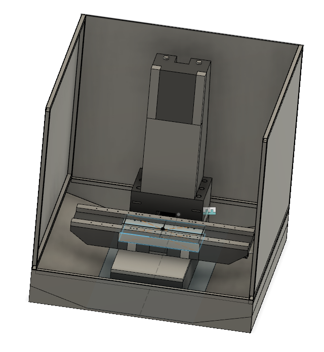

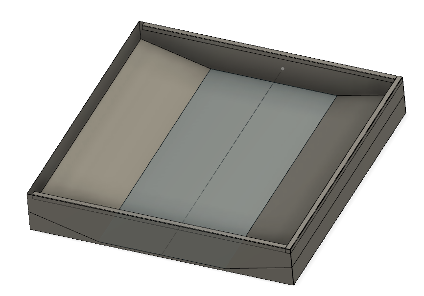

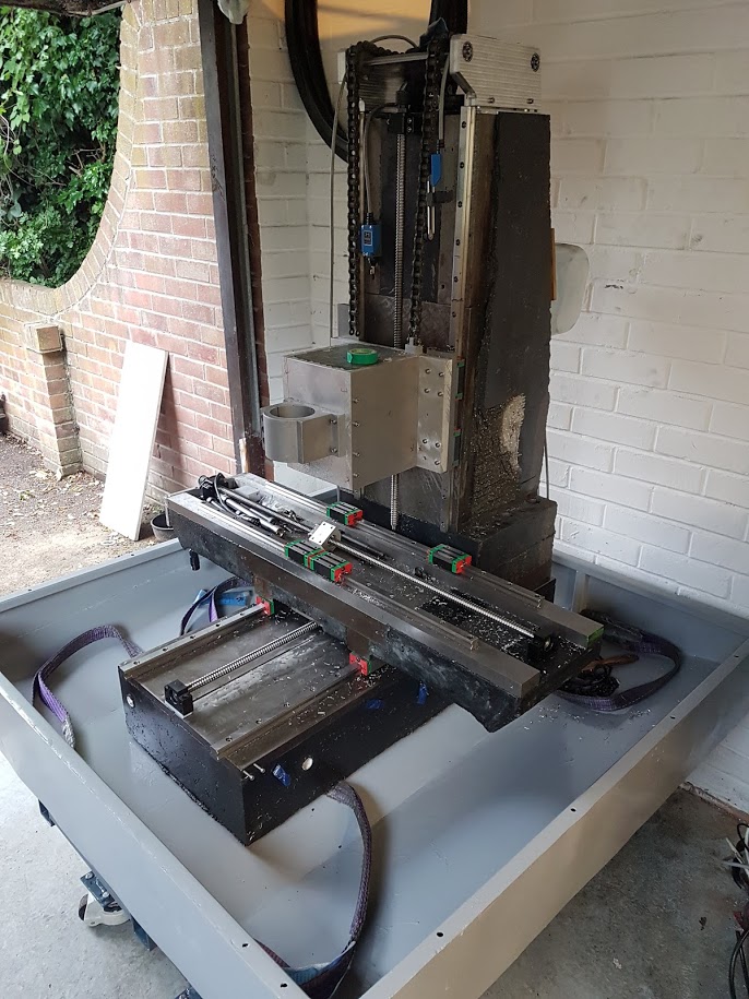

    Thank you both for the advice. I have had a lot more success. I bought an array of end mills from shop apt. I have also been using single flute end mills that I saw used on a Datron machine, these seem to work quite well, there is a bit of chatter and they make funny sounds on ramping. I've even tried filming this.
    https://youtu.be/wAAnl7nuGu8
    https://www.youtube.com/watch?v=Ozca...ature=youtu.be
    I have noticed that my setup isn't as rigid as I thought, there is nearly negligible backlash if I move the table with no force but if I apply some force to the table I can move it about 0.05mm in x and y direction, I can get it to almost 0.1 if I really lean. I'm not sure where this is coming from, I think it might be the ballscrews / x-axis belt, i'm not sure how to isolate this? I know a lot of people were having issues with the ball screw BK12 mount bearings.
    I have ordered some metal for the enclosure, I was going to try and bend sheet metal, but I've abandoned this idea and I am going to weld a frame and then bolt/weld sheet metal onto it. Not sure what to do about the doors yet, any ideas?

  7. #57
    Quote Originally Posted by Nick View Post
    Is the "funny" sound you're hearing on ramp down for the pockets, that kind of crunchy gravel sound as the tool gets below a certain point? If so I'd wager that is the tool re-cutting chips which your air is not clearing out of the pocket. I've added a second air nozzle to my machine recently to try and combat some of this, as chips love to lie in the lee of pocket walls and hide from that airstream.
    Hope that helps.
    Chris
  8. #58
    100% it's re-cutting chips when spiraling down, you need lots more air to blow them out.

    Update:

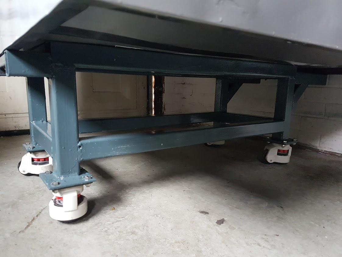

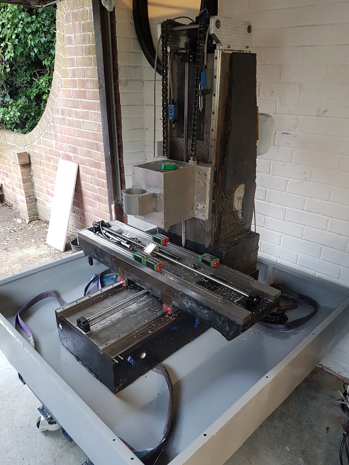

    Enclosure nearly done, the design I came up with was really stupid, it weighs loads and took forever. If I was to do it again I would used thicker sheet metal without a frame. Lots more work than I thought. I finally weighed the mill, comes out at about 700kg in total.
    I changed the castors on the frame to support the weight and so I could level the frame, spent a lot of time deciding on these. Please ignore terrible welding.

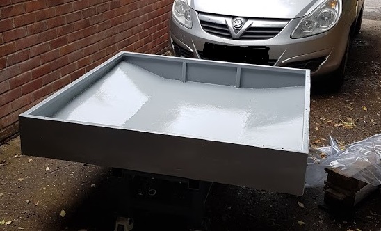

    Mill pan:

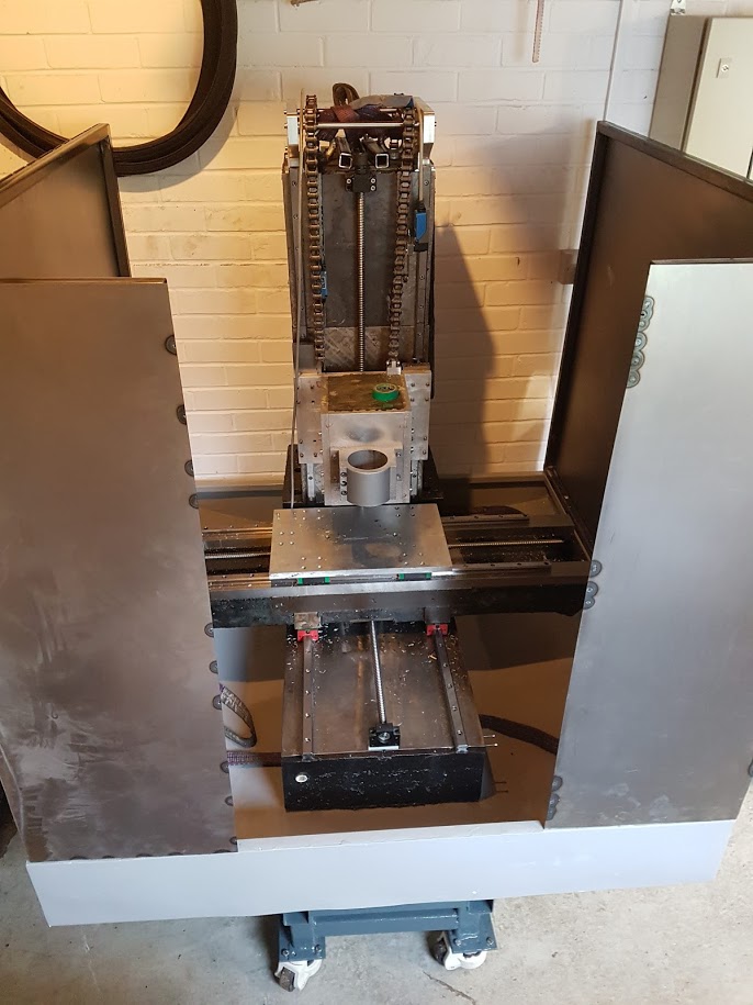

    Mill on:
    Sides on:
    Next step is to put some polycarbonate windows in the sides and then finish painting, doors after...

    Your welding is fine... it's your grinding that's awful :-)
    Those FootMaster's are brilliant, have three sets holding up three big things (lathe, 2x mill bench and my welding bench). Aim-Tools are a pretty cheap source of them
