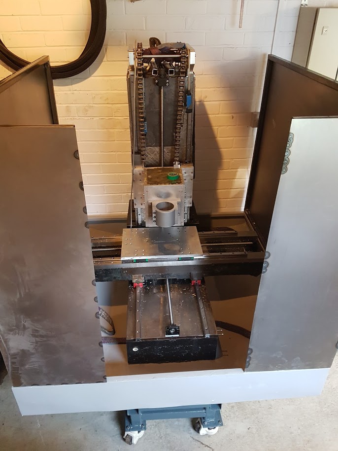

    Update:
    Enclosure nearly done, the design I came up with was really stupid, it weighs loads and took forever. If I was to do it again I would used thicker sheet metal without a frame. Lots more work than I thought. I finally weighed the mill, comes out at about 700kg in total.
    I changed the castors on the frame to support the weight and so I could level the frame, spent a lot of time deciding on these. Please ignore terrible welding.

    Mill pan:
    Mill on:
    Sides on:
    Next step is to put some polycarbonate windows in the sides and then finish painting, doors after...

    Your welding is fine... it's your grinding that's awful :-)
    Those FootMaster's are brilliant, have three sets holding up three big things (lathe, 2x mill bench and my welding bench). Aim-Tools are a pretty cheap source of them
