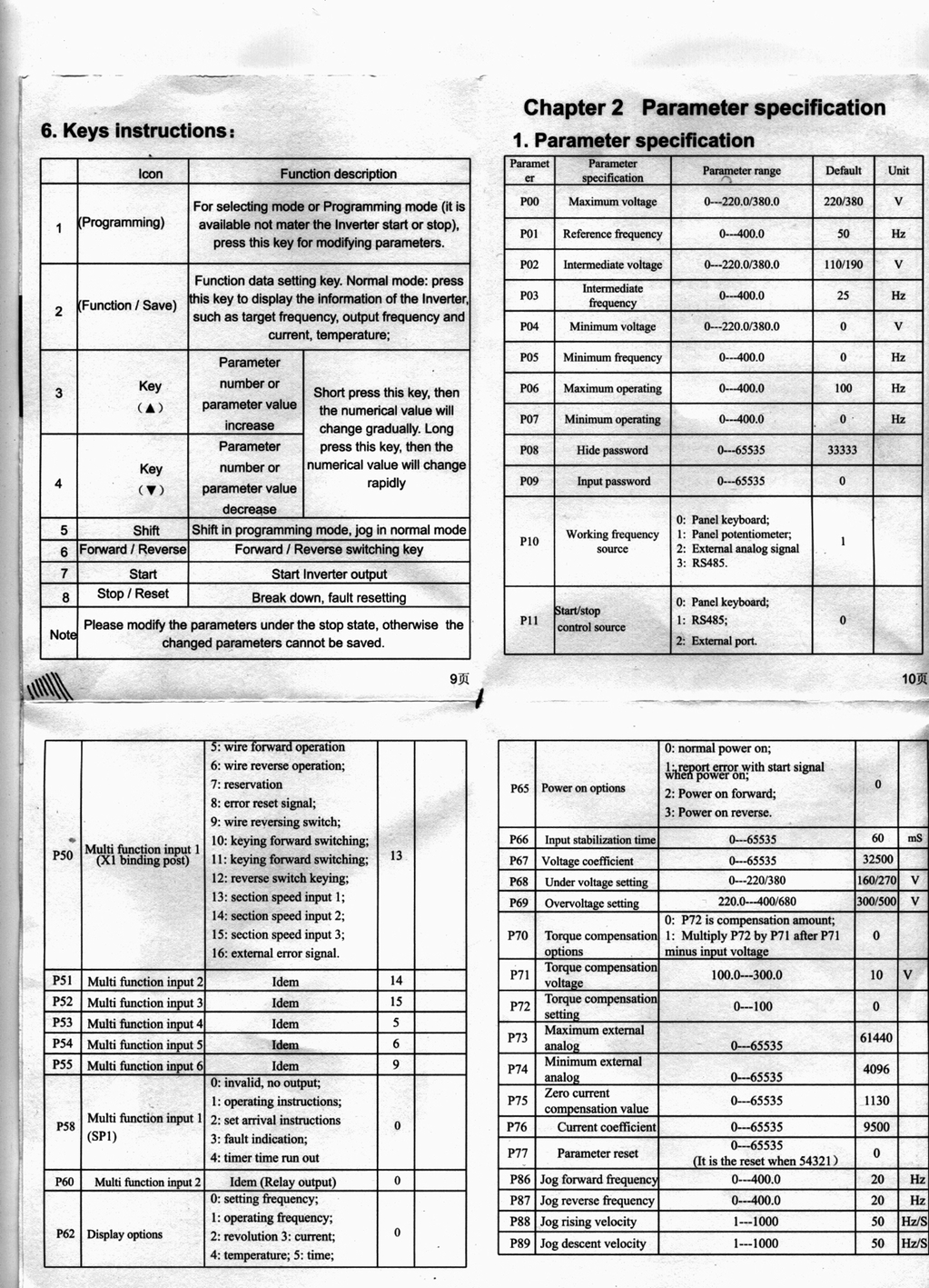

    I have an XSY-AT1 inverter 3pH, i'm setting it up for the spindle below and just have a bit of a problem with the terminology in my manual, which differs from much of the documentation I see about the HuanYang, which I was using as a reference.
    I'm just trying to get the basics set up, 400khz and min freq 120khz etc. What are the following setting I should input for the perameters below?
    P00 Max voltage
    P01 Reference voltage
    P02 Intermediate voltage
    P03 Intermediate frequency
    P04 Min voltage
    P05 Min Frequency
    P06 Max operating
    P07 Min operating
    2.2kw air cooled spindle
    current 220v
    Current 6a
    Frequency 400htz
    speed 10-24000htz
    2 pole

    Apologies for the silence been in the Cairngorms!
    I bought it because its dimensional height meant it would fit in my control box. It has a manual (of sorts) Here’s a scanned page with some of the key perameters to set.
    If the Huanyang would fit in my control box I would have bought one. Click image for larger version.
